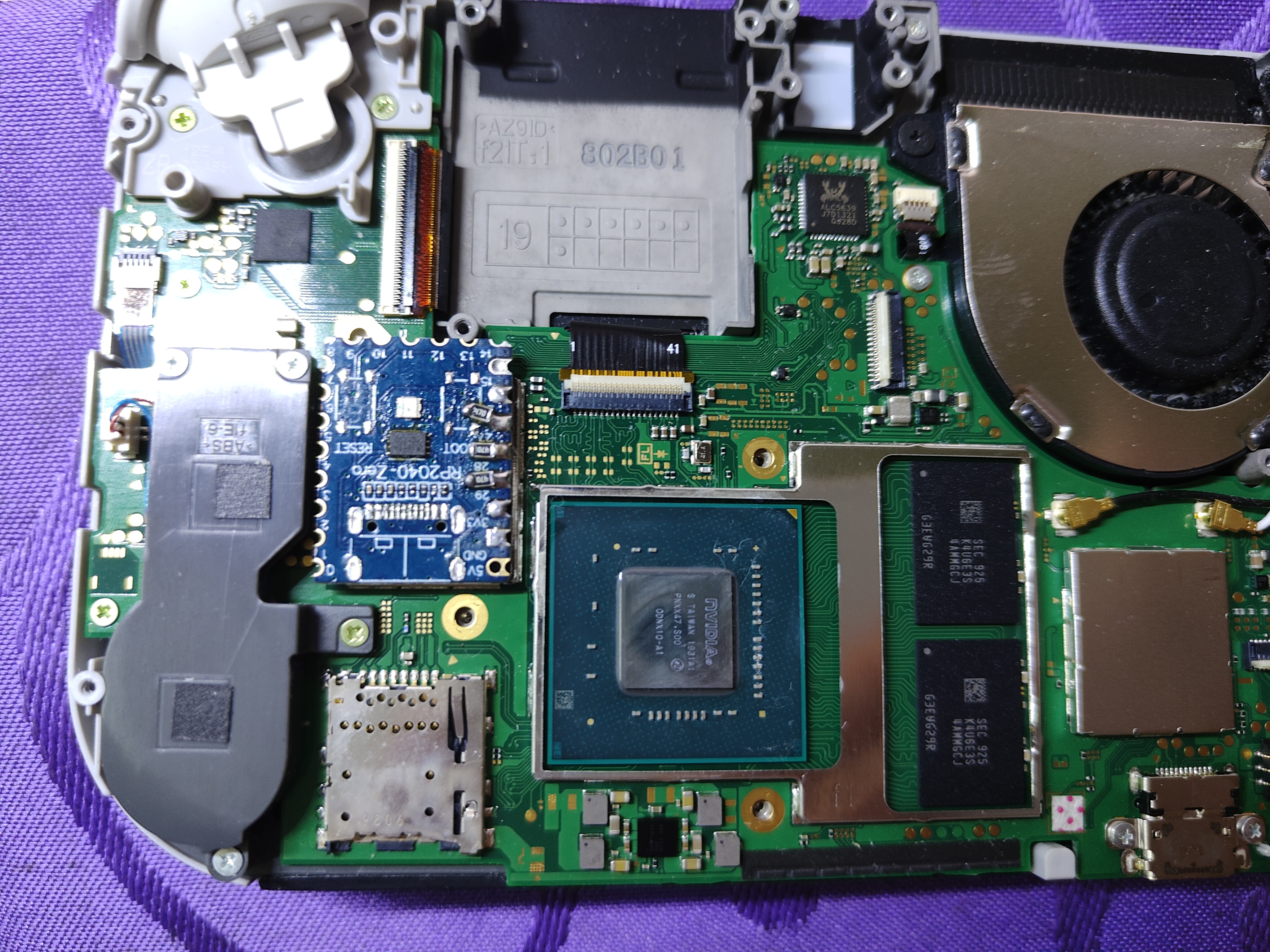

Hi everyone, i am installing on my lite, i just wonder why we put pico on top of mmc, it seem fit quite good, place it ontop of ram require cut the shield, and i want to keep it intact as much as posible. Anyone who put in on here can help me with the pinout closest with it? , Pinout on the pdf tut quite far from here. for eg, the 3.3v
