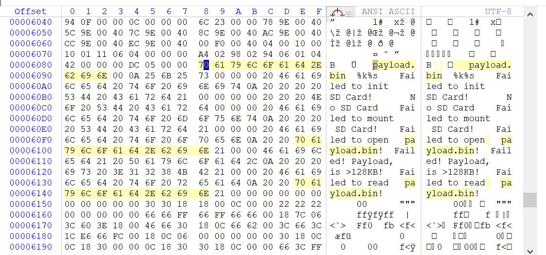

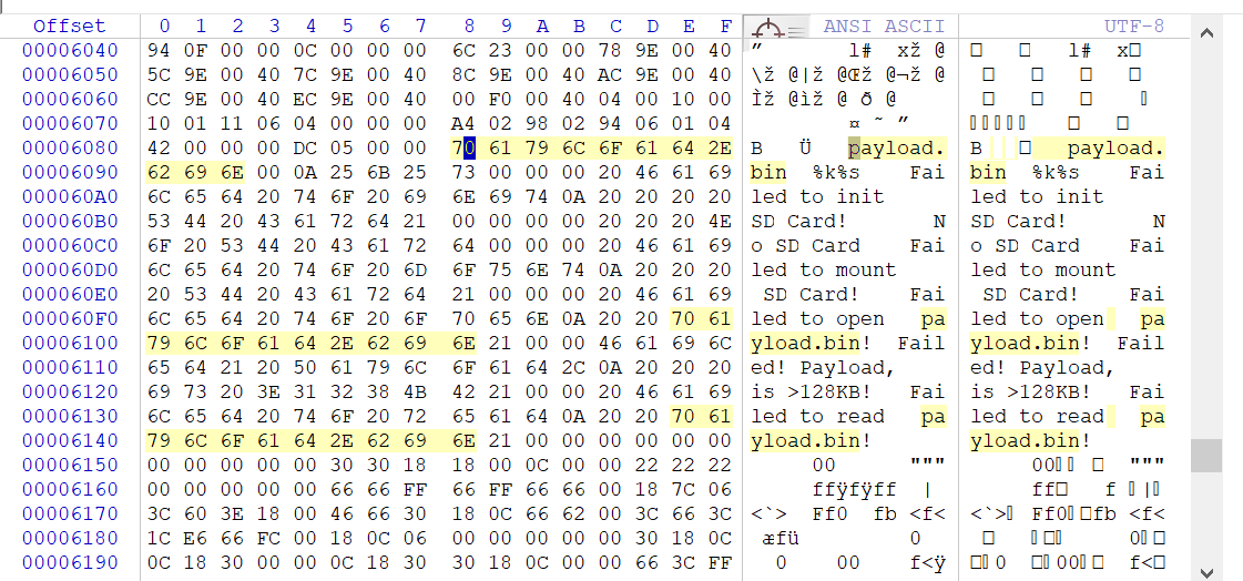

Yes, I also looked into the payload that first loads after the glitching process finishes (I want to change the logo, text font and whatnot), don't think they have source code for it. The payload is provided as a blob in the header file.
Btw, sdloader.enc is the exact same file defined in payload.h. Load it in a hex editor and you'll find out.
