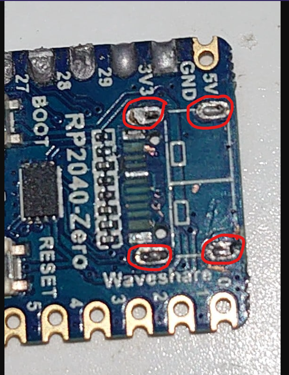

I tried it
can those 4 legs
cutted ?
maybe using nail clipper ??
I tried to cut it but there is very little gap to place a clipper to cut. And You need a plier to cut it because port material is very hard. First heat the upper two joint and which will help you to tilt the port at some angle to put a plier in tu cut it. Cut two upper point and do the same on the below one. That's the technique I used. But after cutting all points, apply some heat to pads which will help the port to fall off.

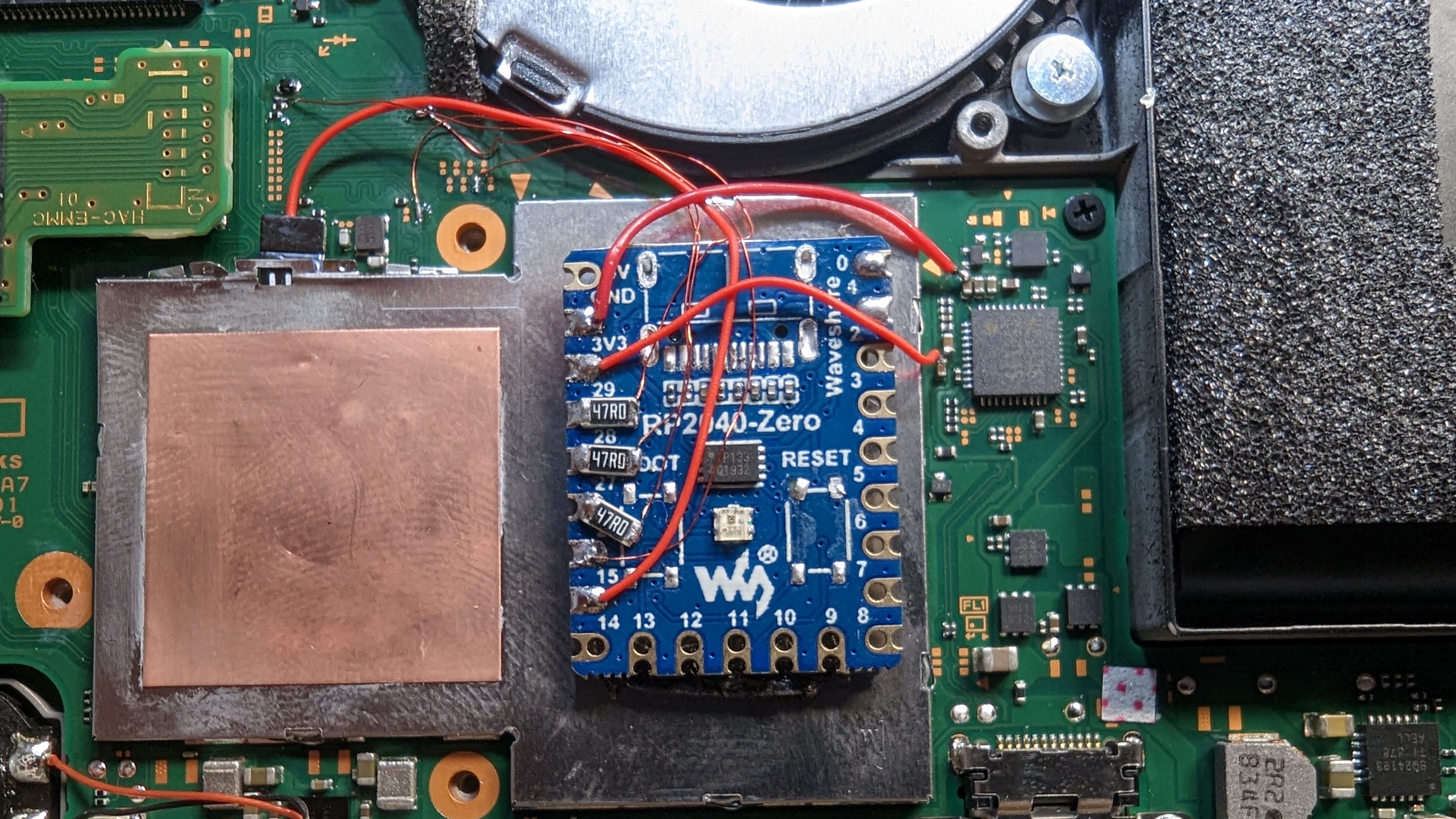

Is it possible that I fried something on board with SMD 4700 Resistors?I made a mistake when ordering them,and bigger mistake soldering them...Removed all the wires and nothing.I got 3.3 on middle of the board when pushing power button,but also got short on capacitor down from APU (Switch ver.2).Capacitors near the battery are ok.

Make a better Install with shorter Lines. My Installation runs without Problems.

I know what 2 short pulses mean, but I measured the point on the board directly and on the chip after connecting the cable and they measure the same, that means that the point is fine, the problem is another
Then why is reset not connected? Looks like you're missing a resistor around there too...
the reset point is not disconnected, measured with the multimeter point 26 of the chip measures the same as on the board. As far as I know on the chip, only resistors are placed at points 27, 28 and 29. I have already made at least a dozen standard switches. I forgot to mention that I have already changed the chip and the same result, tomorrow I will try with the firm 273

I don't care what you "measure", your video looks like it shows that you removed the resistor near RST and then soldered the wire to the pico in its place...
I know what you're saying, it's that some boards come without that resistor, I didn't remove anything

https://gbatemp.net/threads/help-installing-hwfly-v4-on-erista-patched.616720/
here you can see a board equal to mine without resistance
