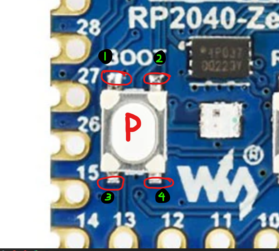

so i manage to remove the button
by manualy soldering
can someone explain to me how the button work ??
when press the button , which number connect ??
you can see from the image i attach ( 1 2 3 4)
if someday i change to 2 pin leg button (the default rp2040 has 4 pin leg)
is it gonna work ???

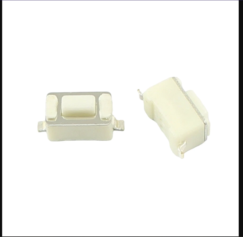

2 leg pin
if someday i use this 2 leg pin, which number i need to solder ? ( 1 2 3 4 )

2 leg pin
By my experience 3+4 with twezzers

1&3 and 2&4 are bridge together(continuity), also 1&3 are ground, so you can do you combination 1+2 or 3+4 or either 2 or 4 to anywhere ground.

1=3 on/off 2=4
