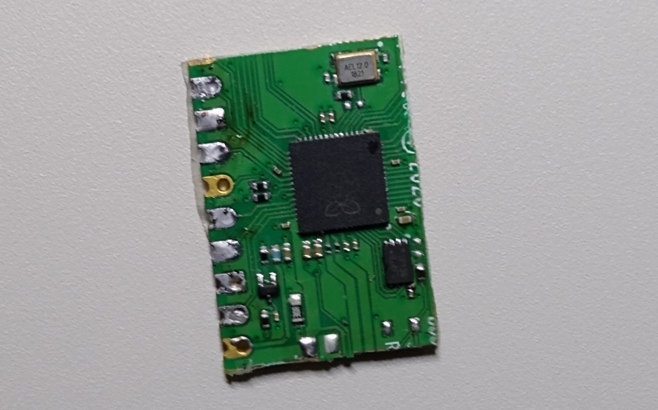

I have not yet received an answer about installing a raspberry pi pico. photo more cutting or putting the wires
If you are not a developer, why do you care about Raspberry Pi Pico?
It is very large and difficult to fit into a switch.
This was the original plan, but it could be I cut something important. More info soon once I find at least two free hours
I've cut my Pi Pico, tried to make it working, but for some reason it didn't work the way it was supposed to. So I'll come there later when I have more time

not recommended for now. no RGB LED, need to cut in half, precise soldering, etc
better to find smaller board with RGB LED like zero, xiao, or itsybitsy
I will try to do the same cut
