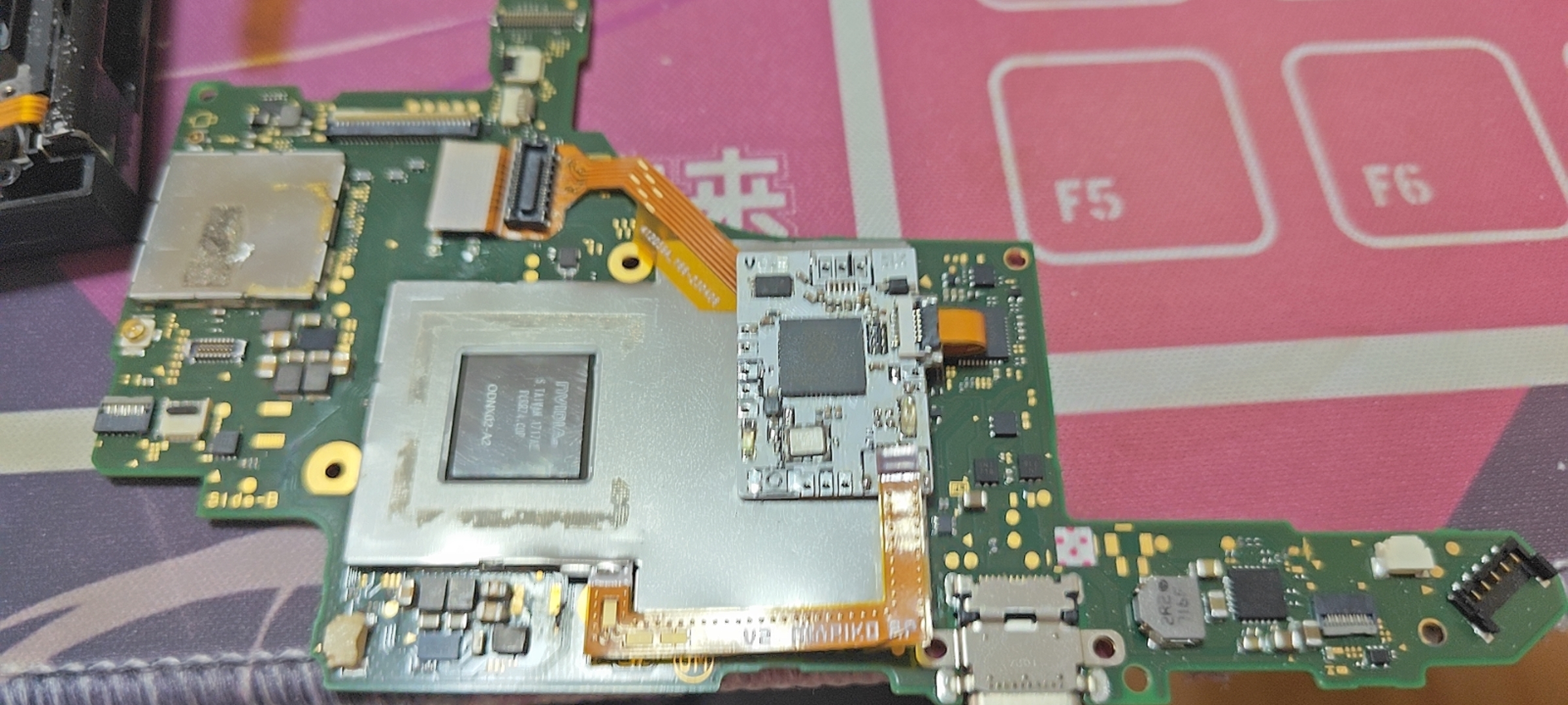

Hello. I have an issue installing it on OLED. All readings are fine, but I get a green then purple color with blackscreen. Please let me know whats wrong
Reactions: impeeza
there can't be green -> purple
however it could be blue -> green -> blue -> purple, which might mean flux around RST point that forces a console reboot after a successful glitch
photos of your soldering may help to find the issue
Reactions: KarimPolska
You're right sorry. I meant blue then purple. Black screen. Uploading pics in min. Could a point be bad even if multimeter gave a good reading?

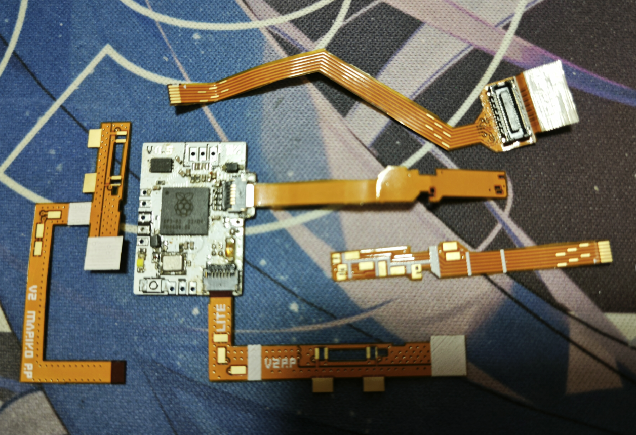

I really appreciate the work on this along with the guide that showed the alternate lite 3.3v location. While I'm waiting on parts to come in from aliexpress I'm working on a pcb design. If it works out I'll share it. Here's a rough design of some I have enroute. Any ideas or feedback is welcome
MOSFET power traces (GND / APU VCC) must be as wide as possible, look at the flat cables schematics / boardview. the less resistance they have the better glitching is applied.
current there can reach 40 A in pulse
Thanks, I'll make some revisions which increase the trace size to .75mm to compensate

Okey will do. But now my OLED won't turn on even after removing Picoflly. I kept the wire and flex cable. But it gives me black screen. Is it dead?
