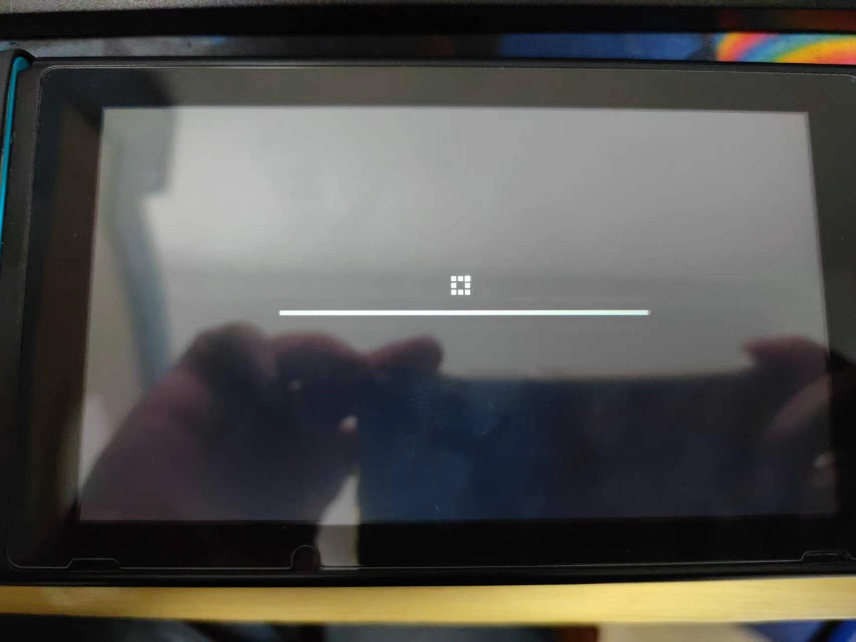

also hangs after nintendo screen.

works fine on 2.5_nw_toshiba_fix
but 2.6a and 2.61hangs after nintendo logo everytime on boot ofw (just pressing vol+/- on no sd screen, and also in hekate reboot, ofw)
My V1 patch also has this issue in fw2.61 and keeps displaying this screen. I haven't tried any other FW versions.

try flashing 2.5toshibe i guess u also ahve a toshiba emmc?
The RP2040 ZERO USB port has been removed and the chip can enter CFW/OFW. It does not affect the use, only reflects the problem.
there her people with the same problem on 2.6
after flashib 2.5 toshiba solved the issue
