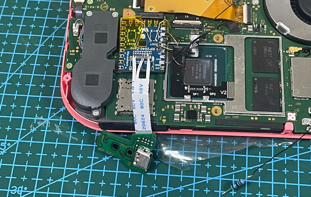

I'd like to thank everyone for leading me into a false sense of hope posting blown up pics of components and me think "AHH they don't look to small, I might be alright soldering this myself"
Everything's bloody tiny! 😂
Hopefully the resistors are the correct ones
seems they are correct:

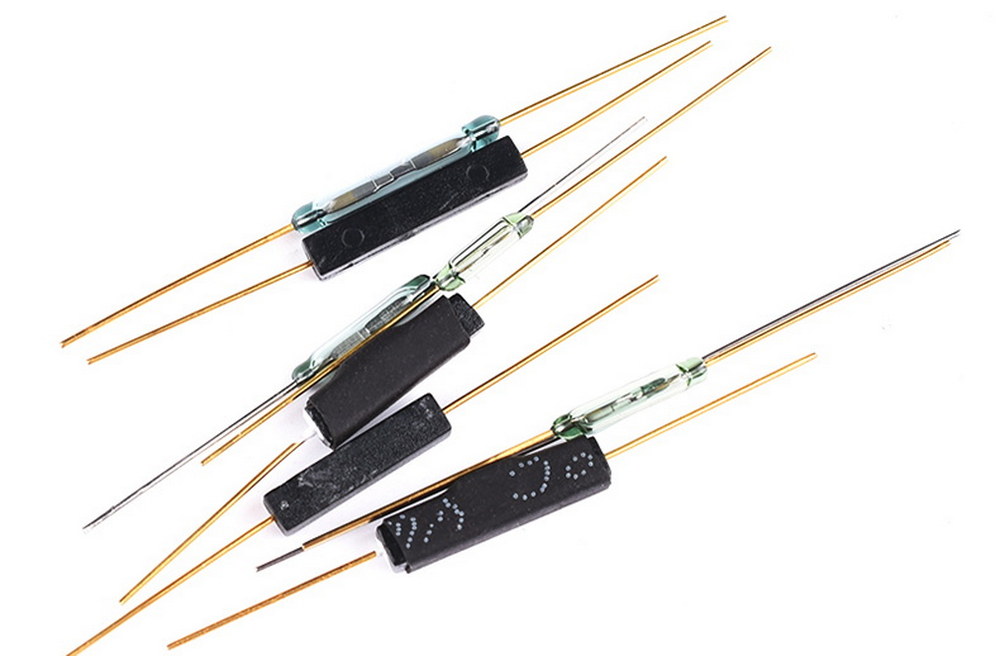

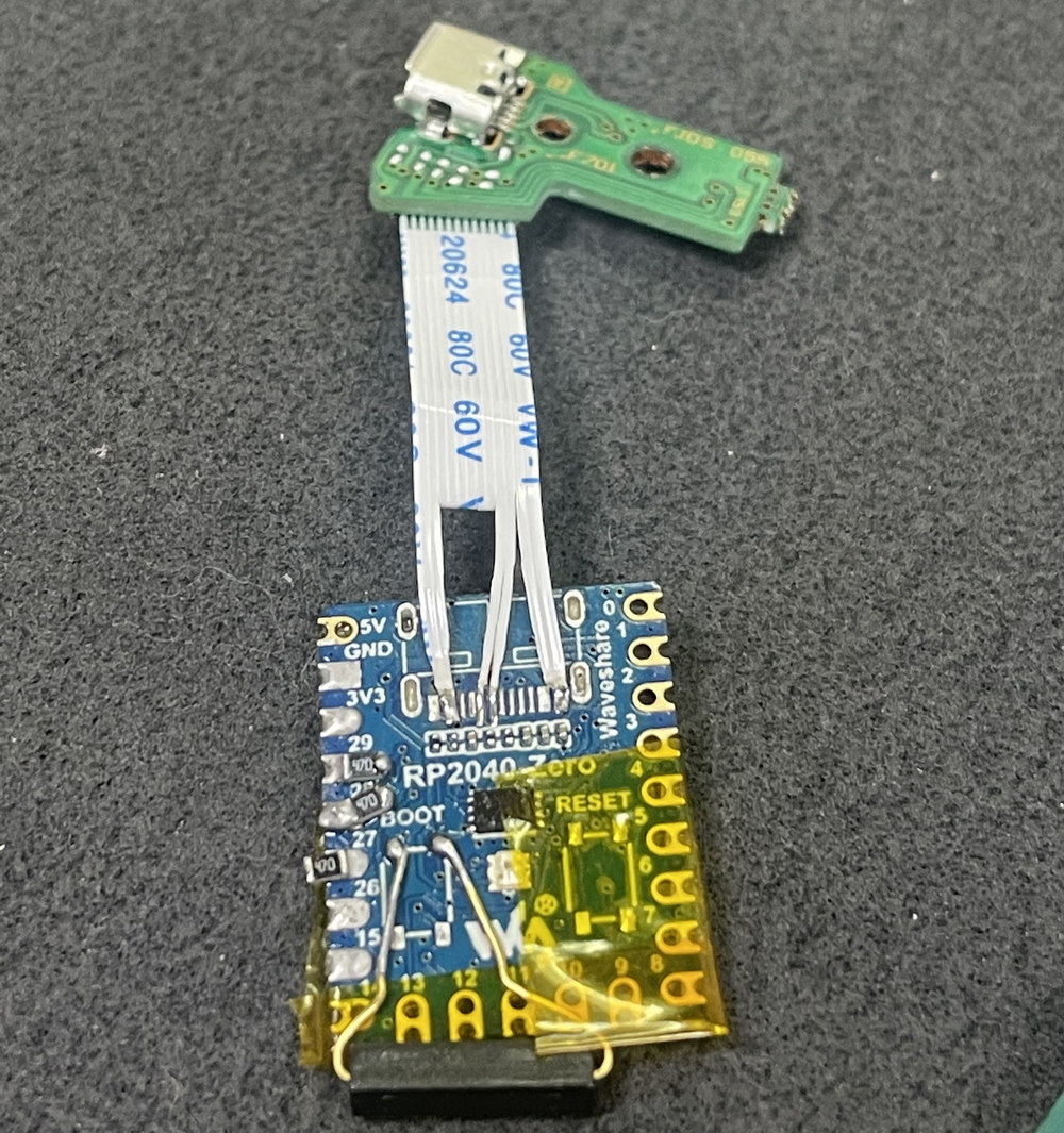

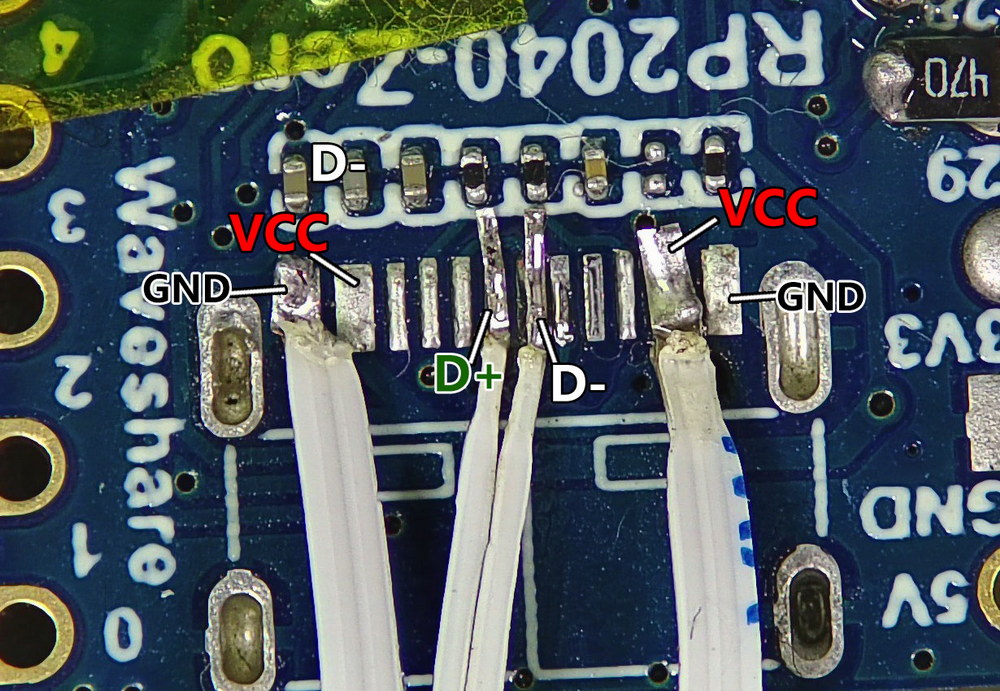

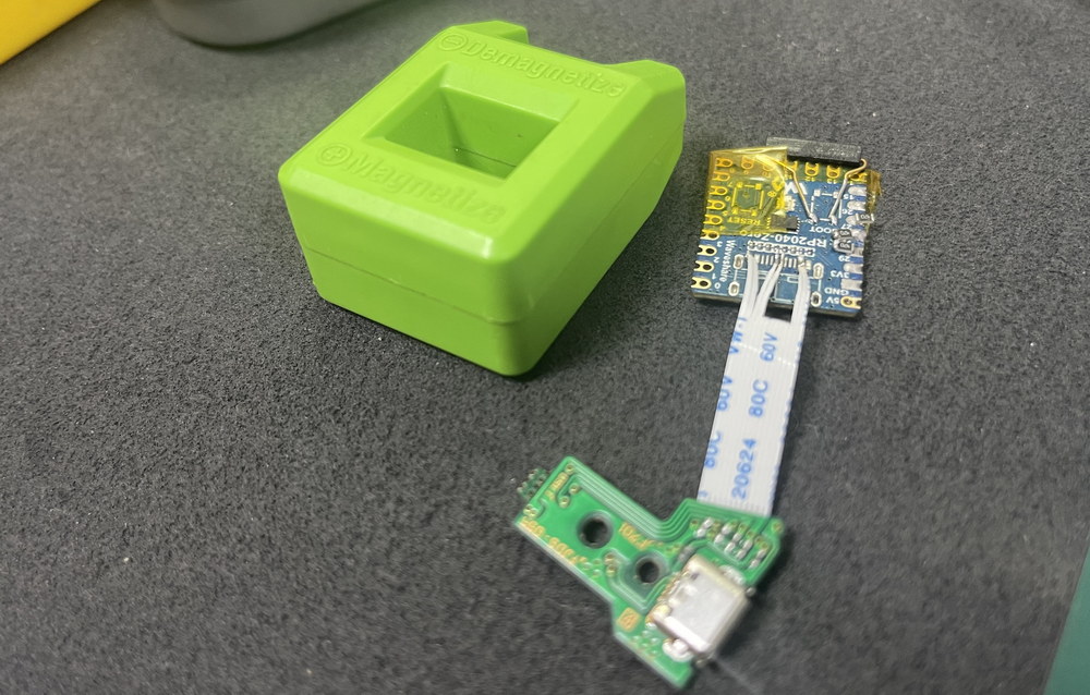

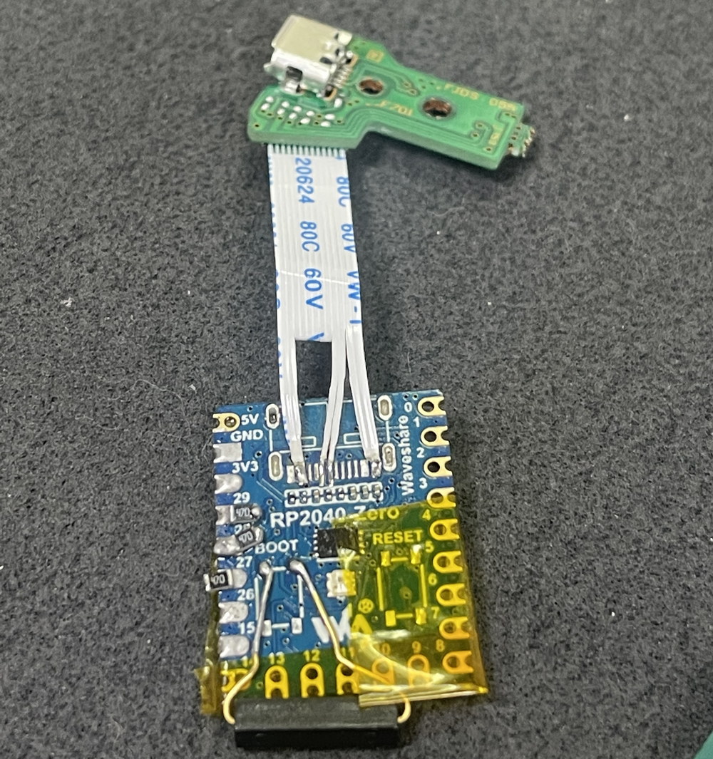

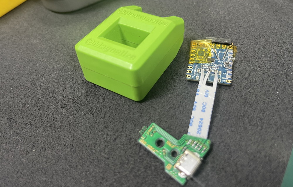

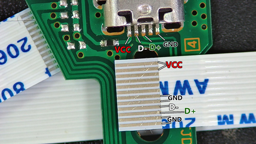

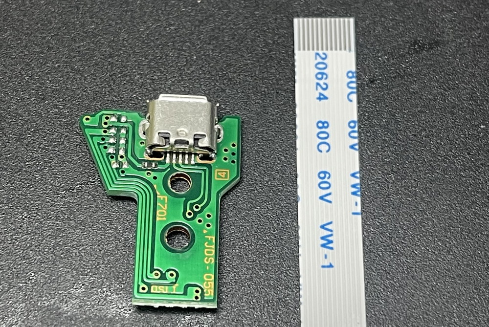

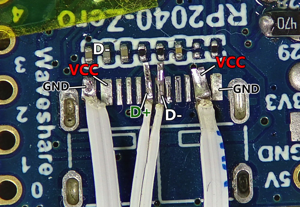

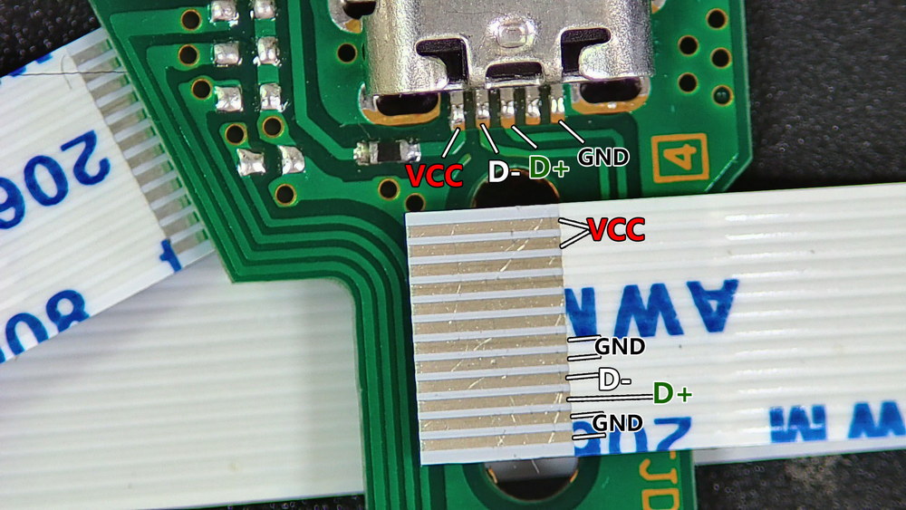

My solution for a normal firmware upgrade, checklist: the USB port of the PS4 controller plus a matching cable, a magnetic reed switch, and let's get started!

Hey guys, long time lurker first time poster. Finally did the mod, it glitches and boots Hekate fine. Using 51ohm resistors because I read somewhere that Toshiba eMMC's prefer a higher resistance. I ran the picofly unlocker payload and all that and it said it flashed successfully.
Anyways, I get this error anytime I try to boot Stock or EmuMMC. I'm also seeing that my secure boot key is all F's and my Cal0 is corrut.
I love the same thing also happened to me with Toshiba nand I installed the rp2040 resistors with the unlocking and it gave me that same error without counting that it does not let you extract the keys and when it happened to the original console it gave this error

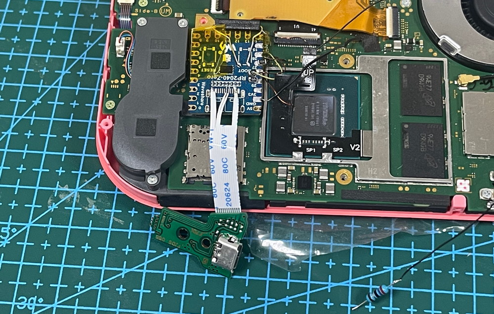

MOSFET finally arrived. Flying install for testing.. first boot gave me blue, cyan, off. Second boot flashed blue for a little while, then booted to OFW.. every boot since gives me a green light within a second and boots to Hekate. Awesome!
This is a patched Erista that I used to run with Pegascape.
