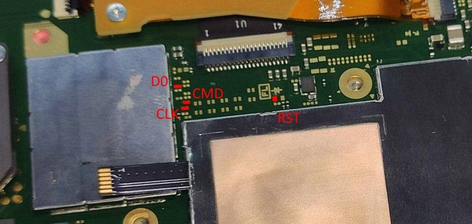

hello, I was finally able to boot the chip, check the soldering and that's it, but now I wanted to test OFW, check that the connection between the points and the pico fly have 47ohm resistance. I don't know what else I could check pkg1 decryption failed bek is missing
help i'm really desperate :(

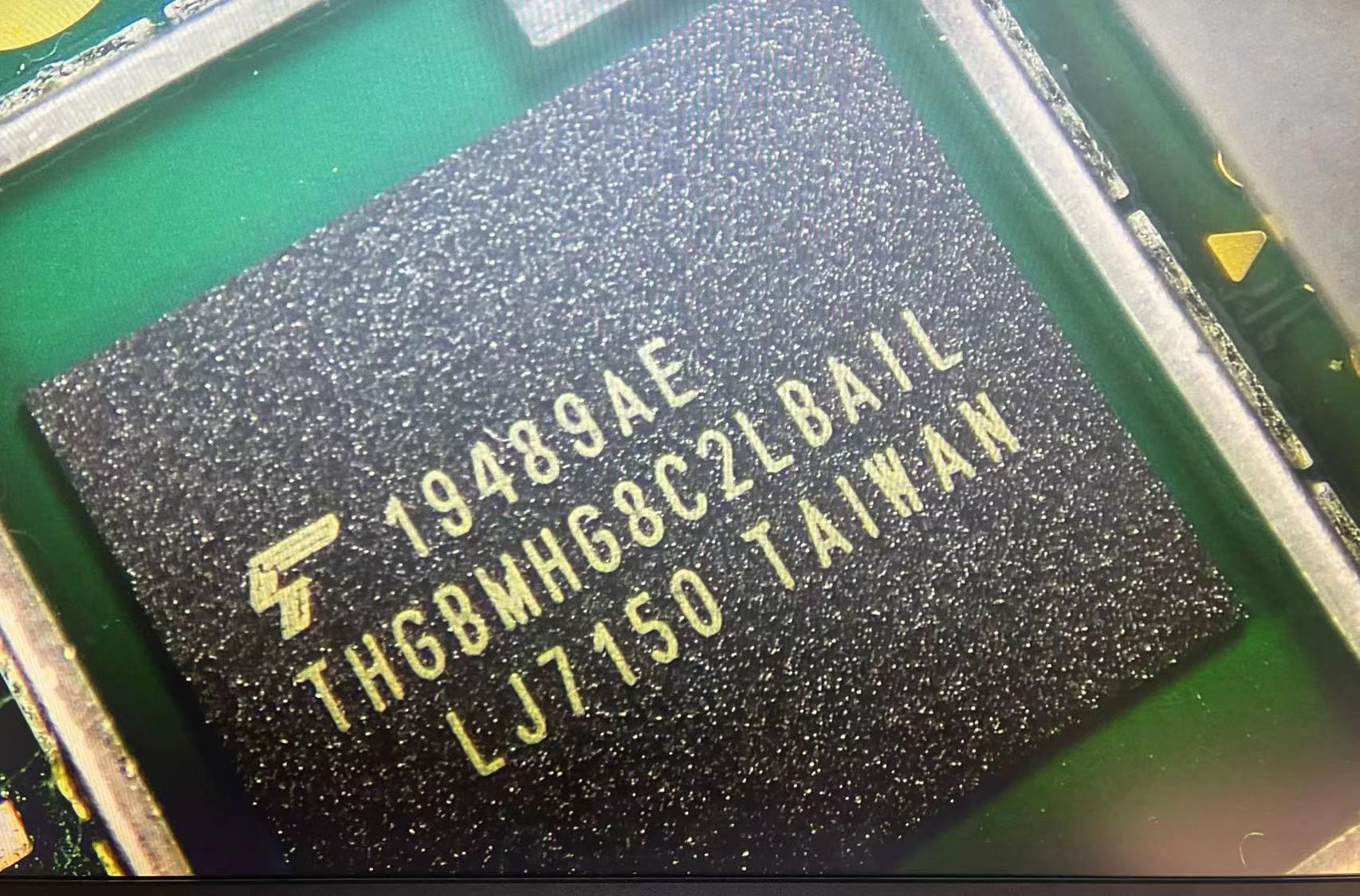

I love the same thing also happened to me with Toshiba nand I installed the rp2040 resistors with the unlocking and it gave me that same error without counting that it does not let you extract the keys and when it happened to the original console it gave this error
Let me know if you figure it out. I'm trying to rebuild my boot0/1 and nand once I have time away from work
