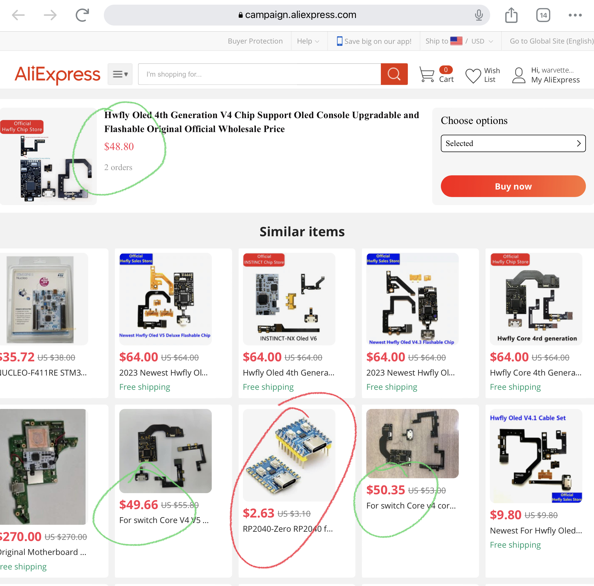

Great but where to buy only the flex ?
Will release soon, stay tuned!

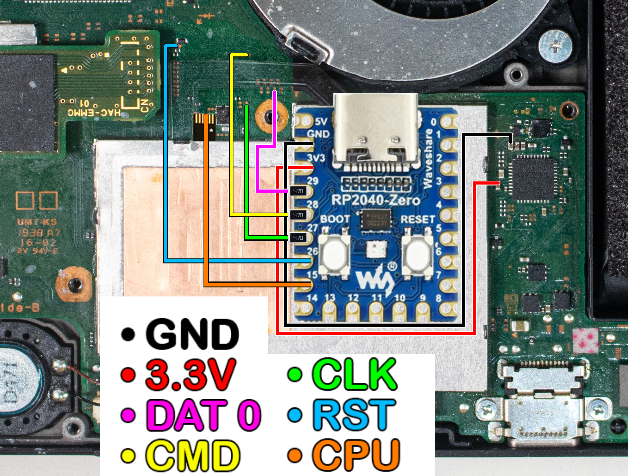

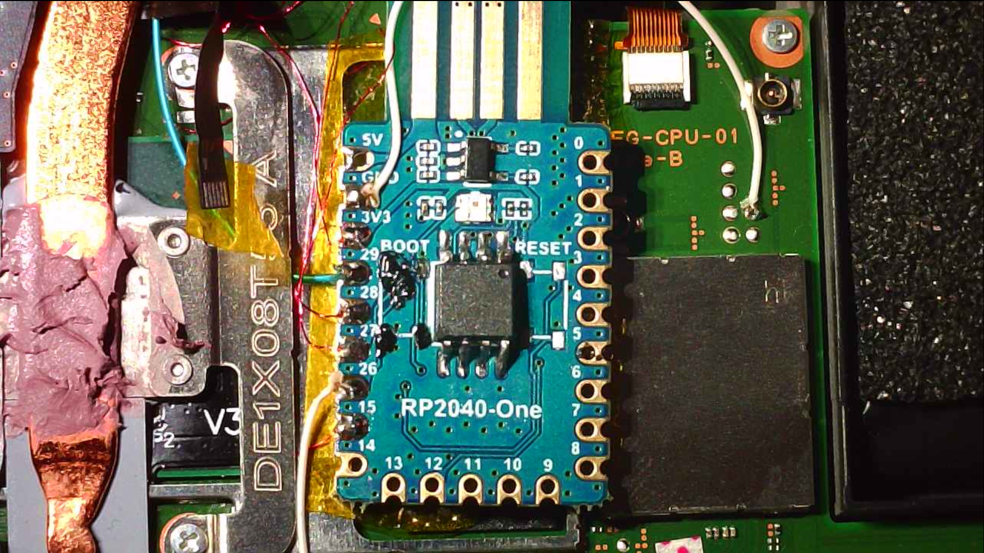

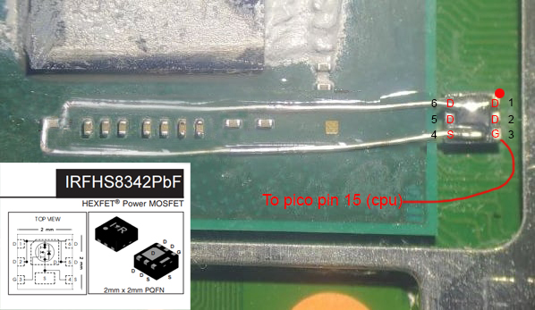

I'm also trying with rpi 2040 one, but I couldn't start, where did you solder the cpu cable to the cpu flex? Could you please provide me with an image. I am also interested in having android in my oled, any link to add android please
