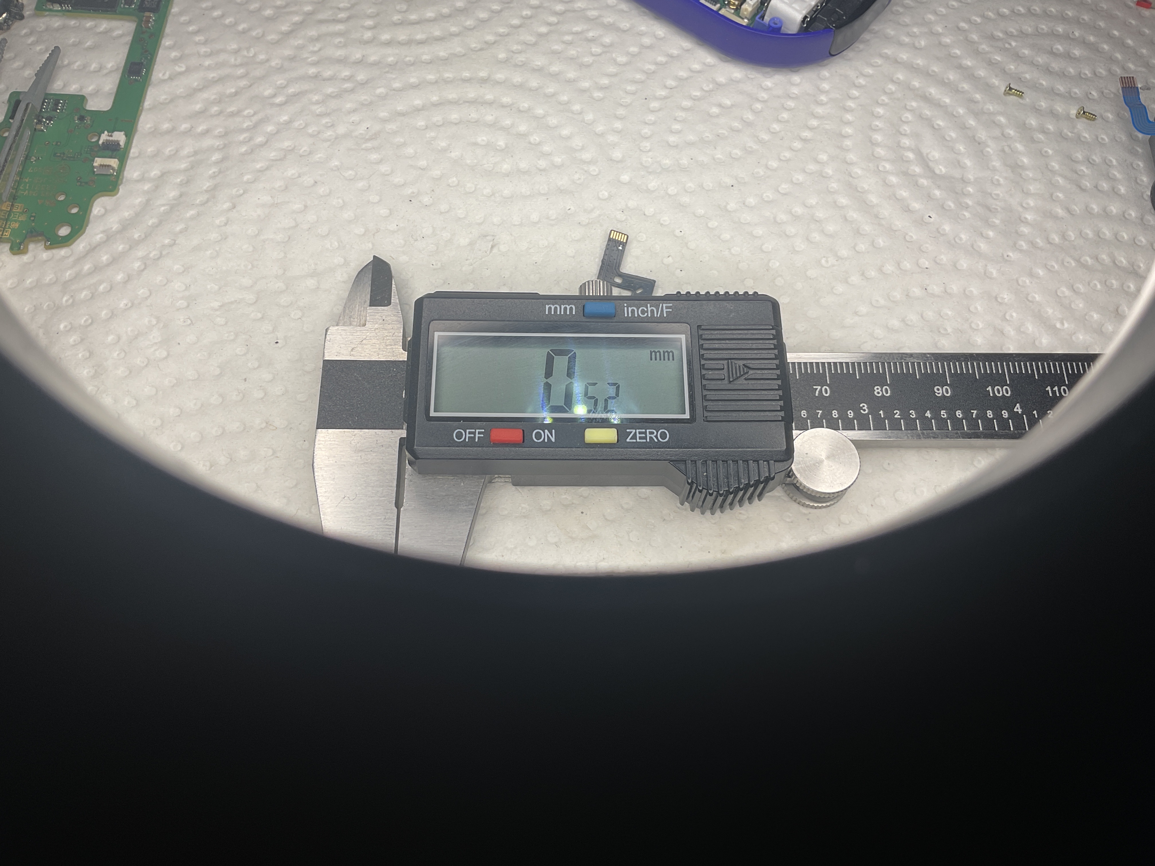

If someone can get me the pitch of the flex connector on hwfly cpu flex that would be really helpful. I already found pinout but my pcb software wont open the altium format files i found.
