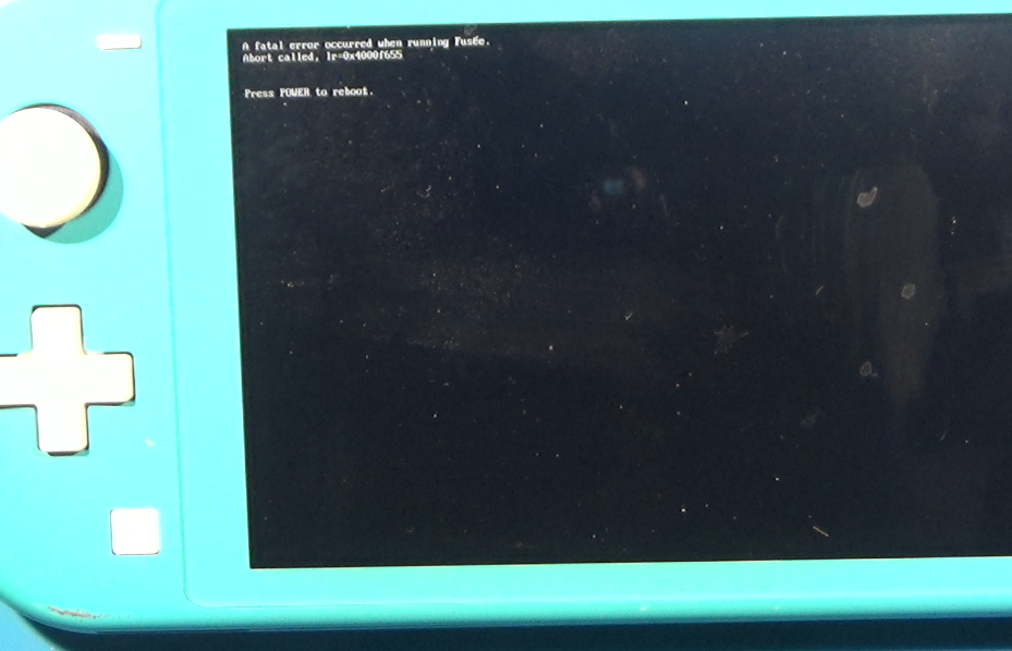

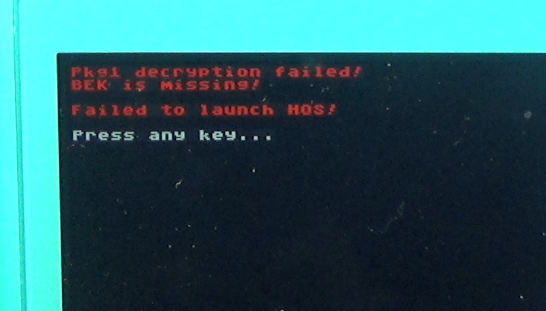

I'm having a hard time getting HOS working on a kiosk unit. Not sure if I'm an idiot with the custom kiosk atmosphere or if it's an issue with the pi firmware.
- Flashed 2.5+unlock
- 47ohm resistors on dat0, cmd, clk
- glitched quickly.
when launching fusee.bin from hekate I get these errors
From hekate launch I get this
If anyone has a known working sd config that should work on a kiosk unit please zip it up and dm it over if possible. There's a good chance that I'm just goofing up on the software end.
Not sure if you know, but kiosk need a special version of atmosphere if you have the correct pi firmware.

I didn't catch the part where I needed to unlock it lol. Got it sorted.
