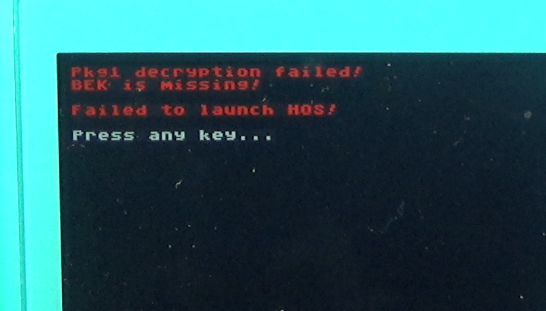

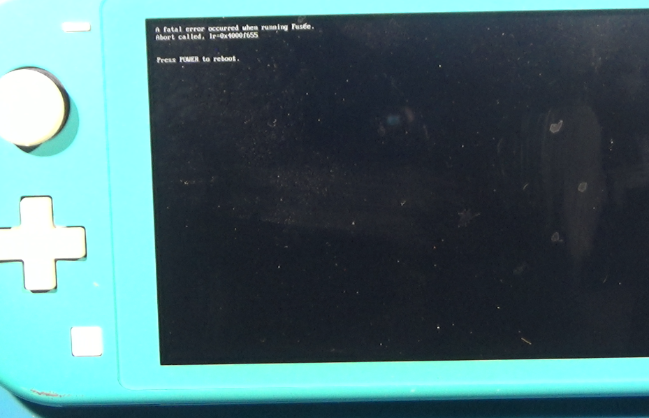

I'm having a hard time getting HOS working on a kiosk unit. Not sure if I'm an idiot with the custom kiosk atmosphere or if it's an issue with the pi firmware.
- Flashed 2.5+unlock
- 47ohm resistors on dat0, cmd, clk
- glitched quickly.
when launching fusee.bin from hekate I get these errors
From hekate launch I get this
If anyone has a known working sd config that should work on a kiosk unit please zip it up and dm it over if possible. There's a good chance that I'm just goofing up on the software end.

you have not unlocked the firmware, use unlock.uf2 or toolbox hekate payload + unlock.bin

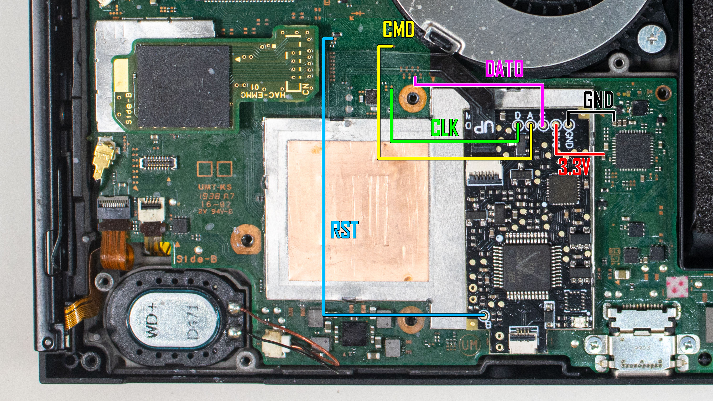

How could you easily program it?
You will need to hook wires up to VB, GND, U+ and U-. Make sure that the 5v only goes to VB on PGA2040, if it ends up elsewhere it will result in a bad time. A USB breakout board is a convenient way of getting at the wires in your USB cable

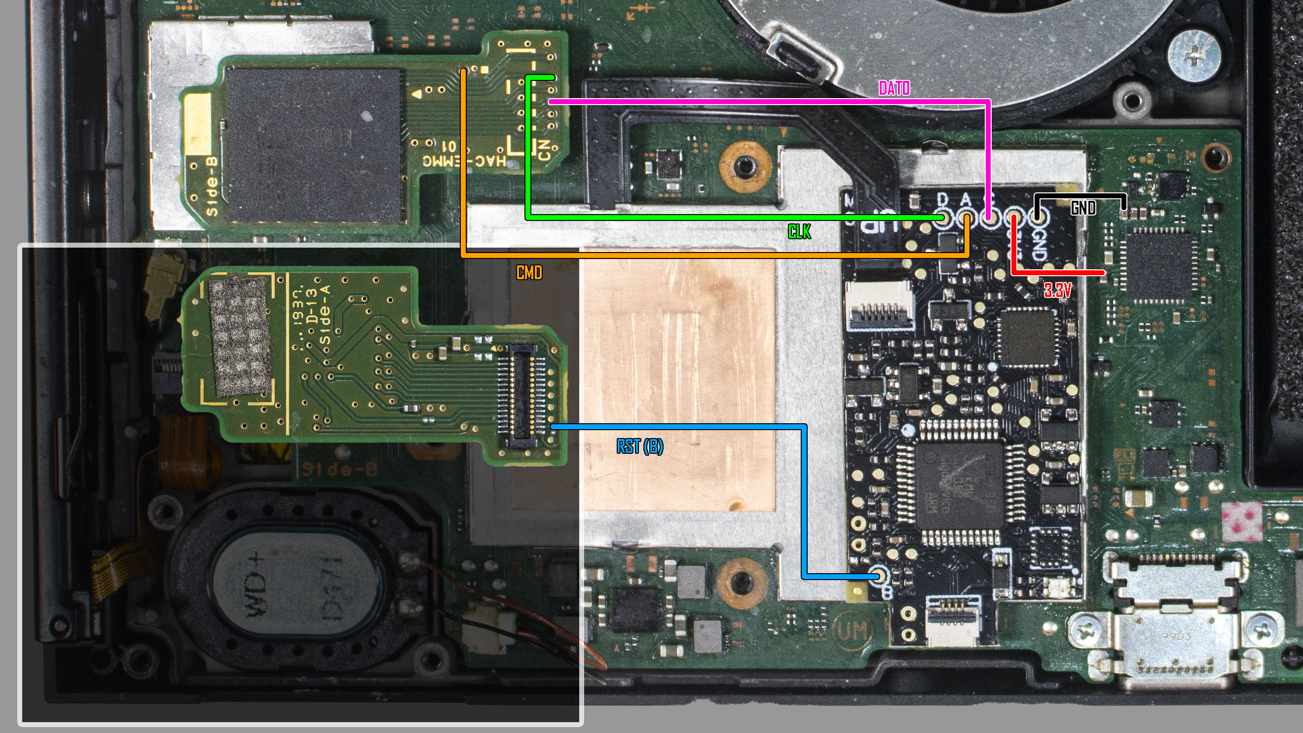

What is the general consensus on DAT0 adapters? Is a friction connection durable enough, or is reflowing a must?
Best would be to reball the eMMC with leaded solder and use a wire for DAT0 between the board via and the eMMC chip or the fancy HWFLY sandwitch green PCB (needs double reball).
Based on sthetix's comments, the reflow with different solder type (low melt or other) seem not to hold for long time due to solder cracking under high heat (dock use, hot environment, etc) and friction method should work ok.
My 2 cents are: if you can, reball and forget about it.
