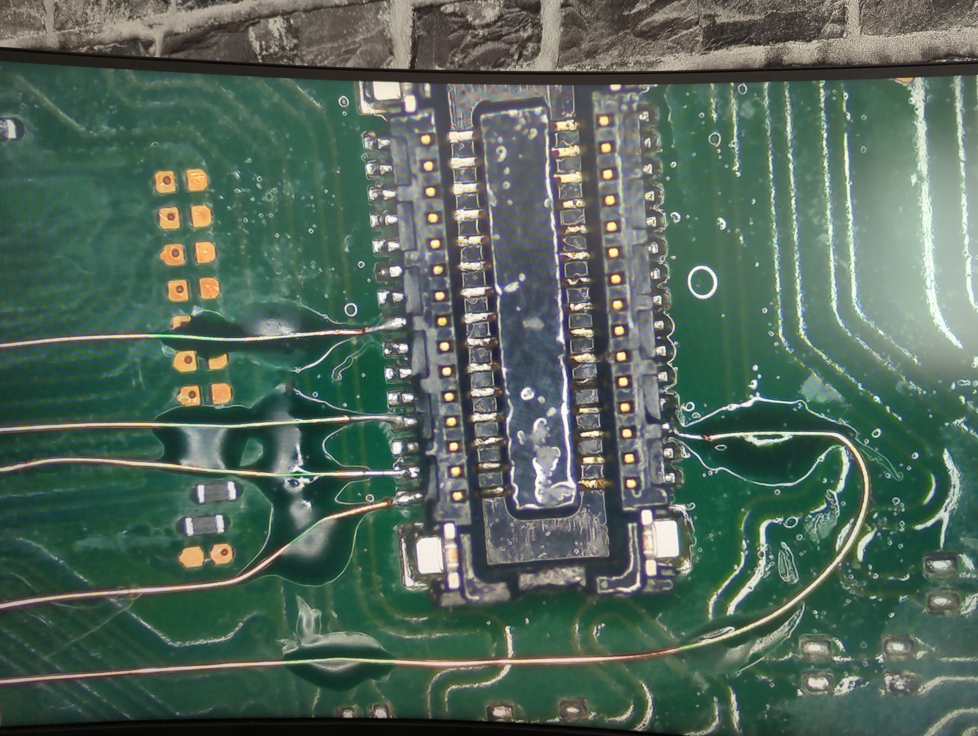

instead of soldering everything to the emmc chip itself i decided to solder it to the emmc connector on the board
View attachment 360114View attachment 360115
just playing around with some donor boards what solution should i use ?

the second one looks cleaner. don't forget to apply green mask on the square pad right under the wire, it's GND
yes, I used the same way. can replace memory much faster
