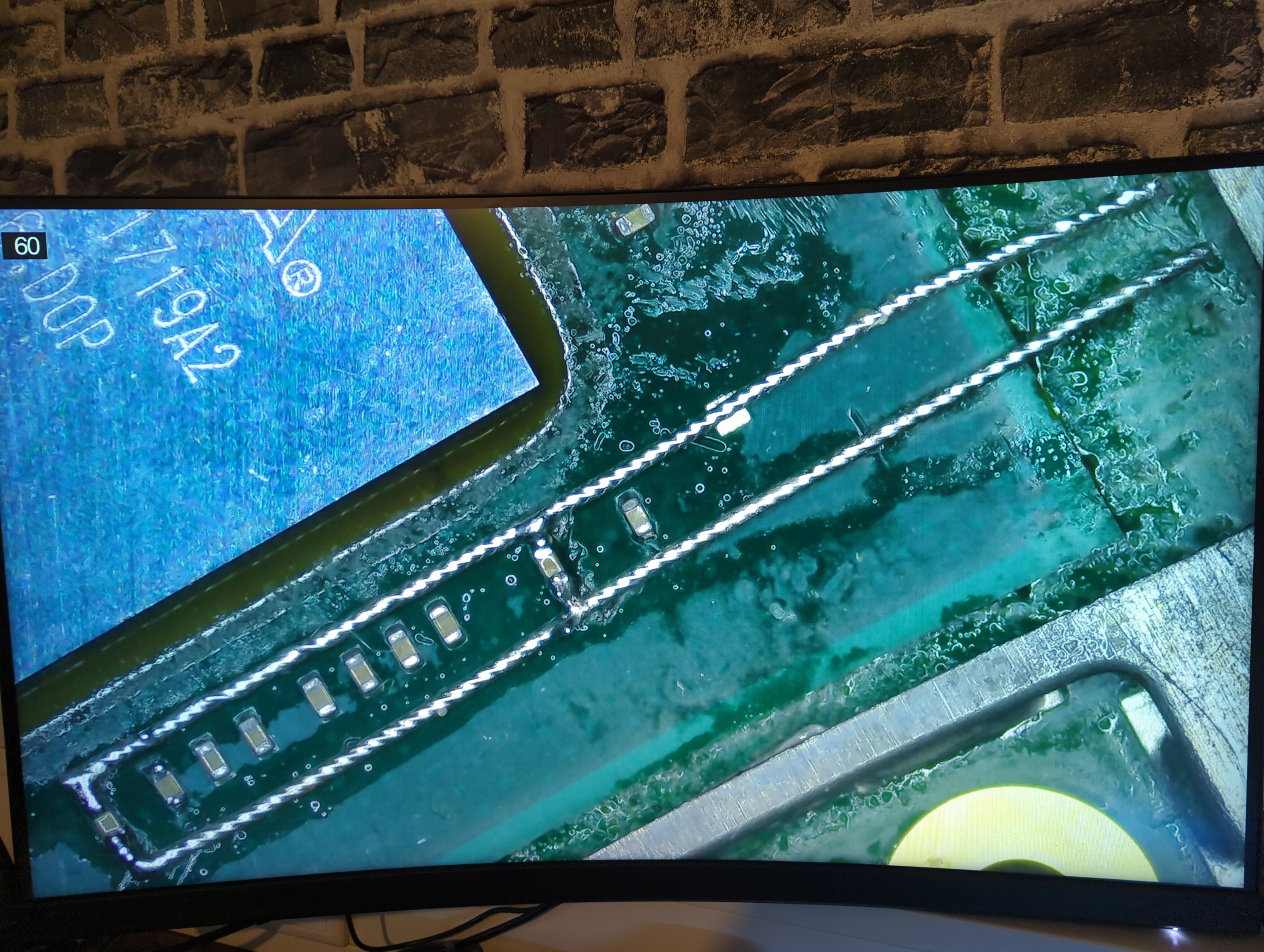

View attachment 360114View attachment 360115
just playing around with some donor boards what solution should i use ?
yeah thats true bulk is the way to go....
still gonna try and create a pcb and then ill check on it again and see how much bulk is and maybe just buy bulk and offer them for picofly we will see
never used pcbway only jlcpcb and never had issues with them
