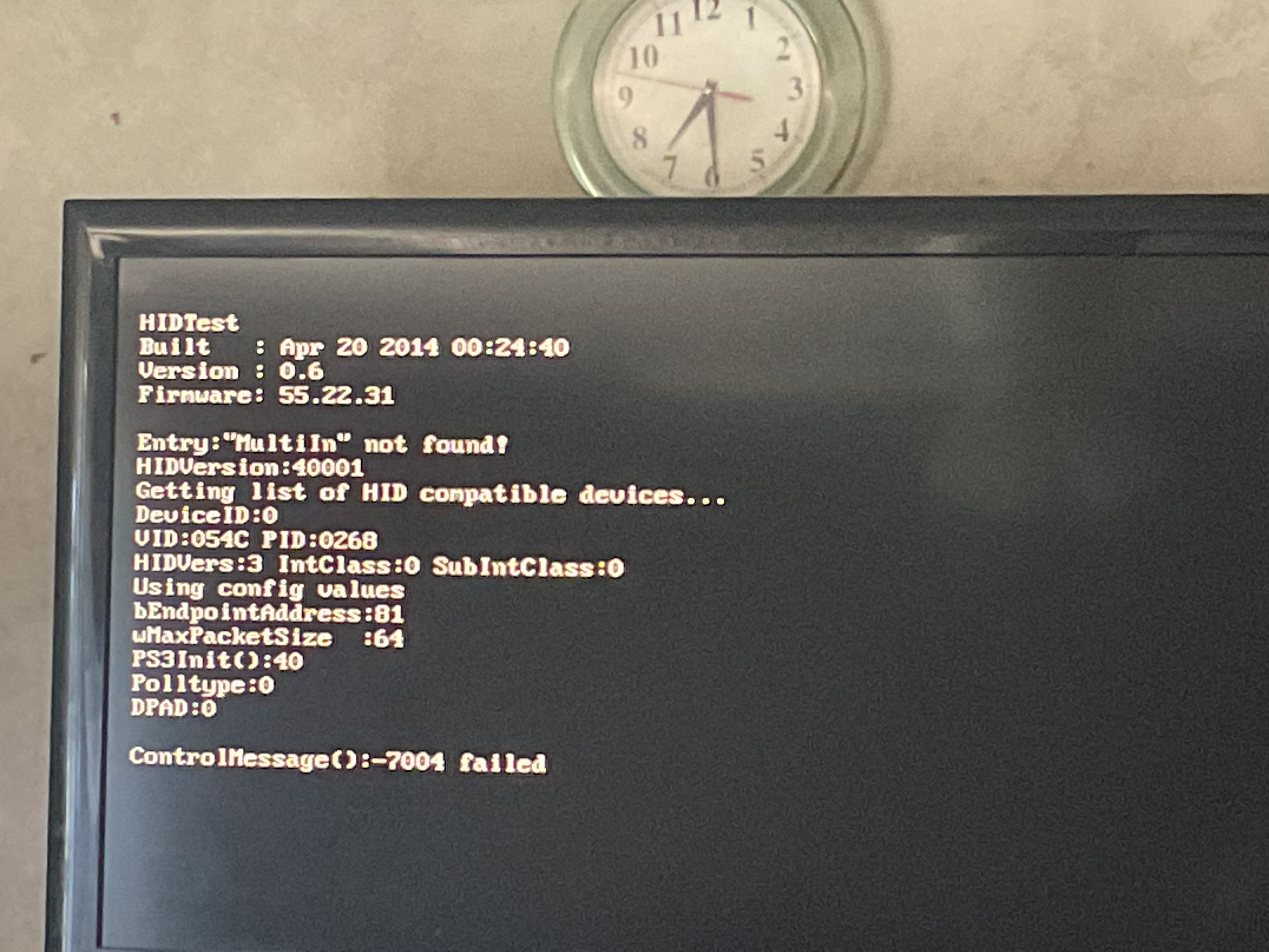

I'm trying to use the following 3rd party wired PS3 controller with Nintendont on a Wii. It doesn't plug and play, am I wasting my time trying to get it working? Can anyone help? (Reddit forbids people needing help!)
USB GAME PAD (Vendor: 11c0 Product: 5503)
if no one made an ini for that controller then you would need to make one for yourself, since it doesnt share the pid/vid of the original ps3 then no ini was made.
Can anyone help me with this? Seriously I don’t want to play Luigi’s Mansion with a Wiimote+Nunchuck
edit: still getting the error, but I am still hoping I might get a solution. Also I set MultiIn to 1 and the error code filled the entire screen
Never mind I found the issue.
New problem, Nintendont ignores my VID_PID.ini file. Anyon know why?
