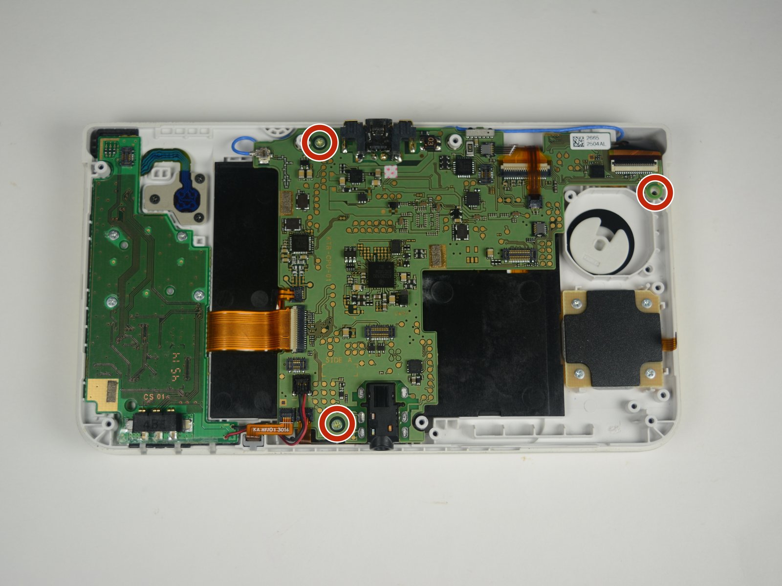

Here's a picture of the n3DS motherboard.

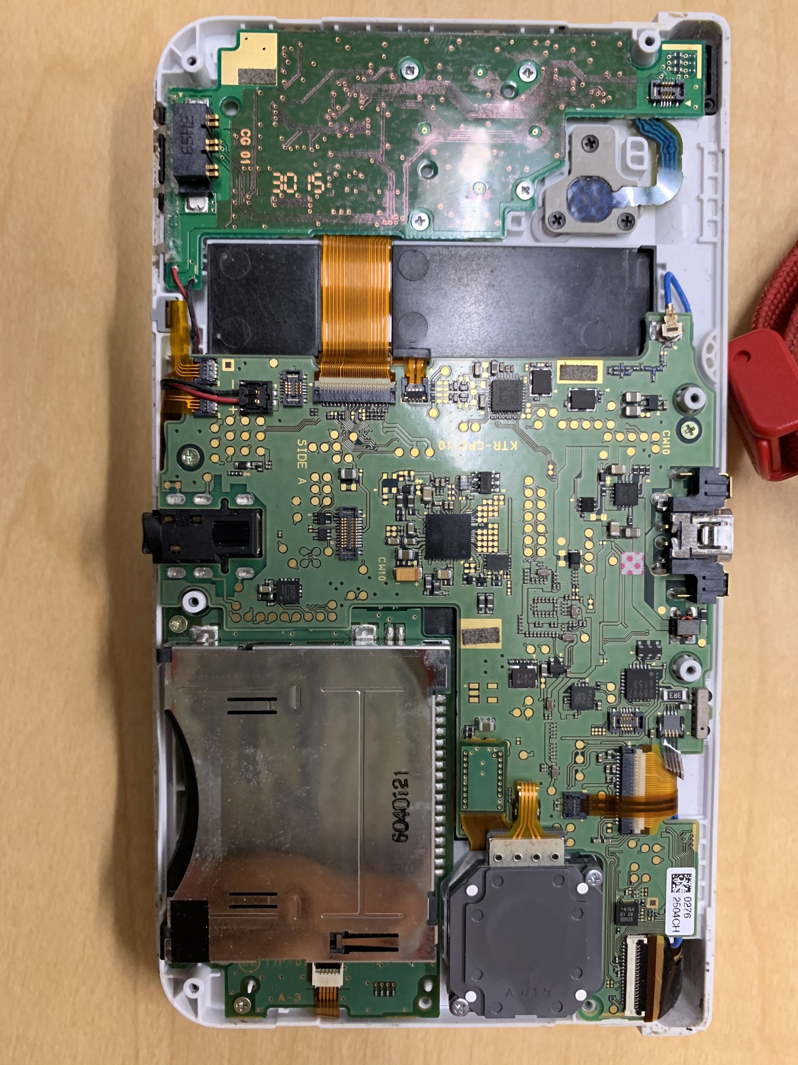

this is what my motherboard looks
The exterior of your motherboard looks perfectly intact when seen by the human eye. However, the type of board damage that was explained earlier (ie, broken solder ball joints) are underneath those black square chips. One would need an x-ray inspect to spot those defects.
