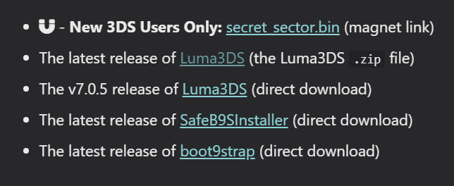

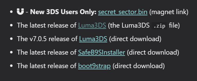

I tried to update following the tutorial in the link but the black screen and the blue LED continue, I already formatted the SD memory and added the files as indicated in the manual but it still does not work, the error of the black screen and blue LED continues.
You can try Luma3ds 7.0.5 that was the last version to support A9LH, you can try to update to B9S from there.
That is the version I use, 7.0.5 to try to update, which is what the manual indicates, but when I press start and power it leaves the screen in black and blue LED
Although you mention to be using 7.0.5, the latest compatible with A9LH, you could try flashing an earlier version (such as 6.6.2) and upgrade from there following the official guide. There is useful information here.
