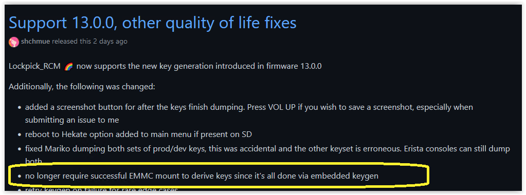

The new version of Lockpick_RCM does not even requires a EMMC to be functional in order to get the keys:
Reactions: Xyphoseos
