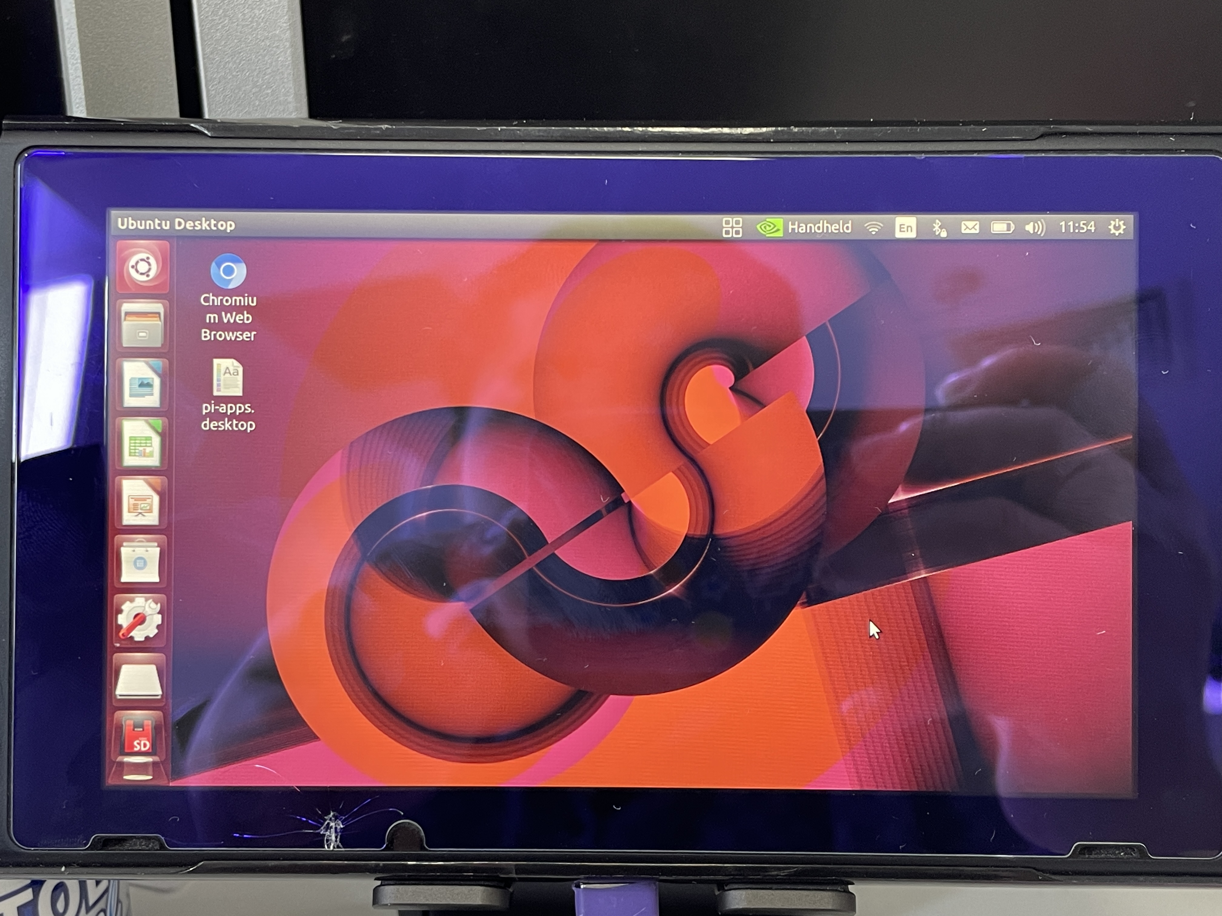

Thanks, Coach. Currently from work to home, I am using my Switch as a mini PC (running L4T ubuntu of switchroot) and handheld gaming machine at the same time. But the limitation of capacity made me swapping sd card all the time (quite annoying for me).
Pls ignore the crack, yesterday night I had a very bad trip with 18+ liquid
The price of bigger sd card compares with the whole process above nearly the same, but whoelse don’t want more fun? :grog:
With this chip in, you certainly won’t need to be swapping anymore.
Not that bad…it’s not in the main viewing area.
