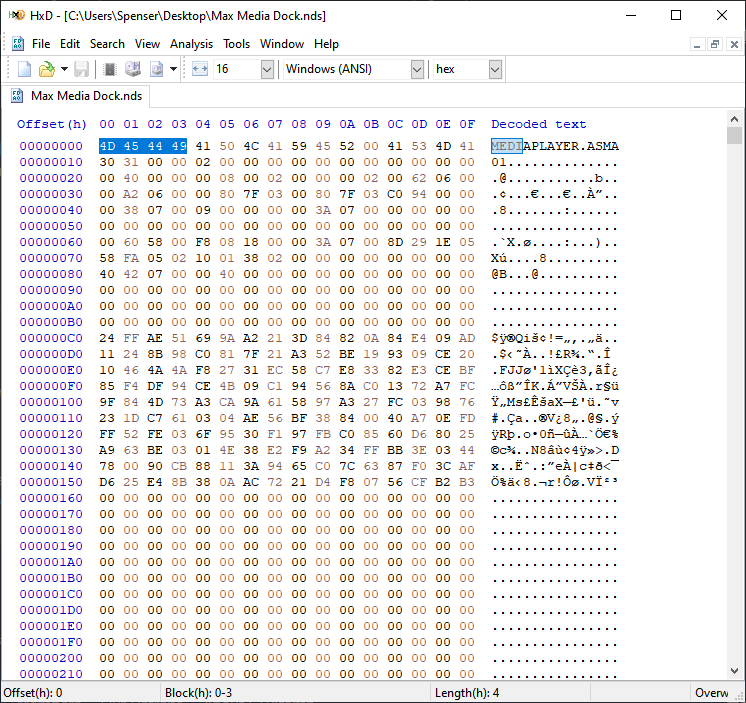

Yeah looks like that would be the case. Since there's nothing in the bootme.nds files/rom dumps that have any flash code I'm not sure how I'd find out what commands to use. :(
I did try enabling the type 2 commands for it but no dice. Still hangs. If the 87 cmd wasn't working me thinks it would have hung at the chip reset/chip id part? I think it uses cmd 87 to obtain those/do chip reset. The dump code would have also died but that seems to work as the dump contains the blowfish data as well as correct NTR secure area data. (EDIT: Seems to be using cmd 0 for read flash so maybe not there. Maybe chip_reset isn't actually happening but surely this would just result in chip ID returning random results which isn't happening here.... )
(tested your 3DS build and it hangs there too)
Anyways cool to see DSOne support seems to work at least. :D
EDIT: Yeah maybe cmd 87 isn't doing anything after all. Checked the rom and guess what matches the chip ID it returns. :P
The chip id displayed in the log is the full u32 and it matches that first u32 value of the rom header so yeah chip ID isn't actually returning the correct data it seems.

It seems to be related to the basic commands of the CPLD or FPGA.
But I don't know anything about this yet, so I'll have to find out the relationship between the commands and the main chip.
