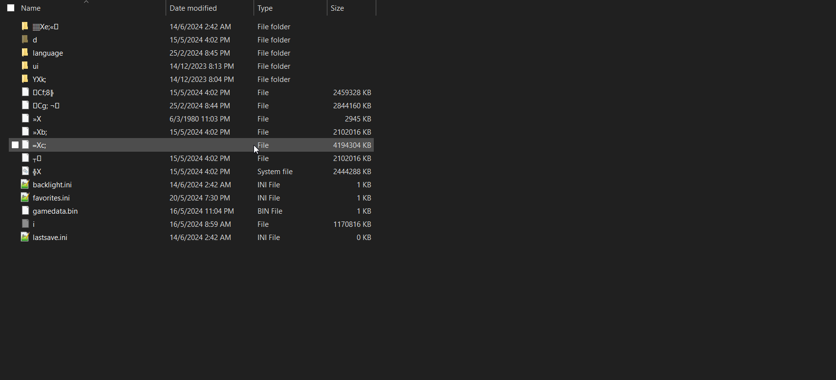

CRITICAL BUG, it seems the kernal does not finish loading after launching the game, so if i launch a new nds game, it says do not turn off power, but after it launches the game, if you turn off the console within 30 seconds, the entire __EZDS folder is corrupted(block level corruption) and the only way to fix it is to completely reformat the memory card, moving back and forth entire game library you had on the sd card.. PLEASE FIX this, it is extremely annoying, either prolong the message of "do not turn off power or do something else.
EDIT: It seems it is fixable by using windows explorers Tools - Check file system for errors(chkdisk) it will fix the corrupted __ezds folder into a file which you can delete and then restore the __ezds folder from the firmware zip, still annoying but at least i don't have to reformat the sd card.
something similar happened to me awhile back while using game yob, it worked fine for awhile until suddenly crashing,
assuming there was a mistake on my end in terms of the rom hack i was playing i booted it backup only for the emulator to crash again via just opening the emulator and selecting the rom directory, when opening the rom directory in file explorer, sure enough the entire thing was corrupted and i found out it wasn't the rom hack by booting it up onto my 3DS via TWLM++ and using gameyob there.
