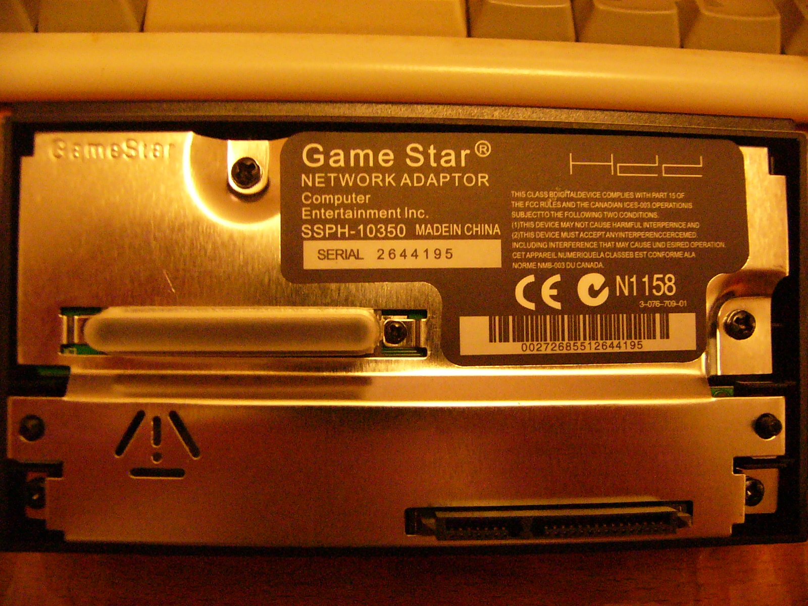

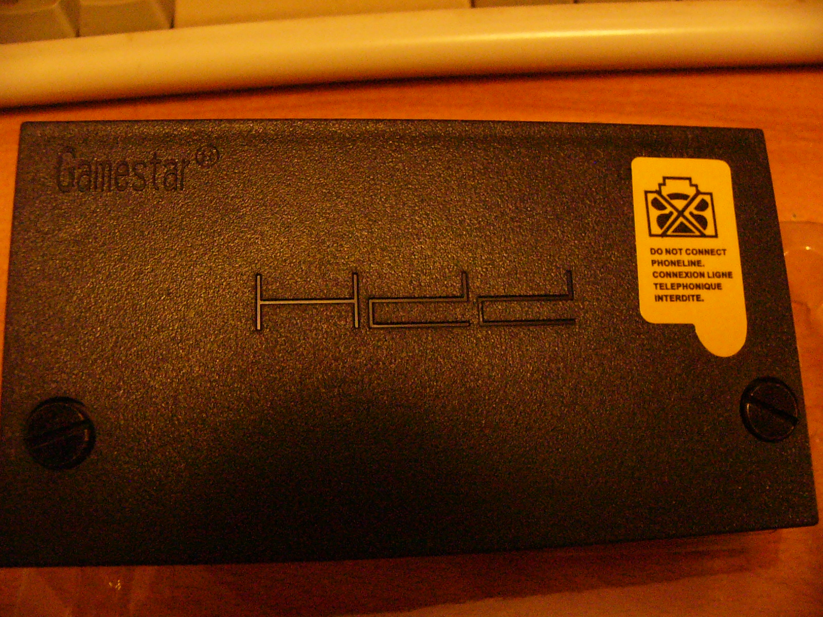

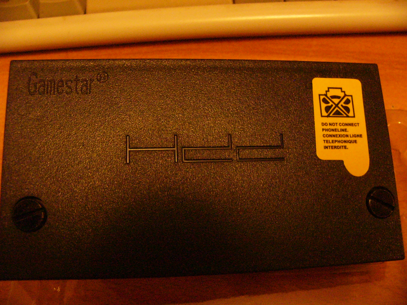

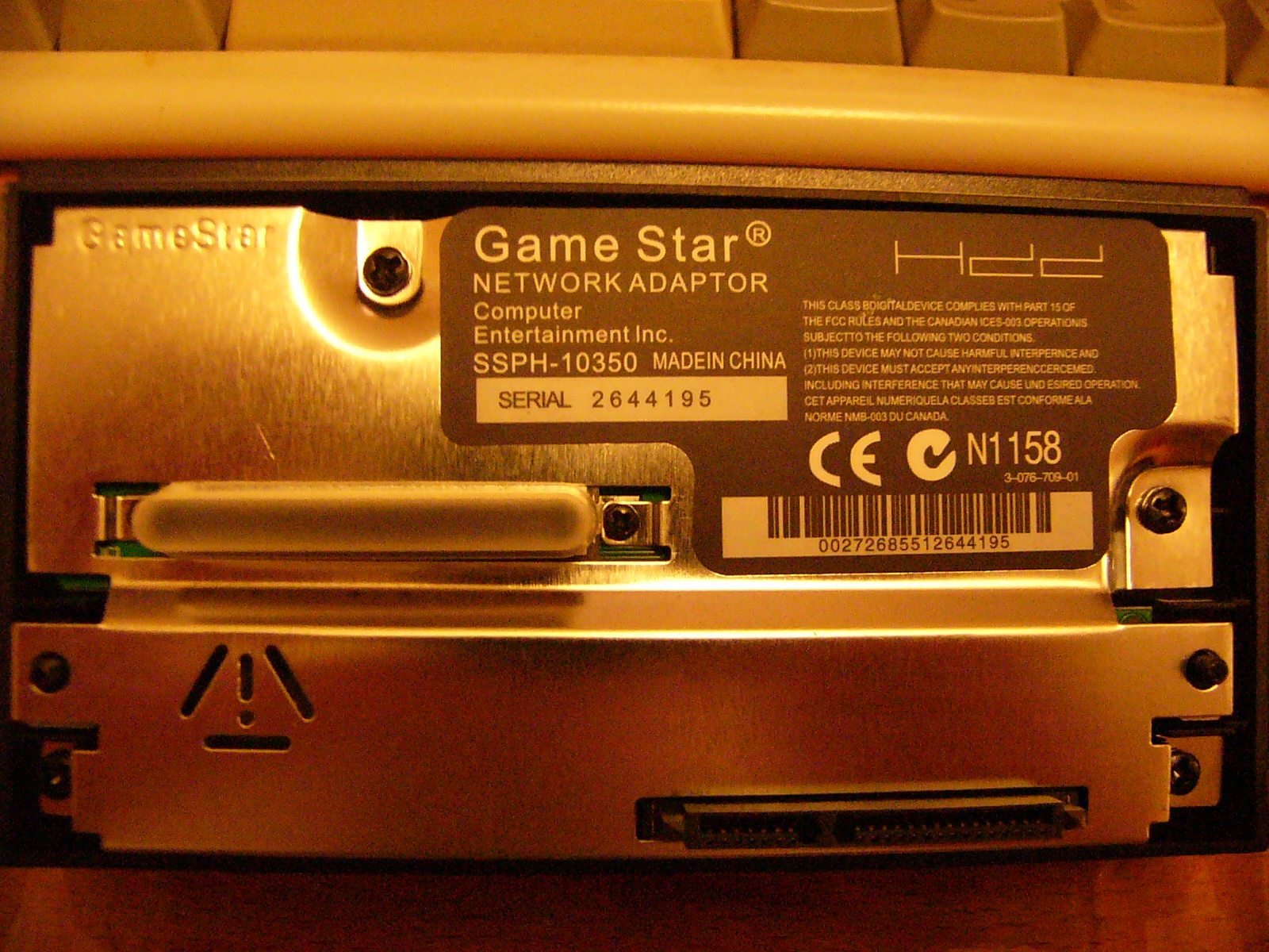

Hello.:)
The Adapter arrived today.
I will try it as soon as possible and report if something "burns" or "get on fire".....:D
Thank you.:)
