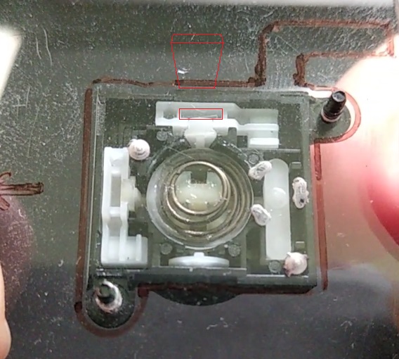

Same piece, 2 approaches, none worked properly:
The left one option was not fit in place, and the motion could make the piece move out of place. There was also no way to keep it in place properly during assembly, because the arm is too high and doesn't allow the piece to "fall" into place in the plastic. That said, with the piece in place, it would prevent the white piece from jumping.
Placing the piece between the shell and the white piece would cause too much tension and ruin the stick's smoothness, actually making it feel a bit stuck. I could try with a piece of thinner plastic.
Next idea, to shape a piece that will fit into that groove / opening. Ideally, teflon plastic.

Third attempt at a fix, seems good so far. Moving smoothly and not clicking.
Ideally this should be done with a piece of teflon plastic, but that's not something people have lying around, so I went for a more common option: a zip tie.
I cut a piece of the zip tie to approximate size and then I sanded it until it was level with the frame / shell black plastic.
If the piece is too big it will create tension and offer a lot of resistance. I believe it could even work if we "excess" sand it and use some sort of spring from below - I used a very small piece of foam (I believe it's anti-static high density foam, the kind that comes inside the packages of several electronics, like laptop batteries).
After cleaning the parts with a brush and re-greasing them, I assembled it and it seems perfect now. I still haven't actually tested it in a Switch, but I see no reason it wouldn't work.
Concerns:
How long will the plastic piece last?
How will the circuit board resist the friction of that piece, over time?
Concerns:
A possible source of Teflon that comes to mind are the PTFE tubes commonly sold as 3D printer filament guides.
Another option would be to use a slightly smaller piece of zip tie and wrap it in a few turns of PTFE tape (the kind used in plumbing) then cutting off the excess.
Regarding friction on the flexible circuit board: the orange color makes me think it is likely made of PEI (the same material as Kapton tape), which is a rather durable polymer. Also, the areas of the board that sit directly below those parts are probably ground planes without any traces (I am not 100% sure though, not feeling like opening them again to check).
I believe that the Nylon or Teflon bits, along with the grease, should take a very long time to see significant wear under those conditions... longer than the carbon film of the usual sticks, in any case.

I'm going to try a new fix today: using teflon / PTFE tape between the arm and the white piece.
Similar to the first fix, but I hope, easier to do. Need to build around 0.20mm/0.008 inches of teflon to reach the same thickness as the plastic I used before.
Fix 3, while working, still makes vertical motion less smooth than lateral, which was to be expected, as there's an extra piece of plastic causing friction against the pcb.
Pictures / instructions for opening the sticks:
Fix number 4 - 6 pieces of PTFE folded on each other placed between the arm and the white piece. Easiest fix yet.
Seems to work (I haven't yet closed and tested the stick).
Concern: not sure if prolonged use may further decrease the thickness of the PTFE tape and eventually require more.
Time will tell.
Edit: I have installed a stick with this fix and it needed much less calibration compared to the previous fix (the zip tie). This stick had already been calibrated so adding the tape - while it's not noticeable when moving the stick - definitely caused a minor movement restriction.
