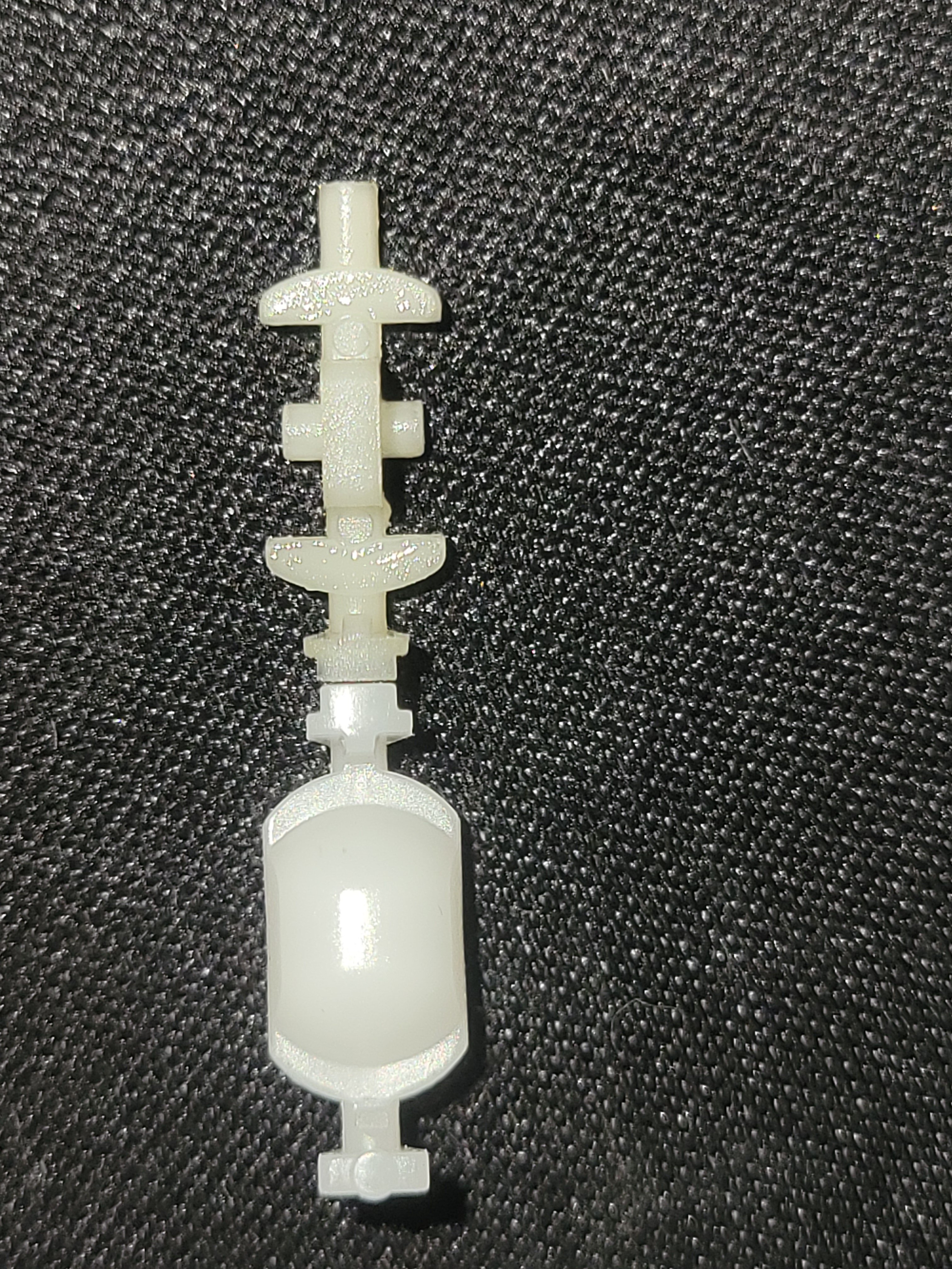

To fix the issue all what is required to do is to replace defective GuliKit axis, spring base, spring (forget about GuliKit spring, as it is not curved right and creates creaking noise and scrubbing tactile feedback) and stem/thumbstick with the Nintendo's original joystick parts as marked in the picture:
Then grease it slightly, put everything back together and it will be buttery smooth.
We get to have original mechanism with hall sensing, which is 1 part less in design, but brings much greater stability than a 3-part GuliKit variant. I am suprised how well it turned out!
Now I am trying to find proper dead zone parameters in Joy-Con ToolKit, as it is required to make small adjustments after such transplanting😁
It is not always a drop-in replacement solution with Nintendo, but once you figure it all out - it makes wonders😇

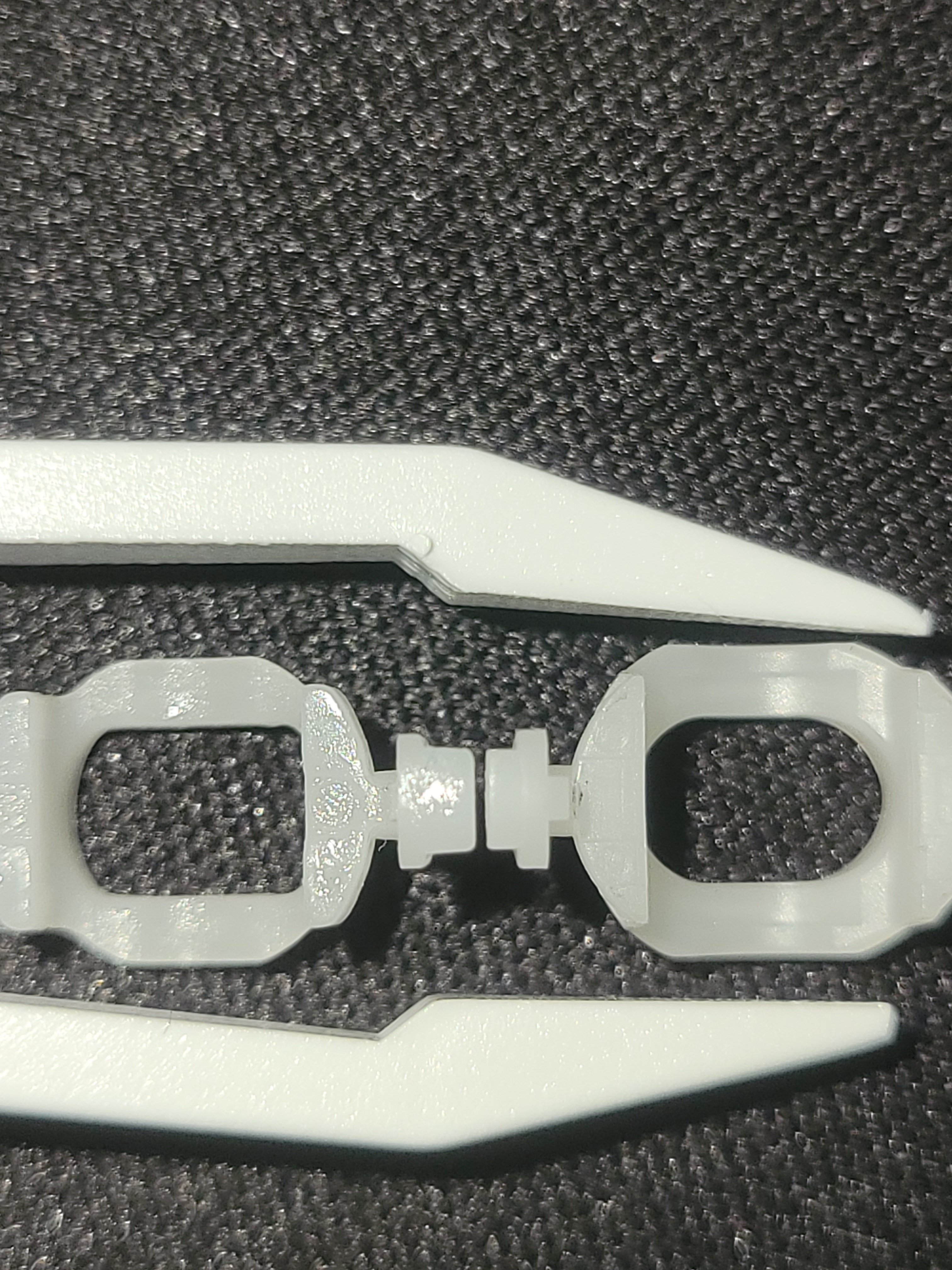

I was wondering about the dead zone and how the sliding white pieces from Gulikit's stick (the little pieces with the magnets) fit with the arms from the original joy-cons. If the parts are not the exact same width, the magnet's positions will hardly be accurate in the center / deadzone.

I was wondering about the dead zone and how the sliding white pieces from Gulikit's stick (the little pieces with the magnets) fit with the arms from the original joy-cons. If the parts are not the exact same width, the magnet's positions will hardly be accurate in the center / deadzone.View attachment 349802
They are exactly the same size as the GuliKit's.
The points of contact don't seem the exact same size from the pictures. In the top picture Gulikit's (top piece) seems slightly larger.
In the lower picture, the piece on the left seems also slightly larger, longer (longer shouldn't be a problem) and seems to have a different width from the back of the piece to the front of the piece. But if it works anyway, that's great news.
Please note that they are structured differently and materials used do also differ, therefore there might be a perception of contact points to be different in width as it could be that I took pictures at bad angle and parts were not ideally aligned, as well as GuliKit's parts are a bit translucent🤷‍♂️
I have also tried K-Silver's Hall Joystick mechanism trasplanted into GuliKit's shell and yet they had the same contacting points in width as GuliKit's or Switch original joysticks.
Therefore, I only mentioned a possibility of transplanting original Nintendo's joystick parts into GuliKit's shell as the majority of Switch owners may still have their old joysticks those have gone bad due to drifting issue.

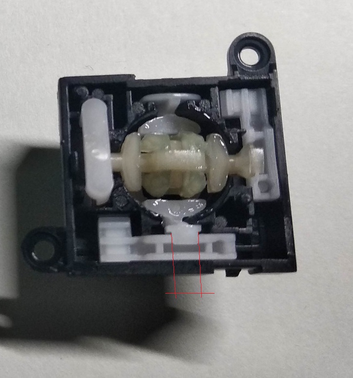

I have now opened and closed 4 of Gulikit's. I never opened one of Nintendo's originals, but the tabs seem larger and not as easy to access (the one that's single on one side).

I had my old joysticks those started drifting and I dismantled them, and no matter how careful I was, the tangled tabs got broken.
This is not the case with GuliKit's metal tabs. They are really sturdy and hard to bend. I would give it 2/10 of fragility and credability to break off score.
