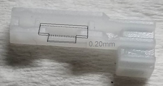

You shouldn't need to remake the whole arm. This can be fixed by filling the contact area by around 0.20mm. Here's the kind of piece that should be enough. The hole where it sits goes a bit deeper, but that should actually help to keep the piece in place.
Is it possible to 3D print something this thin and fragile?

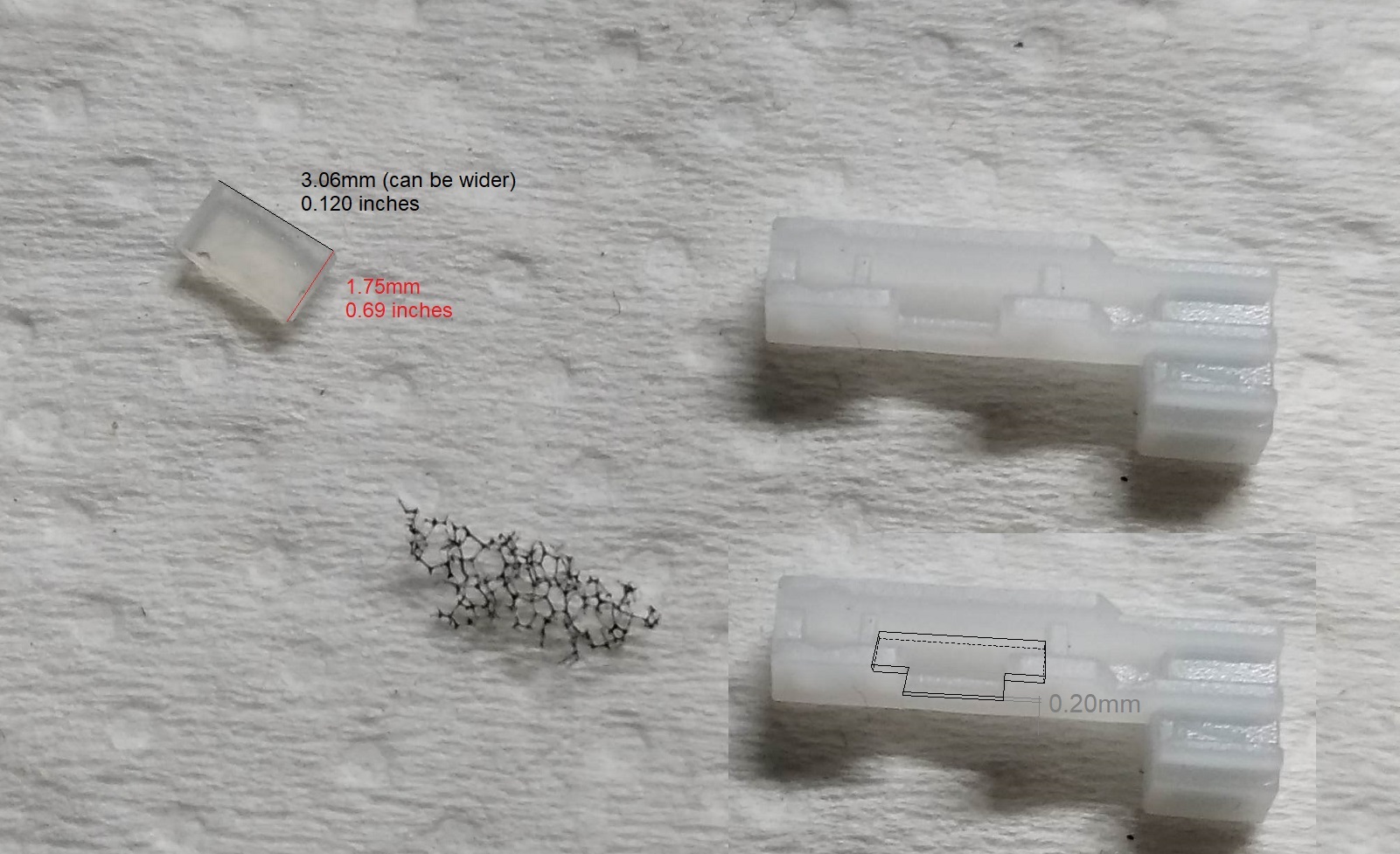

So, you're saying instead of recreating the entire arm, just fabricate a small filler block? Something approximately 3.06mm by 1.75mm by 0.2mm?
Yes I can 3D print something that thin. Modern consumer printers can print things a good deal smaller than that. A UV resin printer especially can.

Sorry, ignore the top left piece, that was another fix but it's not required.
It's just this:
It's just this:
We need a T shaped piece that is 0.2mm thick? That's quite easy. Could you send me the exact dimensions? I've got a set of Gulikit hall effect joycons on the way, but it's going to be like 4 - 6 weeks because it's Aliexpress. If you've got the dimensions I can 3D model this right now and share the STL/OBJ.
Something like this. I would need to re-open one of my sticks to check the the exact measurements I currently have them all closed with the teflon triangle fix). The thinner part's thickness is approximately 0.20mm, and the wider one is close to 3mm (can be slightly longer).
Appreciate that, thanks. If you ever open them back up, I'd love it if you took exact measurements for me.
Quick question. Would it possibly be better to make a .2mm piece that fits under the the entire slider, filling up the full space of the black housing?
The slider underside isn't flat, and neither is the housing. There are some longitudinal raised lines along the slider, and also in the housing. They are not very protruding, but putting something there would probably make the slider not slide as smoothly.
Edit: I actually had tried that, and it didn't work for me because of the friction. Maybe it needed to be an even thinner piece?

I'm already on it.
There you go. Have fun :)
Perfect. Here's an STL (3D model) and STEP file (CAD interchange) for that. If you're in the US, I'll happily print some and mail them to you to test.
I'm in Portugal, left edge of Europe, all the way across the Atlantic, but thanks anyway. I hope someone can test it and share if it works.
Reactions: stüssy
Probably PETG. But that would be on an FDM machine where the resolution may or may not be good enough. Otherwise resin.
PETG is 4 cents, resin is 5 euros XD
Shipping is 4 euros... I'll see if some friend closer can print this instead.
