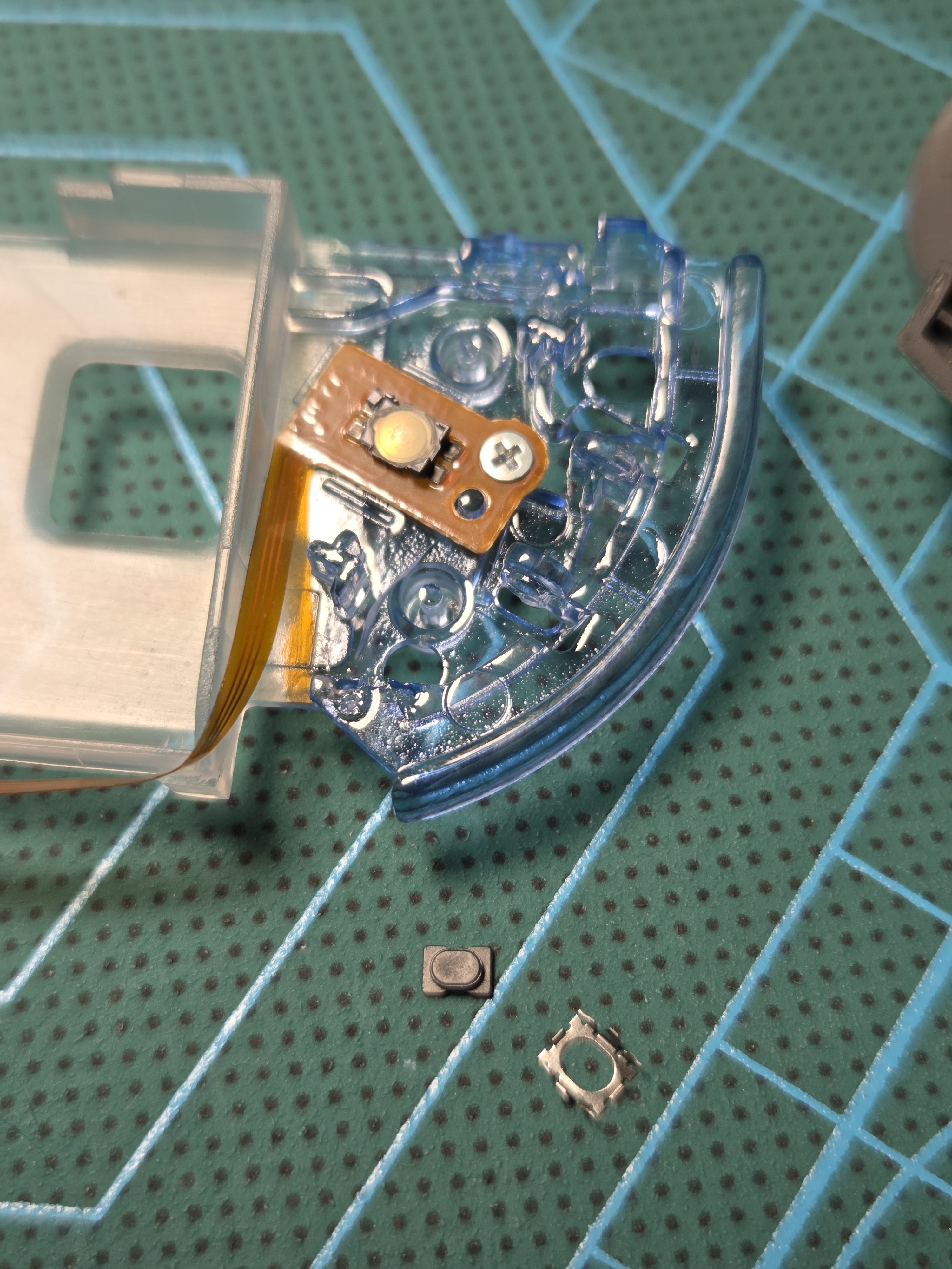

Well, I fucked it up. The ZL switch's microswitch got broken. I hope there are replacement parts on AliExpress.
The are sold but it’s not an easy solder job
that’s the most fragile part of the controller imo
I’ve had Joycons that fell off a coffee table and that micro switch would still break internally
Reactions: jelbo
Disassembling and re-assembling the ZL switch is such a pain! I still haven't figured out exactly a safe method. I just put a flat tool underneath and pop it out...
I guess I'm paying someone to put the hall effect sticks on my joycons
If it was just that there wouldn't be a problem. It's this tiny switch that is vulnerable, but you can leave it as it is for just a stick swap.
