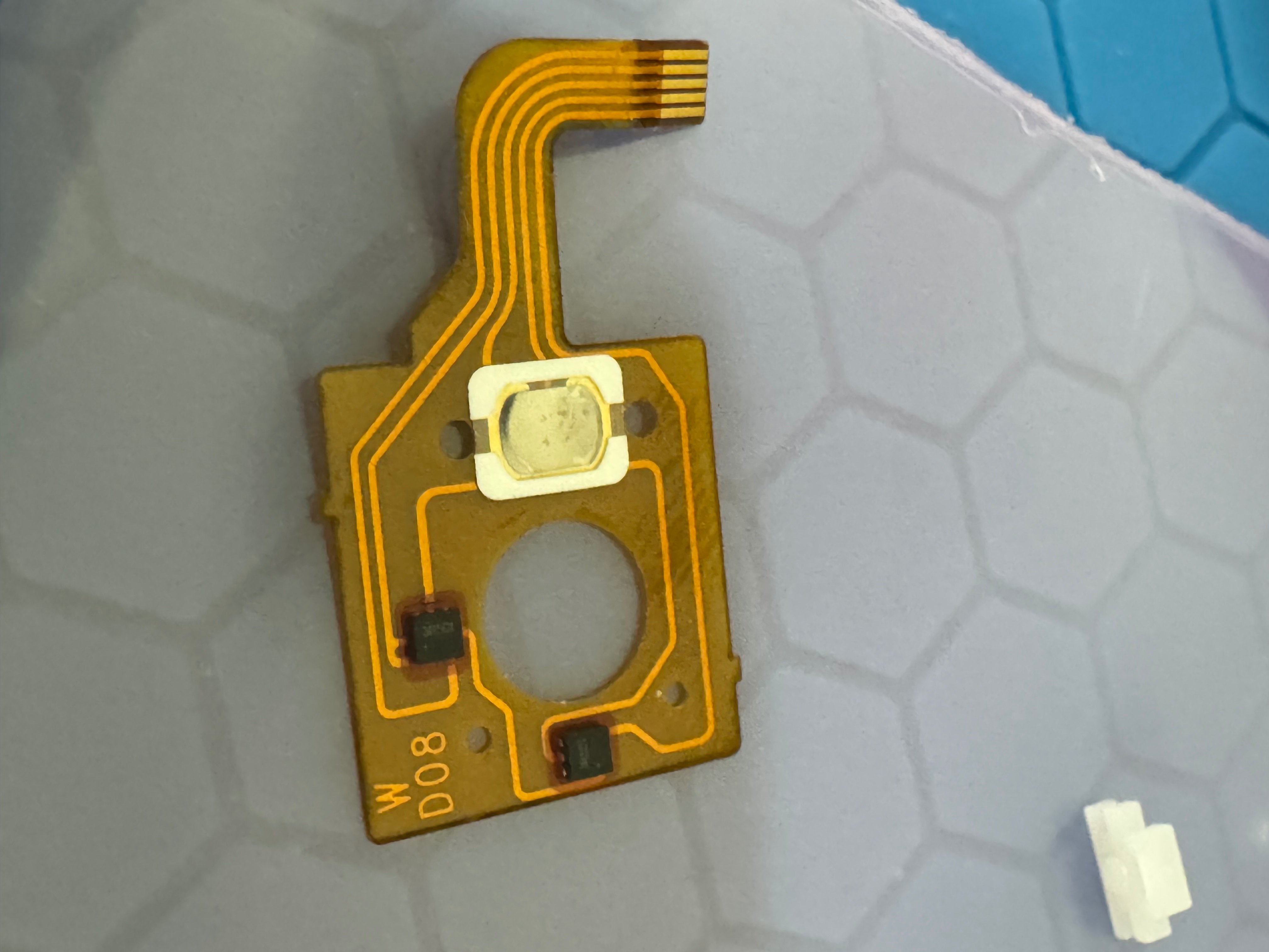

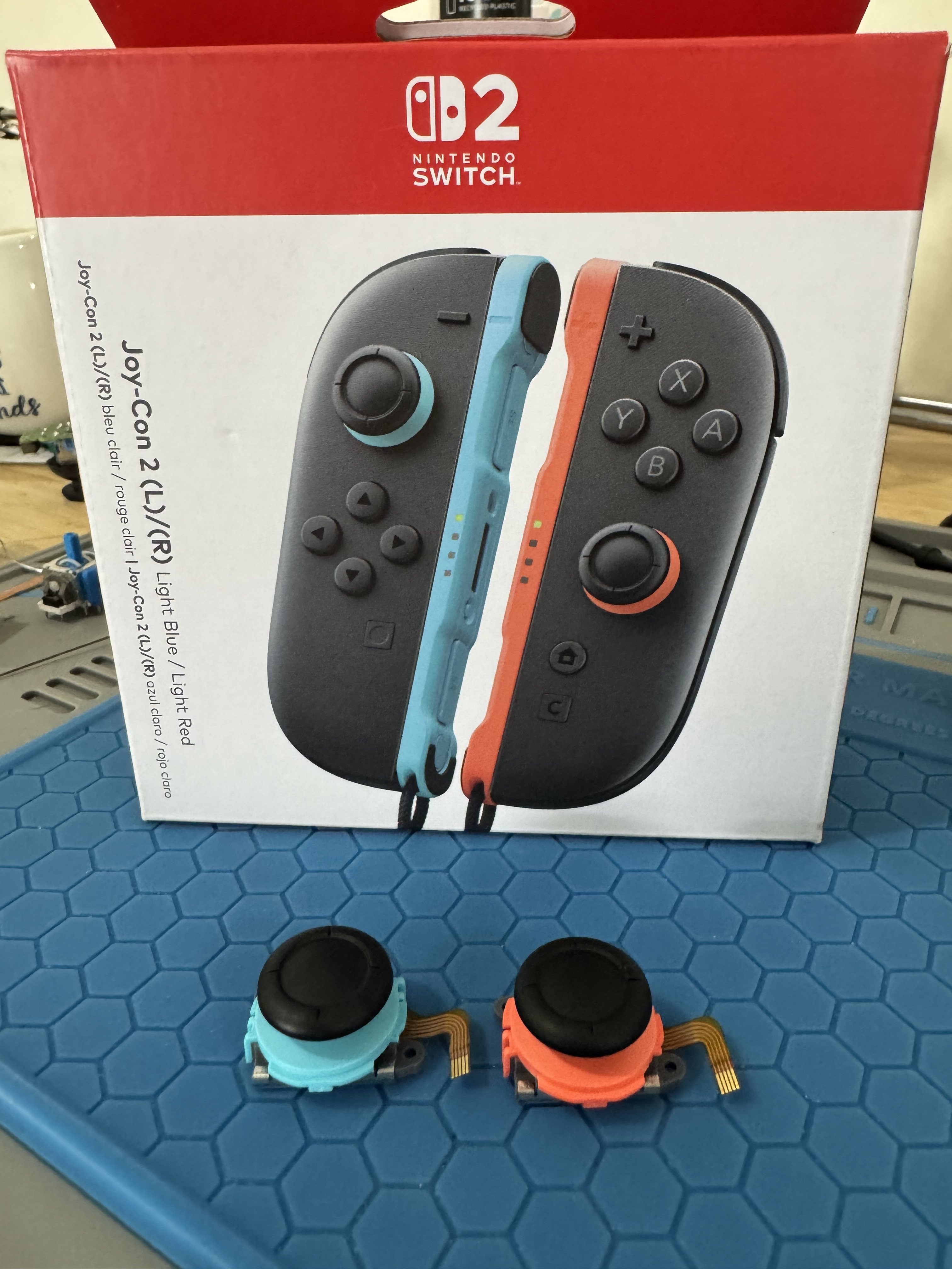

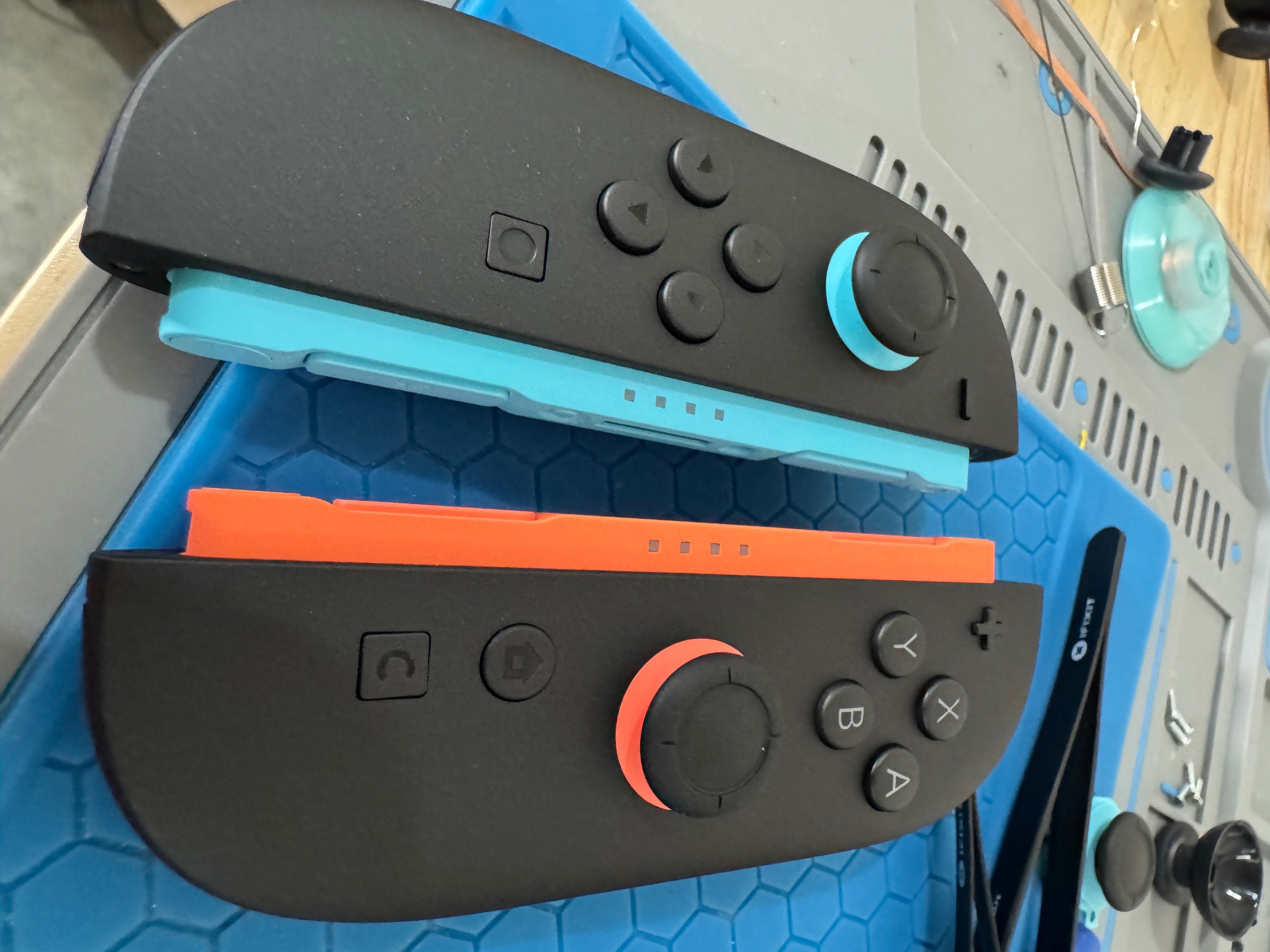

More and more sellers on AliExpress are now selling the first Joy Con 2 Hall Effect sticks.
It’s been only a few days, they do feel stiff in comparison but have some advantages to those who installed replacements in the Switch 1 Joy Cons.
1.) No calibration was needed, maybes it’s a one off but worth mentioning, I’ll test additional pairs
2.) They have not in the last few days experienced any magnetic interference
3.) You can still update your Joy Cons with the sticks installed, so no detection or prevention from Nintendo
4.) You have to do a lot more teardown and remove the board to get them installed. (this was not needed with the Switch 1)
Have any questions or tests to run? I’ll keep personally using them to provide longer term feedback and reliability. IMG_0701.jpegIMG_0727.jpegIMG_0705.jpeg
