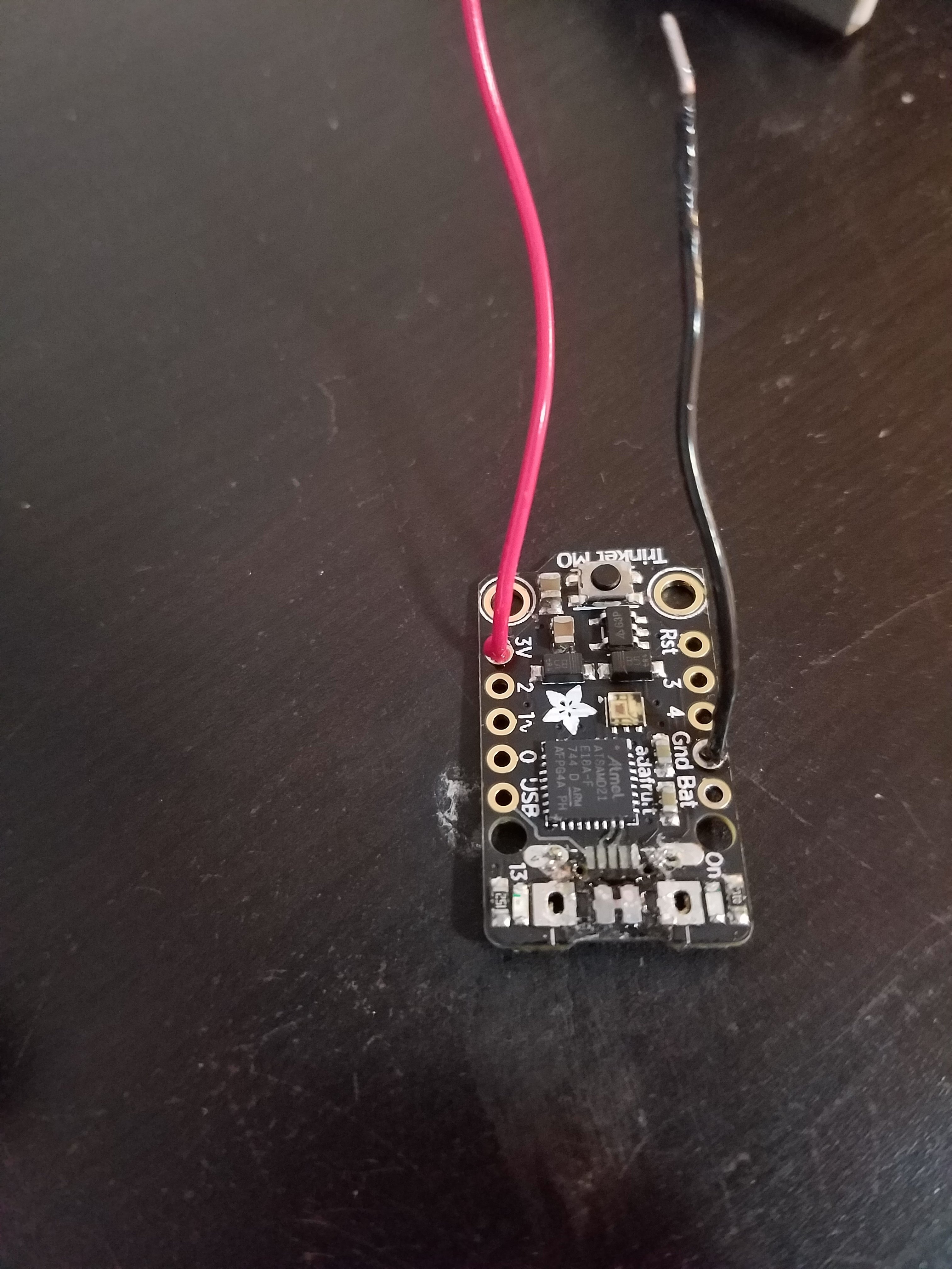

Section 2. Removing USB port and unneeded LEDs. (Adafruit chips only)
  • Next, we need to remove the USB port from the modchip. I recommend a heatgun or a rework station. Heat up until the USB port just lifts off the modchip.
  • Do the same for the LED just to the right of the USB port.
See picture:
You are now ready to fit your device. Proceed to Fitting section.

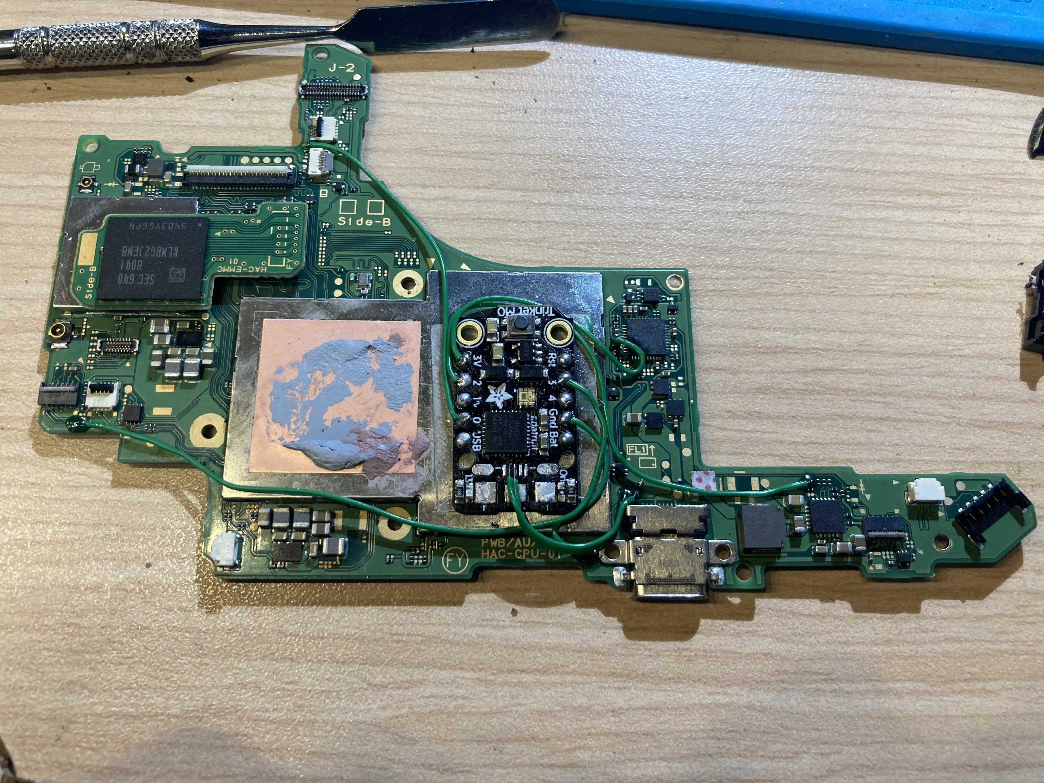

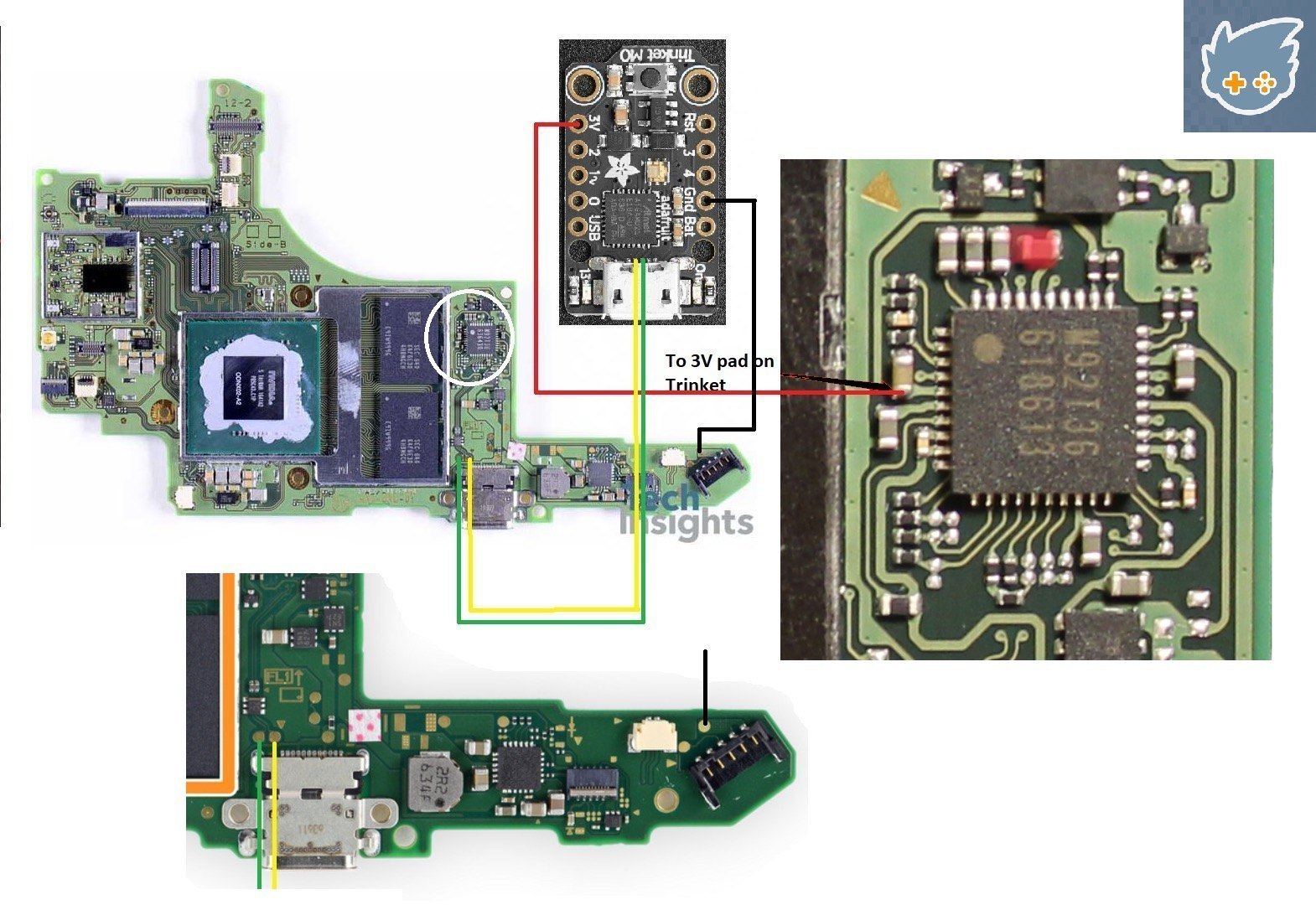

Section 3. Fitting modchip to your Switch.
New Universal Method. All SAMD-based internal chips. If your chip is not supported and you cannot work it out, PM me.
Trinket M0.
Solder as laid out in the following picture
Rebug SwitchME M0. Use Trinket files.
RCMX86 - Internal modchip version.
Gemma M0. Use Gemma files.

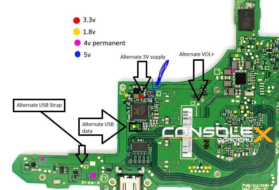

Alternative Solder Points
Credit to @consolex for original pic. I`ve added alternative points to solder to:
Credit to @pyorin for this much tidier version showing the same info as the above one!

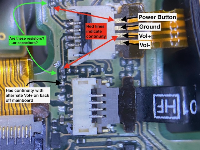

Replacement Parts List
Ok... So you have damaged your switch soldering your chip in. Not to worry.
First things first, DO NOT BRIDGE THE CONTACTS HOPING TO REVIVE YOUR SWITCH. With resistors, you may possibly get away with this, but with the capacitors listed below, if you jump these points, you will make a nice short-circuit to the PMIC and / or the M92T36, killing them instantly. Don`t do it.
OK... I`ll list these parts with METHOD 2 & 3 TRINKET PIN NUMBERS and the values of the components they solder to.
TRINKET 3V (POWER SUPPLY) - 2.2uF 0402 size MLCC capacitor. Voltage unimportant as long as it is over 6.3v
TRINKET PIN 2 (POWER ON RESET - goes to pin 5 on M92T36)- 4.7uF 0402 size MLCC capacitor. Voltage unimportant as long as it is over 6.3v
TRINKET PIN 0 (VOL+) - 150R (150 ohms) 0201 Thick Film resistor. 50mW
TRINKET RESET (SWITCH POWER BUTTON) - 150R (150 ohms) 0201 Thick Film resistor. 50mW

IF YOU REQUIRE SUPPORT, IF YOUR CONSOLE ISN`T WORKING CORRECTLY... PLEASE POST A HIGH RESOLUTION PICTURE OF YOUR INSTALL. You might think it isn`t your soldering, but in all cases with the new methods, it is bad soldering. So, please post a picture.
A BRIEF WARNING - PLEASE READ
THIS MOD IS NOT FOR THE FEINT OF HEART. WE ARE SOLDERING TO TRACES AND COMPONENTS ON THE FRONT SIDE OF THE BOARD TO SAVE HAVING TO REMOVE THE BOARD AND SOLDER TO TESTPOINTS. IF YOU ARE STRUGGLING, OR THINK YOU ARE GOING TO STRUGGLE, PLEASE PLEASE SOLDER TO THE TEST POINTS NOTED IN THIS AND OTHER THREADS (YOU WILL NEED TO REMOVE THE MOTHERBOARD). DOUBLE - TRIPLE CHECK EVERYTHING. YOU HAVE BEEN WARNED!!!
Good soldering skills are needed!
A magnifying glass is needed!
Good soldering iron needed - ideally with a 0.3 conical tip. No more than 30w!
SECURE YOUR WIRES PRIOR TO SOLDERING. Stick them down with double-sided tape.
Only use glue if you need to and glue wires after soldering. Don`t glue the solder to the component!
Put the tiniest amount of glue on the PCB mask only. Never on components. Use a cocktail stick for more glue control!!!
Take a look at alternative solder points to get you out of the sh*t if you do rip something off the board
If you aren`t the best at soldering, then think very carefully about connecting to pin 6 capacitor (the one in these new methods). If you rip this pad, you WILL NEED TO REMOVE YOUR BOARD and run from a testpoint.
