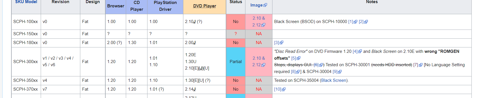

if the above doesn't help, try downloading FreeDVDBoot prebuilt iso for 2.10 (covers some 30001 models) from here:
https://github.com/CTurt/FreeDVDBoot
if that will boot your console, you will be able to run the FreeMCBoot setup and build your own card for your specific model Here's a youtube tutorial for exactly that:
Then try booting with just the FreeMCBoot card you just made.
If that still doesn't work but the FreeDVDBoot disc did, you could always try making self-booting discs and not need FreeMCBoot at all using FreeDVDBoot ESR Patcher:

I assume he either installed Freemcboot on a genuine ps2 memory card on his slim with the fmcb mc he already had, or did it with the FreeDVDBoot disc, both achieve the same thing.
I think he used the FreeDVDBoot cause the SCPH-30001 is the only one that is tested.
