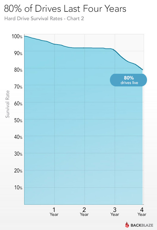

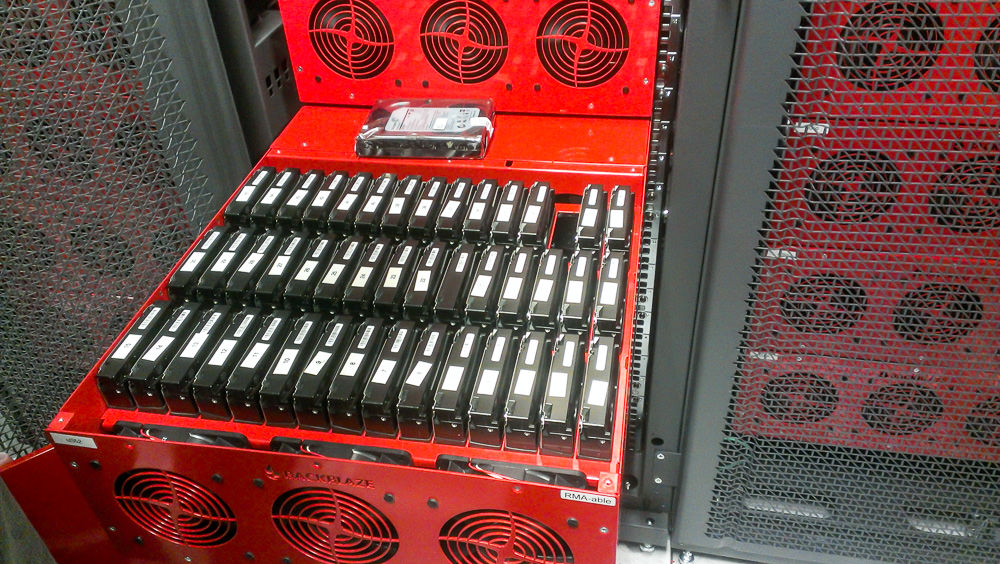

This information is from statistics from a Server farm where are the drives 24/7/365 are under heavy load. Blazeblade provide such public information.A typical HDD lasts 3 to 5 years, some even die earlier because of mechanical failure.

A typical HDD lasts 3 to 5 years...
...i see this is written on lot if sites, even on sites from data specialists...
This 3 to 5 year lifetime commes from a server farm statistic like Blazblade as Cloudservice where are 25.000 drives run 24/7/365 around the clock. They are permanent under heavy load like spinning up and down, reading and writting, high heat and worst for the machinal parts. Backblaze uses Consumer HDDs, not Enterprise HDDs that are especially created to run 24/7 and more reliable to run in such Server farms. So you can easy imagen, as home user that doesnt have that load like a Cloudservice. If you would run the drives daily between 8 and 12 hours, There is a theoretical 80% chance that the drive livetime take about 8-12 years.Good. Yes some HDDs can last that much (9-15 years), but they begin to degrade earlier, working slow, sometimes crashing, at least that's what I remember when I was still using HDD in my laptop.
