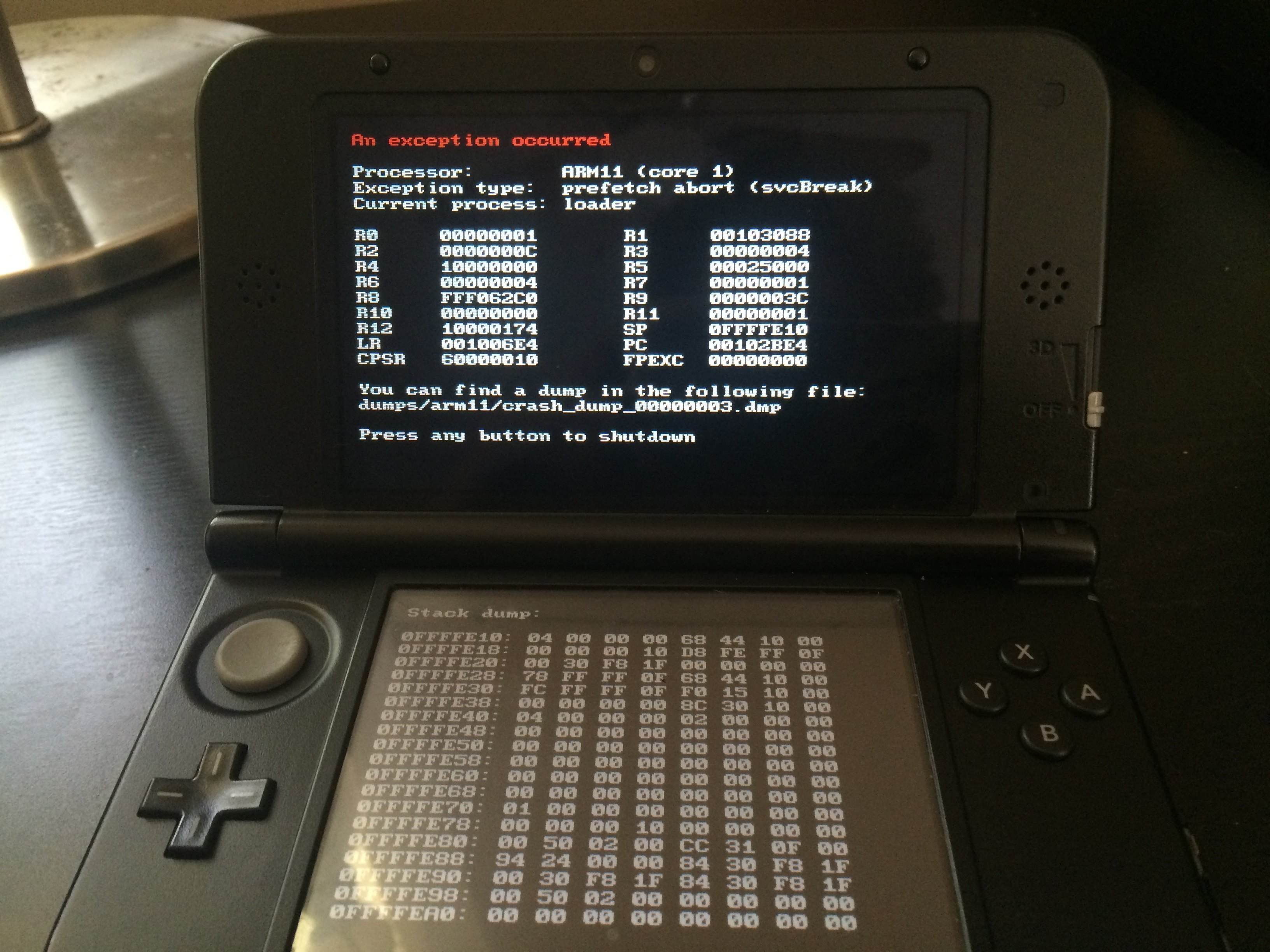

Well, looks like the new A9LH (no cfw) + Nightly Luma is fully working without SD. If you want to try out, download the lastest A9LH binaries provided by @gnmmarechal (download the "no cfw" one), install it with SafeA9LHInstaller 2.x, download the lastest nightly of Luma3DS (don't change the path, keep it as default path), put Luma's arm9loaderhax.bin on the root of you CTRNAND with GodMode9 or FBI. Profit!

This isn't working. my 3ds is booting but always gives me this error when booting without sd card.
