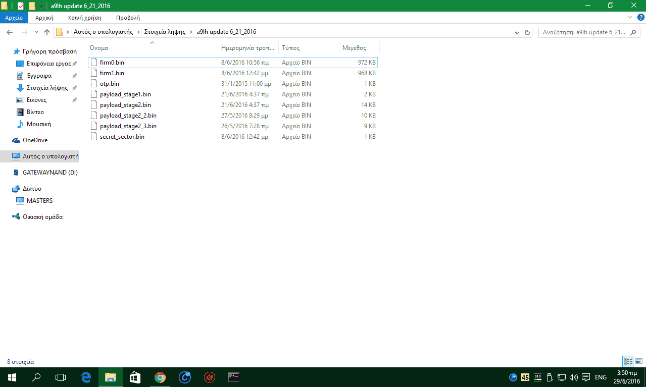

this is my a9lh folder can i continue whith this files ?
