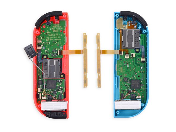

The Joycons use wipers the just like the 3DS circlepad, which isn't a problem on its own. Now add in the button that requires pressing the analog stick inward, unlike the 3DS, and now the wipers have tension placed on them laterally and longitudinally, which bends the prongs.
With the stretched out prongs reaching farther across the PCB traces, the prongs are now outside of the 'deadzone' set by Nintendo and is interpreted as user input instead of a new 'at rest' position.
But the material the pads on the JoyCon sticks are made out of seems to be the main problem. I don't know if the 3DS circle pads used the same material, but it looks like some sort of graphite material and wears out really easily.
The root cause of both faults is the same - the stick is "sticking" to a value. That is, unless a part of the assembly straight up broke off and no longer moves. :P They're definitely less common though, I'll give you that. Sliding the slider back and forth must put less stress on the carbon traces and the wipers than using the stick, which makes sense. Alternatively, they changed the carbon trace material to something softer and the wipers just tear right through it.
I have personally fixed my joy-cons by taking the joysticks apart. The problem is because of very fine dust covering the carbon traces and messes up the resistance readings. After cleaning off the dust with alcohol on a Q-tip they were A-ok. This is not a case of the sliders "eating up" the traces.
Now as to how the dust got in there in the first place, I'm not sure. It can be either from the external environment OR it can actually be ground up plastic from the internal components of the joystick. It was white and very fine like talcum powder and the internal pieces are white.
It looks like it could have been the white plastic sliders themselves grinding against the black plastic enclosure, which would explain the small black and white spots. Either way, the Joycons could have been made MUCH better than they are currently given the retail price.
Hell, the knockoffs analog sticks available on eBay are only $2 to $6 and function nearly as well, meaning it probably costs less than a dollar for Nintendo to make.
I wonder if we could cover the white slider in some form of noninvasive lubricant or coating that would prevent/reduce the friction between the slider and casing? Also, could we electroplate the slider wipers to make them less prone to degrading?
Good point. It can also be from the ball and socket joint pieces that support the stick. Perhaps if they were made from a harder material that will solve it. The price for a set of joy-cons is daylight robbery at the moment. They are extremely overpriced.
Having not looked into it I can't say but I would say be careful making such definitive claims based on a sample size of 1. Similarly if we are talking about grit/wear products getting embedded in carbon acting in a mechanical role we have this little thing called brushed motors.
I suppose, but some people have had luck blowing compressed air into the stick and temporarily fixing it for a few days/weeks before the problem recurs. I would say the dust was moved around before settling back onto the contacts because of the moving parts. I'm not saying it proves my claim but it gives it some credibility.
The joy-cons operate with a very thin layer of carbon having a tiny footprint which makes them super sensitive. I don't know much about brushed motors but do they operate in similar circumstances? I imagine they have bigger parts and are less sensitive to dust?
It was not a lack of credibility or viability of that failure mode as much as claiming it is the only one/likely not another.
As for brushed motors. Yeah you have two or more blocks of carbon (sometimes impregnated with other materials) that are held in by springs to the spinning bar (called a commutator) of usually copper and wear down as the motor turns. Grit getting in and things falling off and getting bound up in it is probably second only to the brushes themselves wearing out, or maybe the stake wires coming off (especially if they are not epoxied in like a lot of cheap devices skip). Aside from the limited lifetime brushed motors have an awful lot of advantages so almost everything before about 5 years ago with any torque will have used them somewhere in it (even if only as a starter) and even today they are still common as you like -- if something is not brushed it will be in the sales fluff saying whoo this is brushless.
Also the carbon on board approach has been used for many years; if you have some old remote controls then pull them apart, chances are the cheaper devices will be this (or the reverse and have a membrane pad with it embedded it in). Most of those are single press buttons but flex fracture and wear are seen there, as well as dust and grime.

The bumper microswitches are mounted exactly the same way as all vertical microswitches are - using two additional pins on each side. The switches on the 360 controller are mounted the same way, it's actually fairly robust. The gap is there to allow for some flexibility - if the switch was mounted too snug, you could accidentally lift a trace. By giving it a little bit of room the microswitch will just bend back a little and, hopefully, spring back into place, but I can see what you mean - there is potential for it bending permanently depending on how ductile the metal is. They could implement a secondary vertical board to mount the microswitch flat, but I don't think it's too offensive.
As for the flex cable, I wouldn't worry about it at all - it's not a moving part, so there is no reason for it to develop a fault unless it's pinched during assembly. Flex cables fail when they're repeatedly flexed back and forth, that's why we see screen failure on clamshell systems like the DS or the 3DS whereas Circle Pad or mic faults are relatively rare unless it's the user who was messing about. Cables in general work harden, they don't disintegrate randomly. :P
The cables break only after a few flexes. I only opened mine twice before they broke.
Also I wouldn't call the carbons traces thin, they're about 0.5mm IIRC, mine barely had the surface scratched.
The trace is not pure carbon, it's a mixture of carbon and resin, so the dust resulting from friction wouldn't necessarily be black. That said, judging by the fact that it was "very" white in this instance, my guess is that it actually comes from the analog assembly itself - that's where most of the friction occurs.
It would also be consistent with what happens on other sticks, except there the potentiometers are better-isolated due to their position and the shape of the assembly. There are some inert greases meant specifically for plastics that would solve this problem and lube things up, might be a good idea to give it a little dab. Plastic gear grease is cheap, a small application in the mechanism, working it in and removing the excess would not only stop the plastic from shearing during use, but it would also "catch" any dust that's already on the surfaces and trap it in the grease - something worth considering for all the home-grown engineers here.
The end-user is expected to open it zero times, it's not something the average user should have to do at all, so you can't blame Nintendo for the flex breaking during disassembly. As for the scratches on the traces, you won't necessary see the damage with the naked eye - we're talking about a high precision part with very specific tolerances. Even a bit of dust ingress can render it unusable, let alone microfractures or scratches on the resin.
What you appear to have missed is this generation of joysticks is generic off-the-shelf components. These joysticks are used by more than Nintendo and are generic components manufactured in the same form by multiple companies. So those sticks on eBay aren't knockoffs, they're just compatible OEM joystick components.
I would not be surprised if the excessively cheap sticks you often see sold in large batches were exactly the same sticks that failed QC due to small differences in tolerances, or even straight up the exact same sticks, depending on price. *Some* assemblies are custom, but that's exceedingly rare nowadays, yes.
Nah the fake sticks are designed differently. They're replicas. You can tell them apart visually.
That said, original parts are now available from China.
