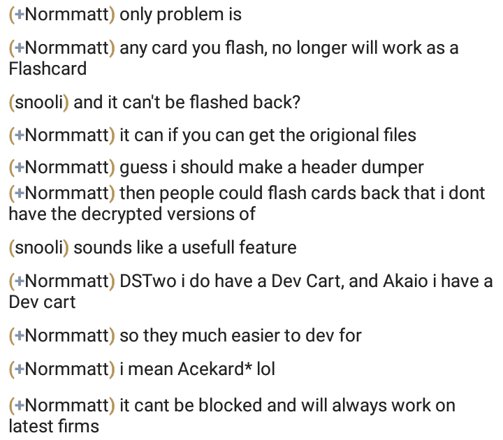

I am not confirming or denying this, but for those speculating on what kind of NDS carts this method works with, many of the suggestions here are likely wrong. While an NDS cart with flash-able firmware is a requirement from what we know, flashcarts that flash their firmware from their own built-in OS may not work (and would render them completely unable to go back to being a functional cart again). It's likely that the only NDS carts that'll work for this are ones whose firmware can be updated via PC, such as this one: Supercard DSonei which includes a USB adapter for direct firmware writing. This one is not very expensive so I doubt it's the one spoken of in the proof of concept video. Still, it would be wise to hold off until we get some official confirmation.

Normmatt already said AK2i works, which was very likely considering their past with it. Godmode9 also has an AK2i flashing option. sooo.
But yes, ones flashable via PC will most likely also be included so that people don't need another modded 3ds for this
Oh, I only saw speculation about the AK2i. Could I get a source link? I'll be looking for it in the meantime but if you have it handy that would save me a lot of time.
It has been confirmed by Marmmott himself that the PoC was done with an AK2i. He is currently working on a DStwo version, as he also has one of those.
I believe it was discussed in IRC, which I don't have open anymore. So I can't send a source.
