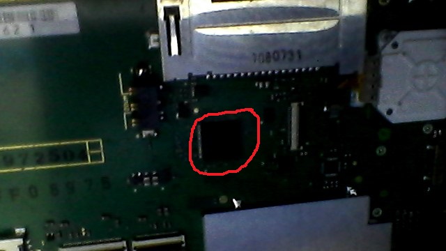

I see a black square where I think the module should be. Please correct me if I'm wrong, though.

You have the revised o2DS (late 2015+ production) that has the WiFi module baked onto the motherboard.
That means your issue isn't the unseated WiFi board that's common on other o3DS, o3DSXL, and o2DS (early production).
Reassemble the o2DS. See if this elicits any response.
