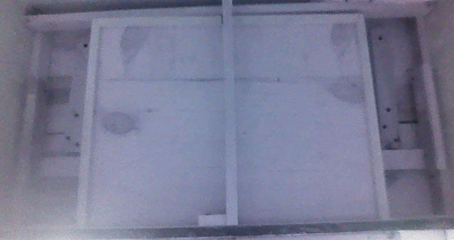

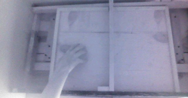

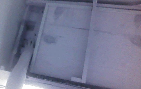

Cutting holes in the desk was something I had hoped to avoid. What I just found out about my desk is that there's no bottom plate in it. What I mean is that the drawer has a bottom and everything, but to the left and right of the drawer is open space. You can even reach a finger inside the drawer through the bottom of the desk! I took a whole bunch of pictures to describe what I'm saying. Give me a second and I'll edit this post with the pictures.

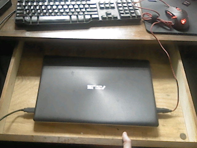

It may be possible to keep the laptop there. Sometimes I leave my notebook in a drawer too. When you open the drawer after a long day, you can feel a huge temperature difference that dissolves very quickly.
Modern laptops try to clock down the cpu frequency, when they get to hot. If this does not help, the thermal throttling slows down the cpu with a big impact. I think it sets in by about 90°C.
I would suggest to try it, when you are near, let the notebook do some things, monitor the temperatures from another computer and let it do it's job für some hours. If everything stays green, there should be no problem.

I'm not sure what you mean by that, and the pictures aren't exactly clear, but from the sound of it there might be enough air flow to give the laptop some cooling.
On the other hand, laptops generally have pretty bad cooling as it is, what with the space constraints and all, and putting more strain on that cooling system is probably not a good idea.
Maybe it would help things if there is enough space to install a fan in the gap in the drawer (which I'm still not sure what looks like since the pictures don't show it), it would help air flow a lot better than the laptop fan can do on its own.
Laptop fans are really designed for open air, they do a sufficient job at moving air from one end of the laptop to the other, cooling the components inside of it just enough to keep the temperatures within safe limits and rarely much more than that. Expecting it to be able to suck air into an enclosed compartment even if that compartment has small gaps is asking a lot from it.
Another Idea: Turn the notebook around so it lies on it's cover. By this, you leave the hot bottom more space to release the heat to the air because the wood isn't a good thermoconducter.
But on the other hand, that might cause the screen to get excessively hot, which isn't good either.
I've heard that you shouldn't leave a laptop closed and on because of that very reason, and I've noticed my laptop's screen getting very hot when left on with the screen closed, something I don't generally do but sometimes when left in sleep mode it wakes up on its own so these days I just tend not to close the screen at all unless it's turned completely off.
The laptop might be designed to emit it's heat through the keyboard. It may get a bit warm. I can't tell you, if its harmful or not. You have to decide on your own, if you want to expose your display to such temperatures. I would say, if it feels a bit warm if you touch it with your hand, it's not a problem.
