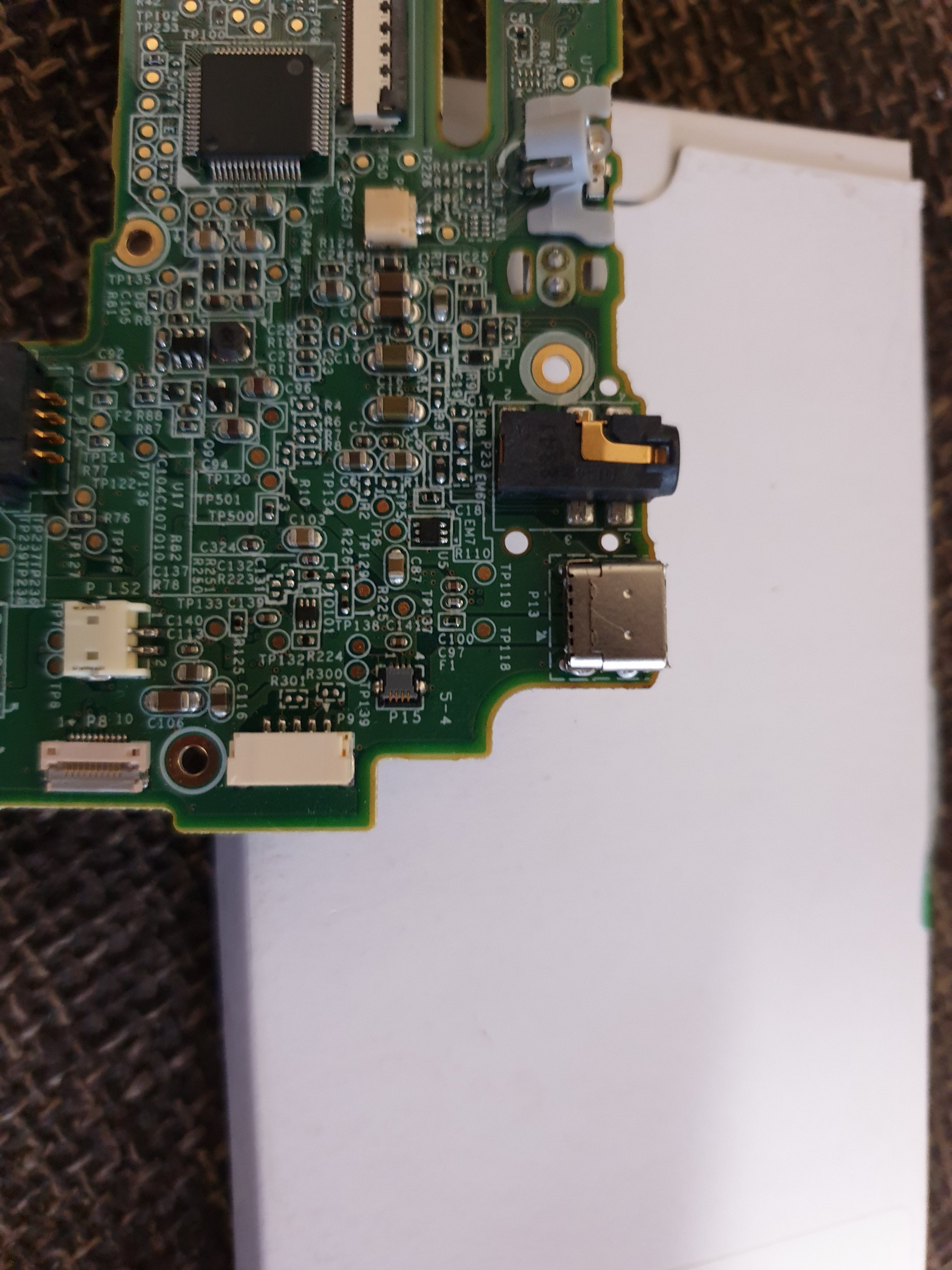

Hope its help anyone.
Installed charger port from xiaomi mi pad2 - minimal modification. Working fine
20190609_202940.jpg 20190609_193624.jpg 20190609_193643.jpg 20190609_202442.jpg

I mean, do you think it'll start making the battery fail faster than it already does?
Do you think it''ll last over a year?
No. Not chang battery life 100%. Charging fully controlled power ic. I know that orig charger have 4.75v, but with 5v all work fine.
Adapters micro usb to wiiu have been sold in stores for a long time, this is a similar
