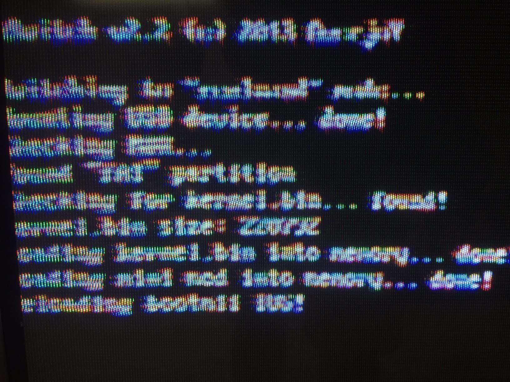

Here's what I get when running nswitch from the HBC:
(Sorry for the low quality. If you can't read it, I'll try to get a better picture as soon as I can.)
It freezes at the "reloading bootmii IOS!" line.

if you use Nswitch, you need the bootmii IOS.
if you want to boot into neek using boot2 you need to replace the armboot.bin file in sd:/bootmii/ folder, and restart your console. It will load neek at launch. (you can't bypass it, until you replace armboot.bin with the original again, so keep a backup!)
