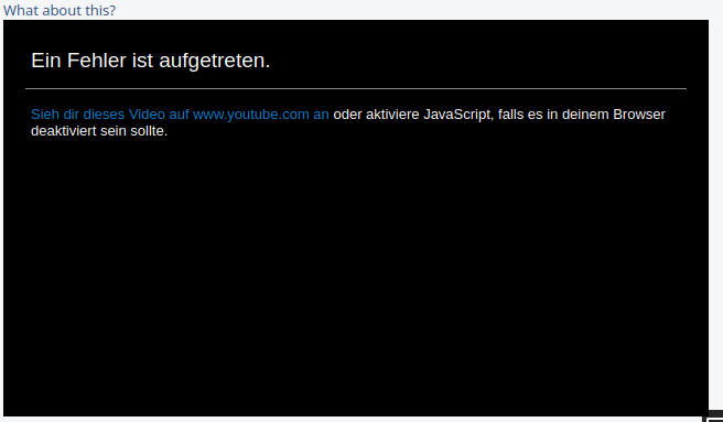

What about this?

Also what about the video?
To be honest I don't feel like watching every clickbait "tutorial" video out there¹. Usually those >10 minute videos try to monetize and contain so little information that they would hardly fill a paragraph – either with annoying spoken instructions or even worse: useless music and written instructions with the mouse pointer circling five seconds around anything the viewer is supposed to click on.
To my knowledge there is no software based entrypoint in the situation you have described. If that video does contain such a thing I'll be glad to unblock YouTube and learn (no sarcasm!)

¹And my script blocker makes them look like this:
Yeah..
