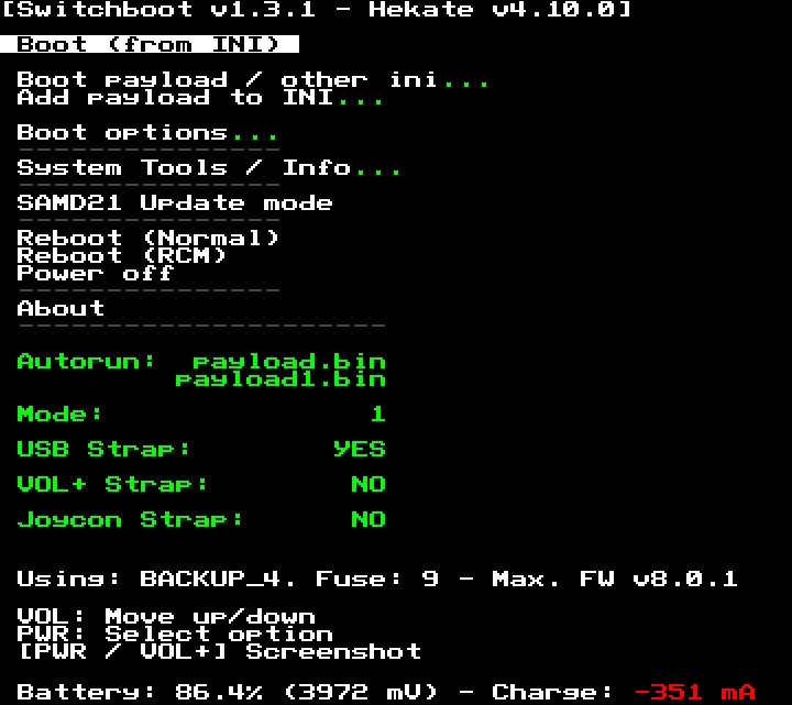

View attachment 164760 Just done a single-byte change in v1.3.1
So the FW displayed for current fuse is v8.0.1. No other changes. If you have already updated, no need to change...
Do a diff and you will see only a 8.0.0 has been changed to 8.0.1.
So, no new version number, just a cosmetic change.

I've tried both ways of disabling the usb strap.
flashing UF2 & disconnect trick - This takes away my vol+ strap according to 1.3.1 menu
holding vol+ for 18 seconds does nothing for me.
It doesnt take vol strap away. It is just unrecorded until you press it. Press it and it will update on next boot.
If it does nothing, then double-check soldering on RCMX86 chip. The chip should be disabled in code once it goes to sleep.
Thats all I can suggest.
If there are problems, it HAS to be the USB logic chip causing a conflict. This has happened before.
