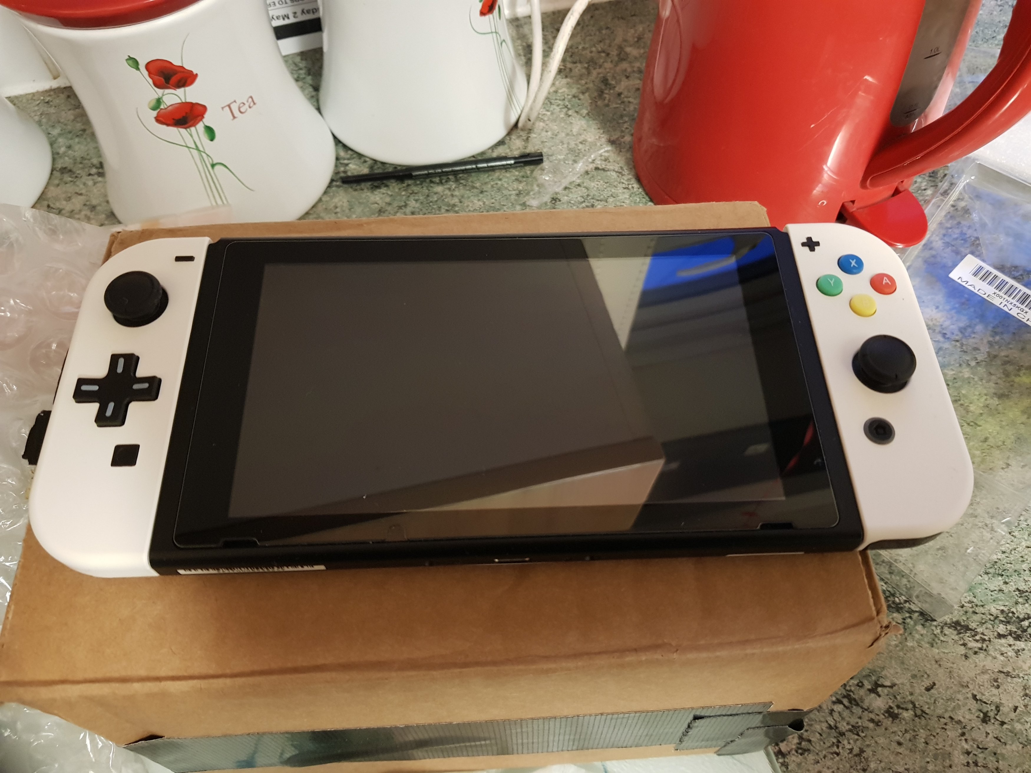

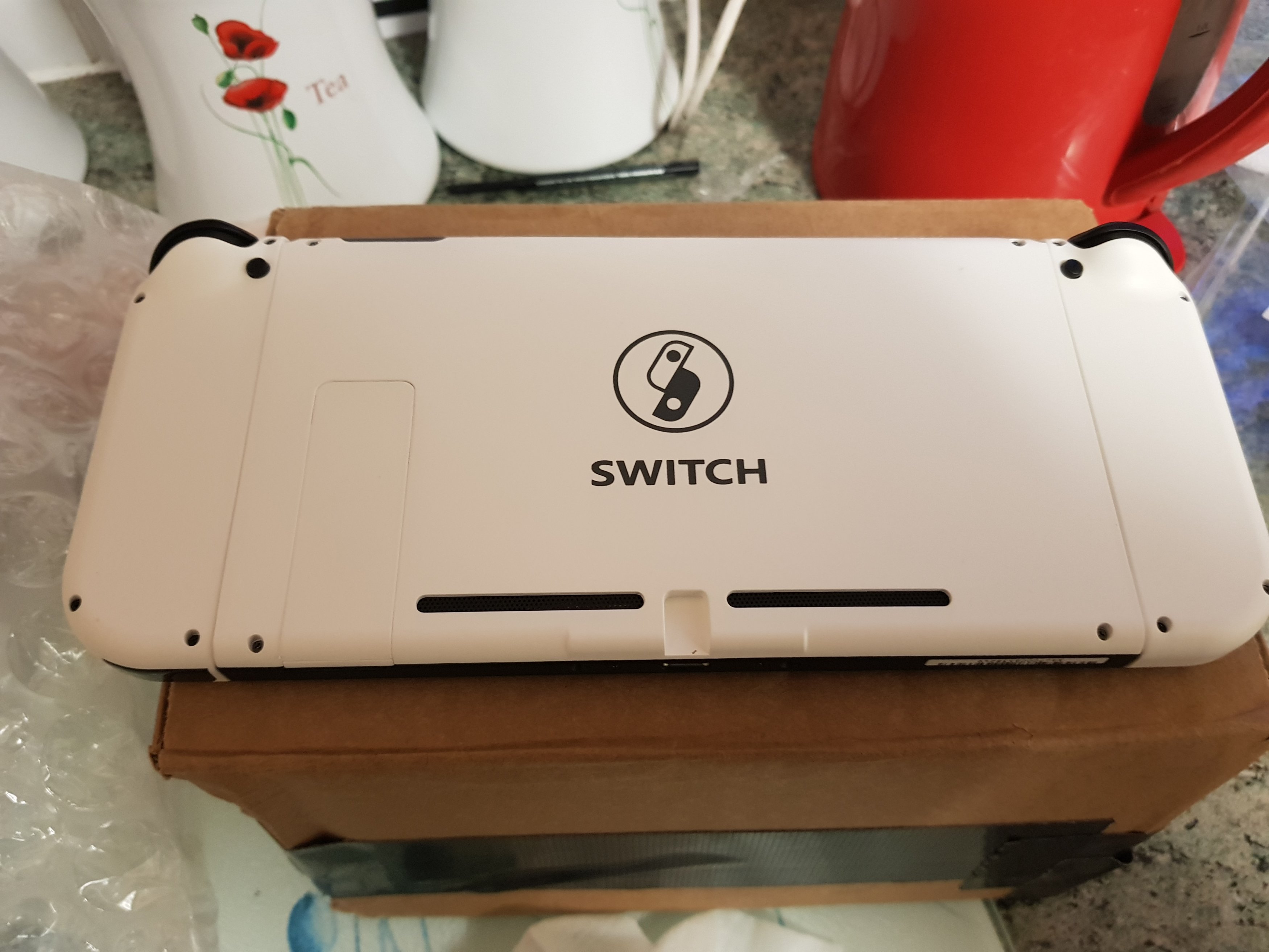

Not my cup of tea but the job went pretty well.
The joycon housing mouldings aren`t the best. Poorly fitting rails. No way do they click together without a bulge!
However, with some adjustment and a strip of adhesive, the job is done.

@peteruk
View attachment 162751 View attachment 162752
it looks bloody lovely mate !!! DM incoming sir - thank you !!!

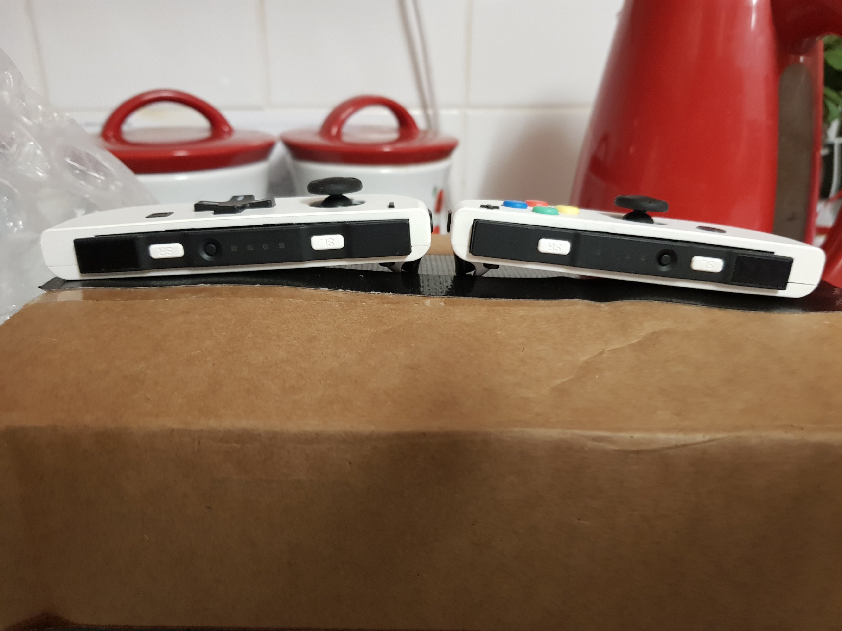

Joycon sides.
The moulding on the far edges is messy and not very accurate... But apart from that, the mouldings are a reasonable quality.
Never going to be as good as Nintendo ones, but then again, thats why Ninty ones are £50.

Joycon sides.
Never going to be as good as Nintendo ones, but then again, thats why Ninty ones are £50.View attachment 162753
They look pretty gorgeous to me mate, another fantastic modification by your goodself... will maybe make a small video when I get it back and showcase the console with dpad mod and the modchip features
Thanks for the great work as always :)
No worries. That is actually how the mouldings are moulded. It isn`t possible to get them fitted any better than that. The plastic is a few microns thicker than standard. I actually adjusted the tabs on the black rail. I didn`t want anything hot or sharp touching the white. I wasn`t sure if they had a painted finish on them or not.
