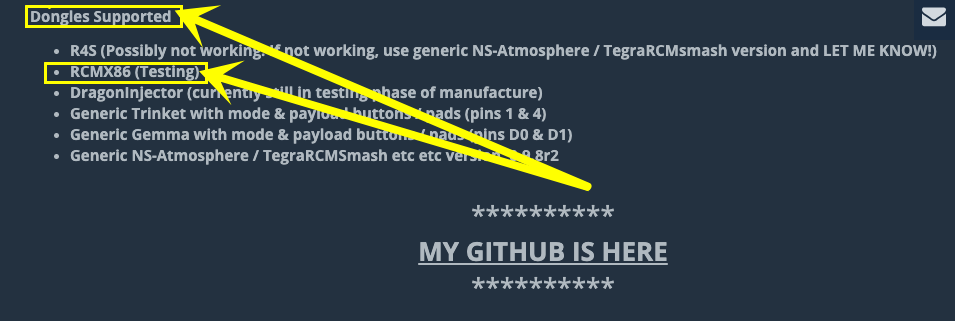

Hey, how's it going? I saw that you marked the X86RCM dongle as "in testing", do you have anyone that has flashed it successfully, or just nobody who has one has popped up to try it? I'm asking because I dug mine out last night and decided to see what was going on with your project and came across this new thread/software. It was like 4am and I was on the low-end of brain fuel, and was not successful. That may be just because I was doing something wrong though, I haven't had time to play with any Arduino stuff in a few months and am in no way an expert.
So my question is just, are you aware of anyone who has successfully flashed and used this on the X86RCM dongle? Thanks.

I don't have one, but it's just a atsamd21 based chip - you just need to connect Voltage + Ground and D+ D-. You could wire that straight to a usb cable if you don't already have it installed, just connect the reset pin 2 ground twice within 2 seconds and you'll boot into 'trinket mode', at this point it will show up as a com port and you can flash it with Arduino if you have the correct files on your computer.

Thanks. As I posted, it is a dongle not a bare board. In OP board is marked as "in testing" (I believe possibly due to the buttons pins being different, IIRC). I appreciate the reply though.

I've had no feedback one way or the other. I cant get hold those dongles either

It it's a dongle. V+, GND, D+ and D- are already connected - I'm not sure if your dongle has a reset pin fitted - but if you look at the type of chip on the dongle - it should say Atsamd21 on top of it - if so you just need to look at the pinouts and see if the reset pin is connected.
Easy way is to just plug the dongle into your pc and if a reset button is fitted - press twice within a second/2 seconds and it should show up as a drive.

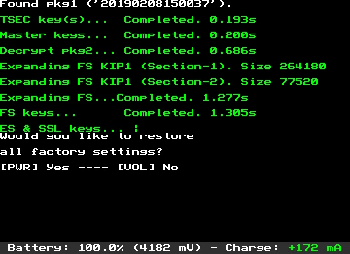

Maybe I am dumb(most likely I am) but since flashing v1.10 I am forced to select CFW 2 times now when launching. First selection tells me it found pkage1(xxxxxxxxxx) Sept needs to run please re-select this option on reboot. Reselect CFW when it reboots and atmosphere launches. However if I use hekate directly as a payload.bin I can launch CFW first time no issues. Any idea what might be causing that or is it by design in v1.1?
Sept needs to run to get the keys. What happens when you launch normal Hekate?
