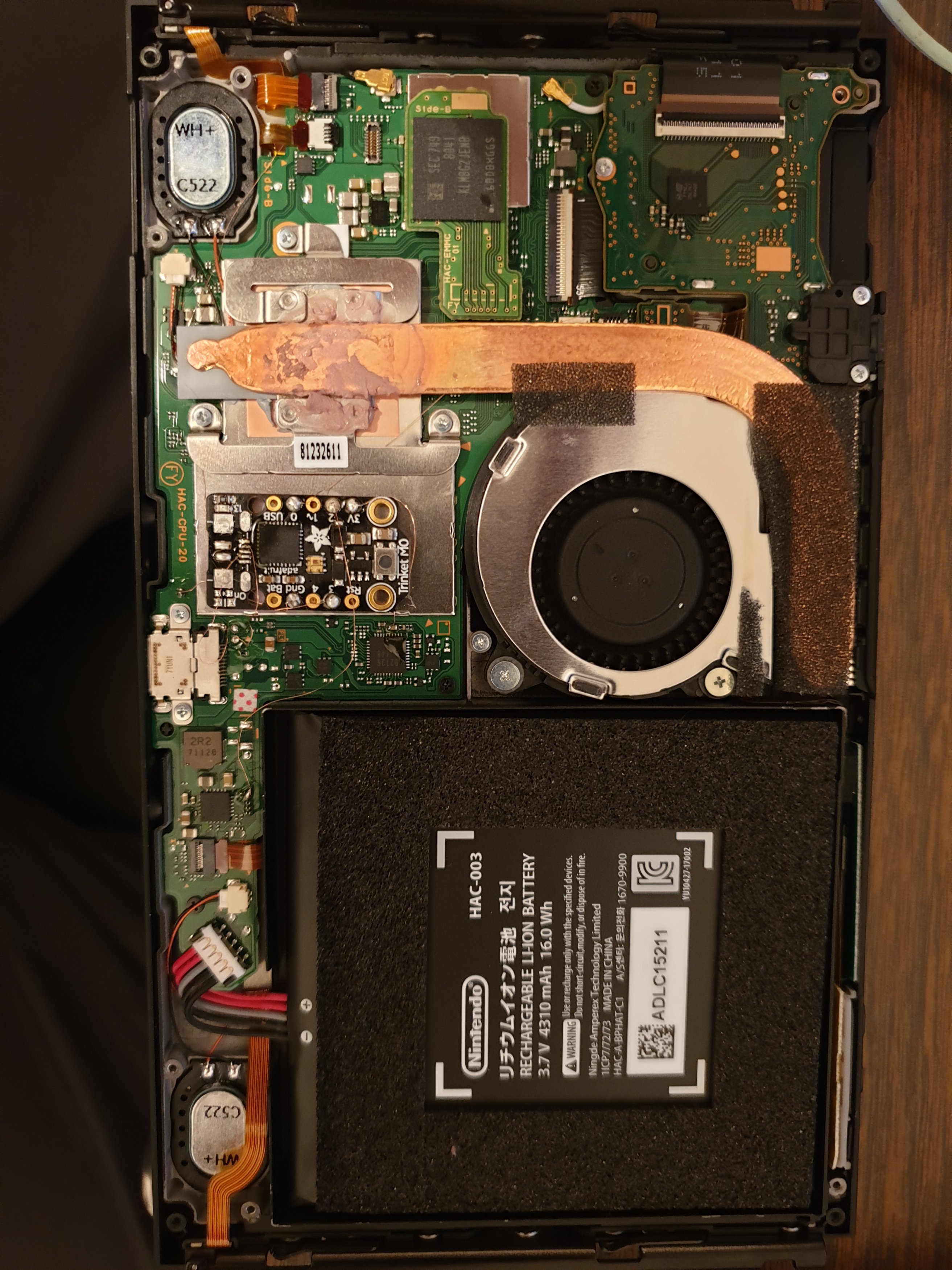

Someone please take a look at the attached pic and let me know if my wiring setup can cause problems (shorts). I was not the one that installed this chip and don't know what kind of wiring is needed, but I assume that these wires, being exposed and made of copper with no cover on them, will cause problems.
It wont cause problems.
It is enamel coated magnet wire. Used in motor windings.
Reactions: Adr990 and peteruk
I wouldn't be so sure, I modded my switch with enameled wire - I was getting issues with it not going to sleep and the volume going to low (as if I was pressing the v- switch) I eventually tracked the problem down to electromagnetic interference, where it was enough to get though the coating of the enameled wire and cause those problems. When I changed the wire for Kynar wire - those issues were gone.
I have had similar issues with magnet wire in the past. However, in my personal experience it wasn`t EMI.
If emi can get through lacquer, it can get through kynar.
Thats why we have co-axial cable (the braid acts like a prison - pegged to GND nothing gets in, nothing gets out. At least thats the idea anyway...
If it is fitted and undisturbed, it is fine. But the coating is rather easily damaged. Too much of a kink or bend and thats it. Its exposed. Not my first choice of material in this application!
