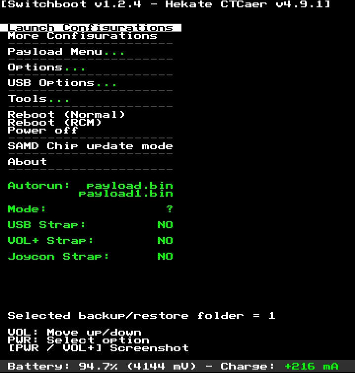

Couple of bits coming...
Don`t get too excited - relies on u-boot. Based on memloader.

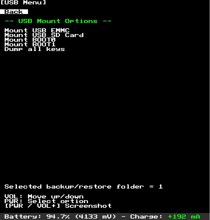

eplain the USB Options pls
Just mounts emmc etc for manipulation in hacdiskmount. For now.
Working on actually getting the drive to mount, using BIS keys, as a USB device.
Got the reading working fine, but struggling with the writing.
I`m just not good enough yet. But I`ll get there.
Maybe.
Reactions: peteruk and Gismor
Mount usb sd card - will that allow me to copy games (xci) directly from my pc to sd card, without sd card removal? I hope so :-)
