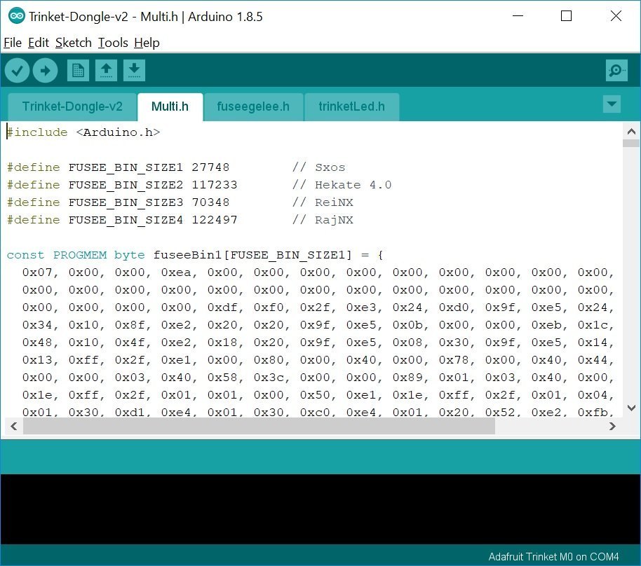

thanks to mattytrogs for the multi payload he posted in his thread I found a bit of time to have a mess about and edit it a small bit, replaced the payload.h with one with sx os,hekate and ReiNX.
red = sx os
white = hekate/atmosphere
blue = ReiNX
I did try to add rajnx but the flash on the trinket is to small, even without sx os the flash was to small.
I think I'll try find something with bigger flash to see if have any joy.
only thing extra I added was a button to pad1 in trinket going to gnd on my cell battery breakout board.
had another mess about with this dongle code, and added multi payload to it with bits from mattytrogs multi source so thanks to him for the idea and bits from his code which I used for this, and the 2 guys for the original 2 codes which I used, can't remember who they was now
have RajNX disabled untill i or someone finds a chip with bigger flash that'll work.
only one problem is the trinket flash is to small for all 4 payloads.
sxos/Hekate/ReiNX/RajNX
you get flash overflowed by 102732 bytes.
sxos/Hekate/RajNX
you get flash overflowed by 32332 bytes.
Hekate/ReiNX/RajNX
you get flash overflowed by 75084 bytes.
sxos/ReiNX/RajNX fits and works fine
sxos/Hekate/ReiNX fits and works fine.
sketch uses 234060 bytes (89%) of program storage space.
maximum is 262144 bytes.
so I'm hoping to try and find something with a bigger flash that will work and around the same dimensions as the trinket or smaller.

op updated and replaced all my old files with the new ones I use.
Updated Payload INO Files These Are Now All In One, So You Enable The Payload You WantTo Use, And Disable The 3 You Don't Want To Use.
the only UF2 d&d files are for the multi payload gemma/trinket
the itsybitsy UF2 File has not been tested as of yet as I don't have one to hand.
gemma/trinket and itsybitsy files are for dongle only at moment as.
pad A0 = payload change on gemma and itsybitsy.
pad 1 = payload change on the trinket.
the multi can only have 3 payloads enabled due to flash on the trinket/gemma & itsybitsy flash not being big enough.
red = sxos
white = hekate
blue = ReiNX

sure here you go uf2 drag and drop files and should work on the r4 dongle also from that info you posted.
hekate 4.0 only

this will do me multi4 payload for trinket dongle, untill I get something with a bigger flash.
