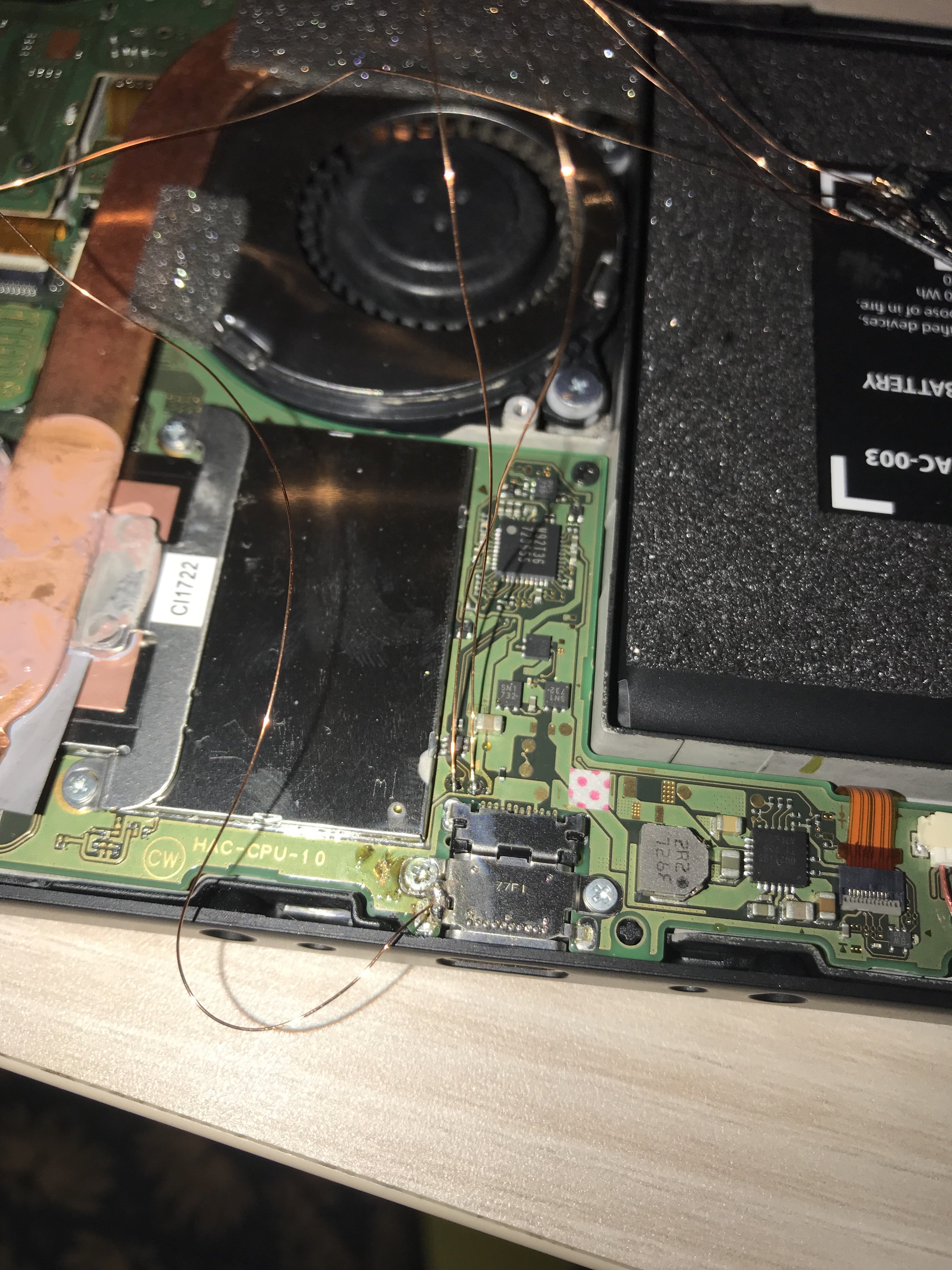

Hi M-O-B, I finally could change the diode and reinstalled the 4.7uf cap. Now I have 5V in the USB side and 4V in the switch side.
However, it still doesn't charge and it keeps stuck in the switch logo while booting.
I also received the M92T36 chip and replaced it, but still no charge and no boot.
I changed the thermal silver paste and I'm trying without th SD to boot to OFW.
Would you know what else to check?
Would you know what else to check?[/QUOTE]
post hi res clear images of all the points you have solder to, page 19 has a post made by me from when I had received a badly damaged switch to repair.
that wouldn't charge or work via the dock. but charged using external usb lead.
first thing I did was replace the missing cap, then the switch started to work and charge via the dock.
go back to basics what I mean is remove the trinket or whatever it was you installed.
it is pointless anyone trying to sort something out with any glitcher installed. that's all a trinket really is similar sort of thing to the old 360 install lol.

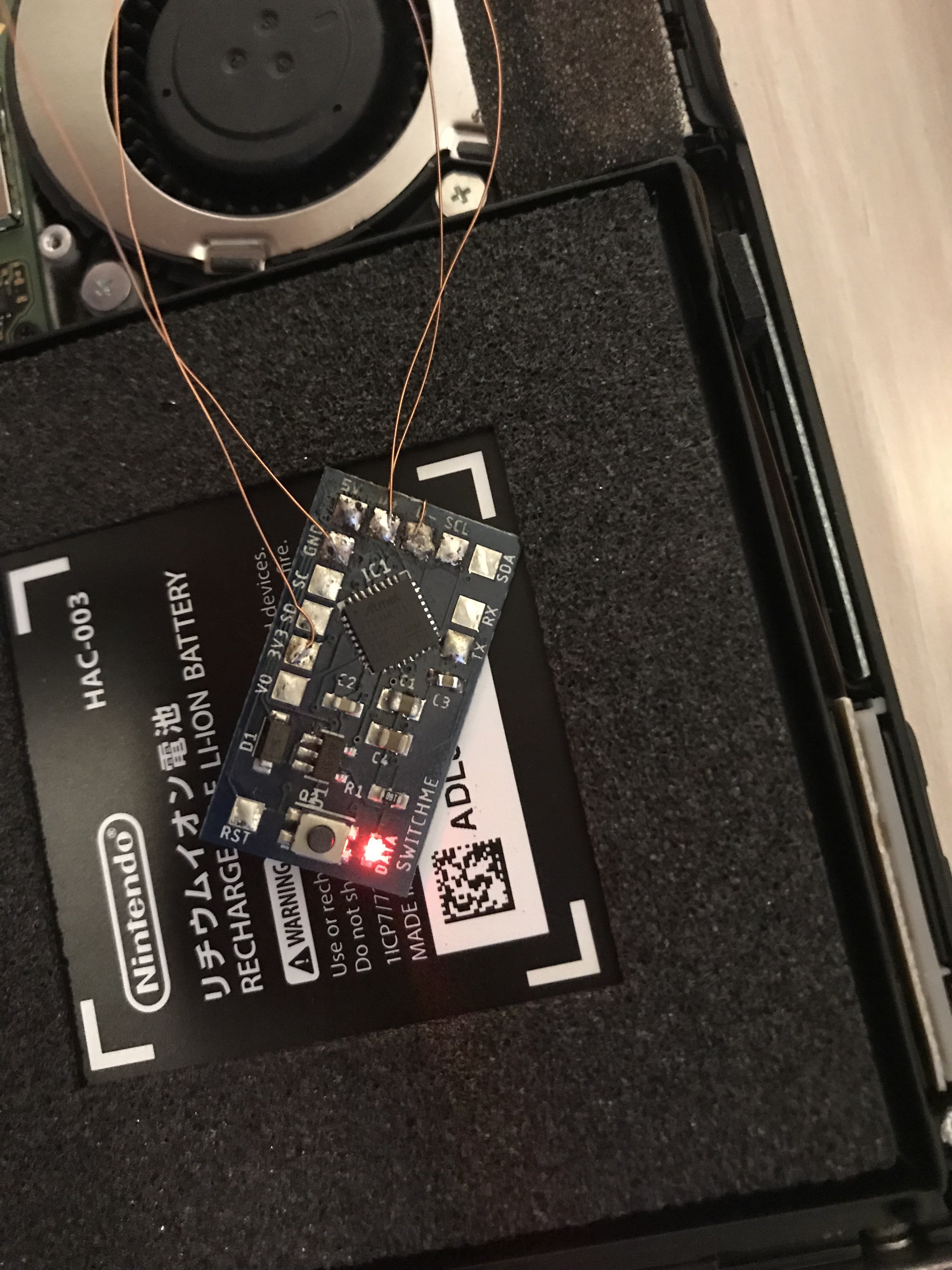

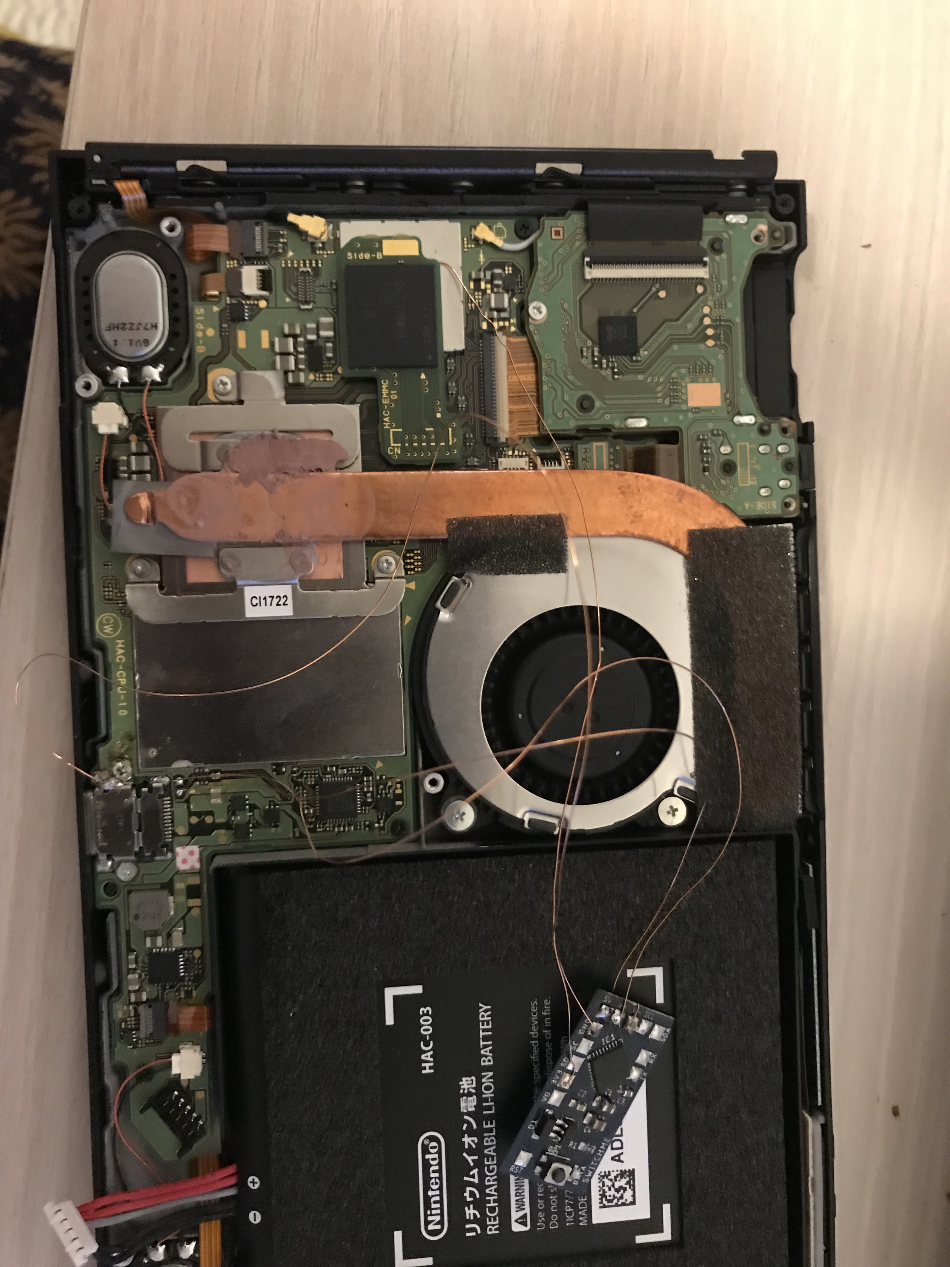

Good evening
I have problem to flash the switchme, I connected the board as mentioned, but when I put the usb cable and press the 2 times nothing happen the board don't connect to the bootloader mode
I even try to preflash it by connecting 5V GND D+ D - directly to the card but nothing.
I checked every thing (solder point with meltimeter, change 2 usb cable, changed 2 pc with 2 different windows version) it never connect, only red light
did i miss somthing?

Good evening
  1. View attachment 145635 View attachment 145636 View attachment 145637
I'd remove all wires and solder them again, but 1 by one to each point, so you don't get the data wires mixed up.
also make sure you have the drivers installed on your pc for the switchMe, not sure if it uses the same drivers as the trinket as never bothered with that chip.
this should give you idea of the install of the drivers.
https://gbatemp.net/threads/how-to-flash-the-trinket-m0-using-arduino.508886/
Good evening
The bootloader might need flashing / reflashing
Reactions: FARES
