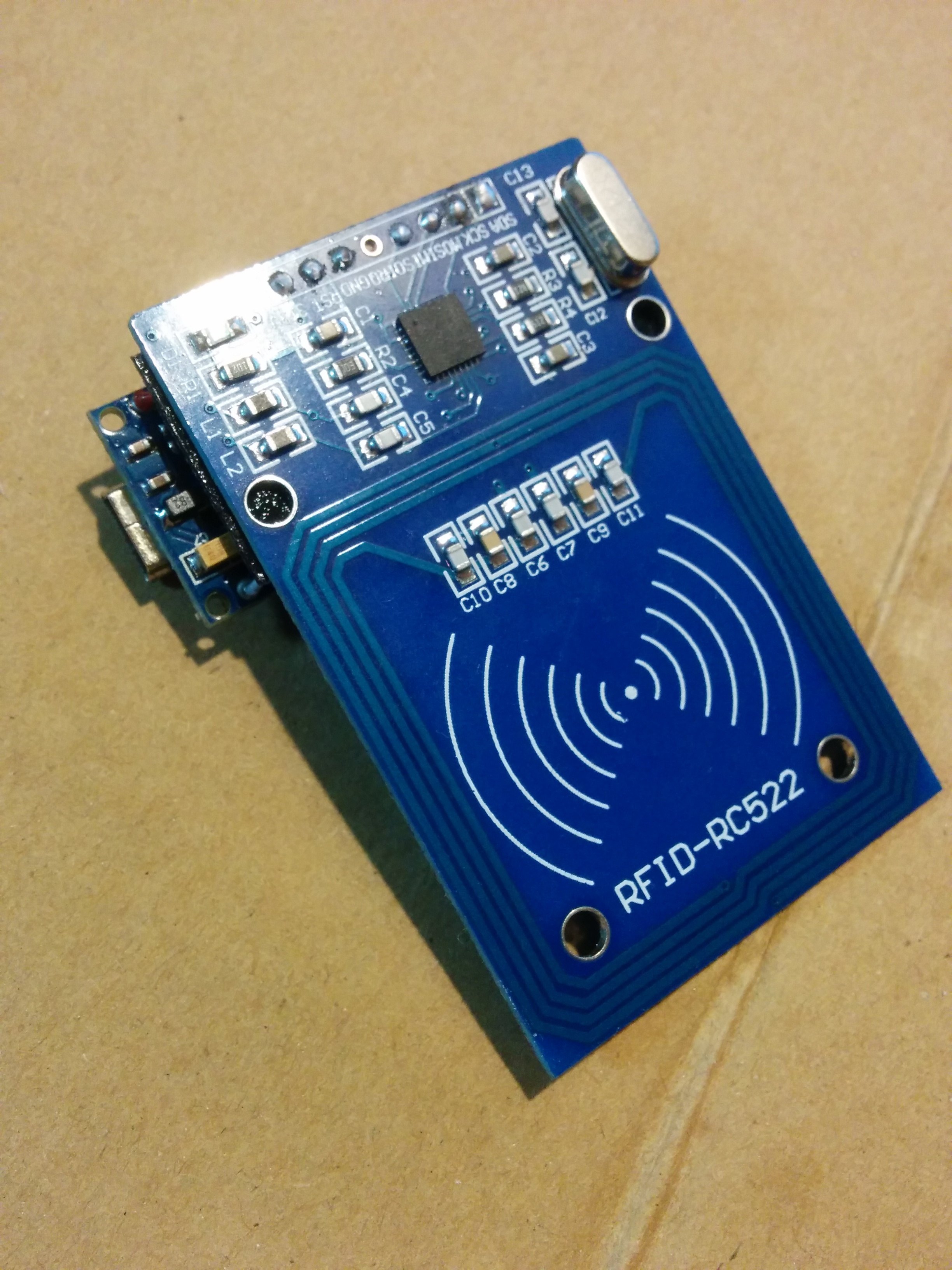

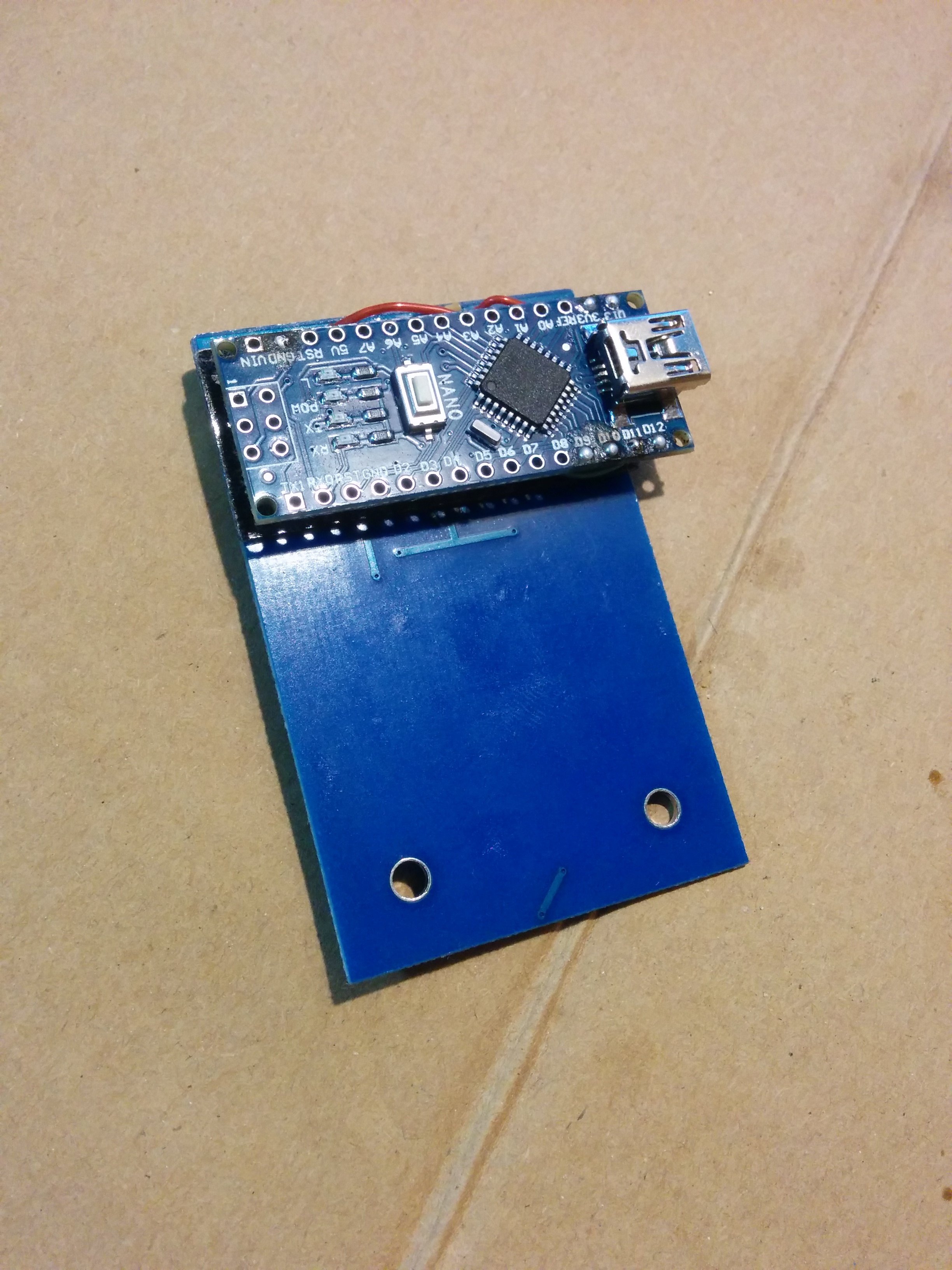

Not the best soldering job, but it'll work I think! :)
nice and compact :P
