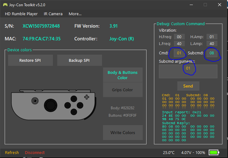

try this:
https://github.com/dekuNukem/Ninten...#subcommand-0x08-set-shipment-low-power-state
Subcommand 0x08: Set shipment low power state​
Takes as argument x00 or x01.
If x01 it writes x01 @x5000 of SPI flash. With x00, it resets to xFF @x5000.
If x01 is set, the feature Triggered Broadcom Fast Connect scans when in suspened or disconnected state is disabled. Additionally, it sets the low power mode, when disconnected, to HID OFF.
This is useful when the controllers ship, because the controller cannot wake up from button presses. It does not disable all buttons when it has pairing data, only the easy pressable. A long press from the others can wake up the controller, if it has pairing data.
Switch always sends x08 00 subcmd after every connection, and thus enabling Triggered Broadcom Fast Connect and LPM mode to SLEEP.
So I think the cmd 01 could be sent here with sub-command of 08 and a sub-command argument of 0x01?
Not 100% certain what I’m doing here but these docs mention that cmd 01 is rumble and sub-command
https://github.com/dekuNukem/Nintendo_Switch_Reverse_Engineering/blob/master/bluetooth_hid_notes.md
Combine that with the vibration section in the above graphic and I’m either on to something or I’m just retarded.
Might just have to try it later tonight…

That worked. I'm sitting here with a completely shut down joycon...I'm mashing the buttons and absolutely nothing. It's as if it is brand new. I circled in blue below what I sent to the joycon. the joycon will flash one green light and the blue home light repeatedly until you go into control panel in windows and disconnect the joycon and then it completely turns off and buttons don't wake it up. To wake it back up you press and hold the sync button hidden in the middle of the joycon rail and then slide it in. Good as new...

Tested just for fun and damn I got a completely dead joy-con until resurrected by sync button, was funny!

Just watched the youtube video from @sthetix and used subcmd's x07 00 and x08 01 in order to get all my unused joy-cons into low-power deepsleep mode. That worked really awesome, Many thanks to @CTCaer @binkinator and sthetix :)
