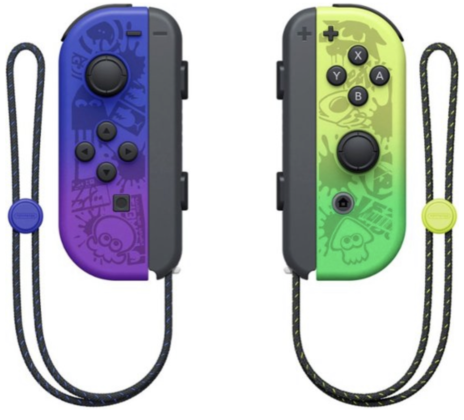

Does anyone know the hex codes for the Splatoon 3 Joycons?
Splatoon 3 joycons are multicolor so it’s going to be hard for one of us to select your favorite hue.

I guess they meant what colour code the official Sploon joy-cons provide to the Switch
Splatoon 3 OLED Edition Blue-Gradient Left Joy-Con / スプラトゥーン32022.08.26#6455F5#28282D
Splatoon 3 OLED Edition Neon-Yellow-Gradient Right Joy-Con / スプラトゥーン32022.08.26#C3FA05#1E1E28
...these are the hex-codes directly from my own personal setDateBodyButton

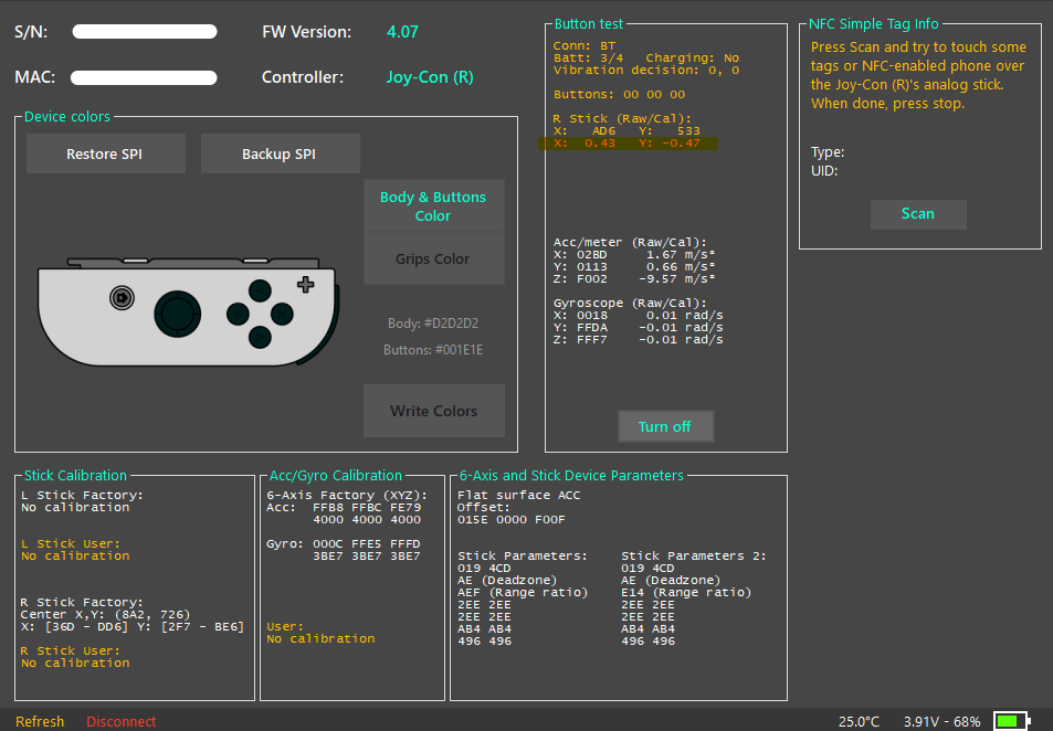

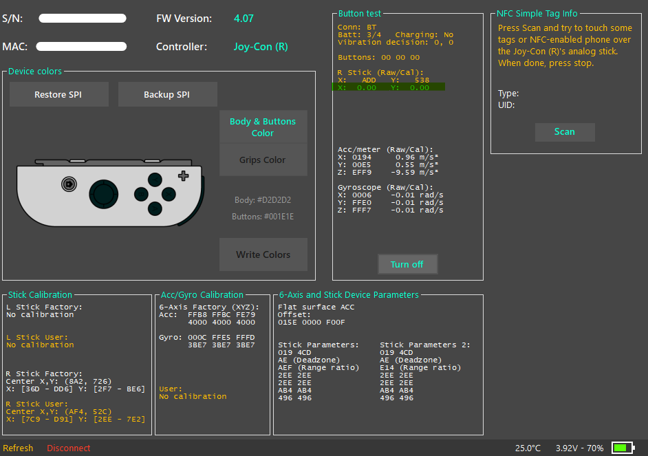

Hi, tobygg! Can you give some instructions on how you actually wrote your user values as factory values?
I have installed new Anbernic's hall sensor joysticks (they are drop-in replacement joysticks btw) on my V1 Switch, but they need to be calibrated. My user calibration seems to do no difference and has no effect.
From the screenshot no.1 while in playground testing mode you can see that without any calibration the hall sensor joystick is off-centered to the SSE. After calibration, as seen from screenshot no.2, joysticks are perfectly calibrated.
Do any of you, guys, have the same problem where user calibration is being ignored by Switch? Does any of you have guidelines or suggestions how can I make it work, as it seems that I am the first one to experiment with hall sensor joysticks on Switch? Thx
